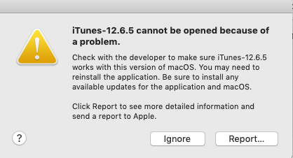

Does anyone know if there will be the Enterprise iTunes with App Store released? iTunes 12.6.3 and 12.6.5 do not install.
Went to install and was greeted with the message below. This can't be the end of the app store for good?!?!

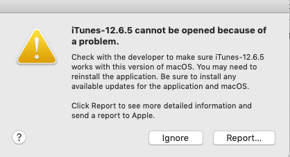

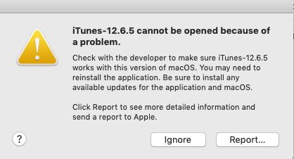

Hey good for you! I could not get it to work even when I had 12.6.5.3 moved into the Applications folder of Mojave 10.14 Build (18A389)
see attached pop up warning
Looks like you missed a step. I followed the directions in the reddit link and I had the 12.6.5.3 app on my desktop...I could run it no problem. Verify SIP is disabled. Verify that you copied "iPodUpdater.framework” from the 12.6.4 iTunes framework folder to the Mojave framework folder.
