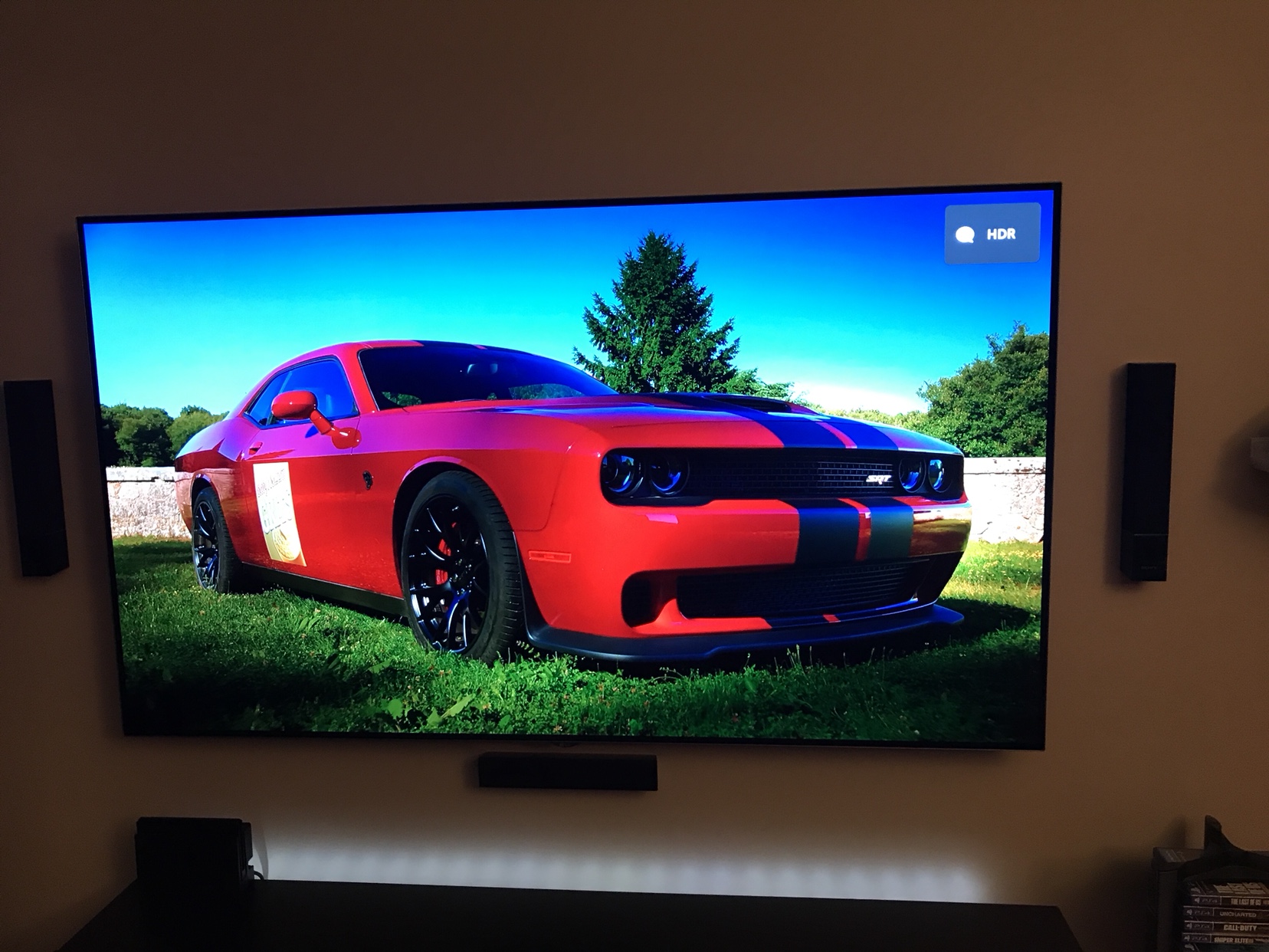

Well on my tv they are 2 different settings, if i play a DV movie or tv show on Netflix, as soon as press play i get a icon pop up saying DV, if i use amazon prime and play a HDR show or movie i will get HDR icon pop up.
This is using Netflix built in app on my smart tv
This is using Amzon prime videos built in app on smart tv
No I understand, I was just saying my TV doesn’t support Dolby Vision, I was just wondering why the Netflix description page would display DV when I don’t have it, like on my XBox One s I don’t have an DV label on the shows description page, it shows HDR, Ultra 4K or HD.
