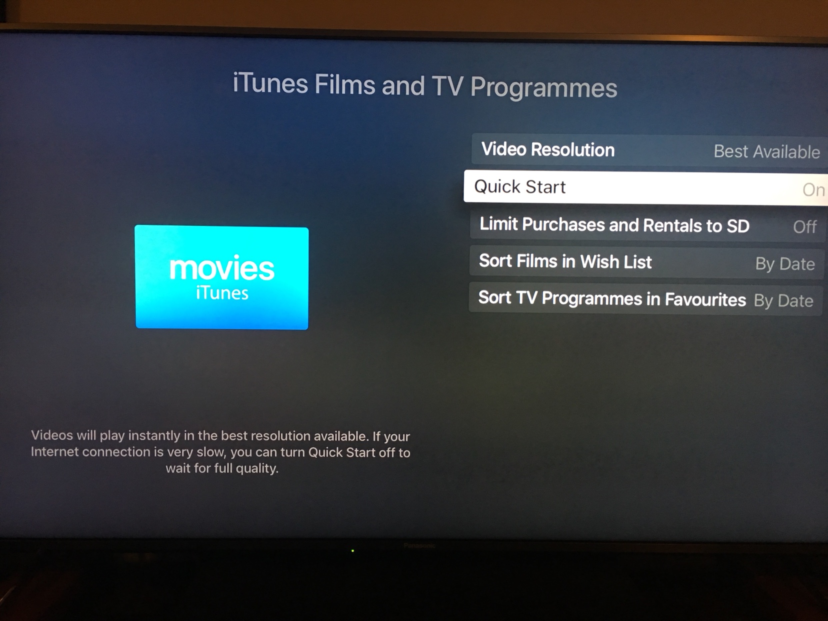

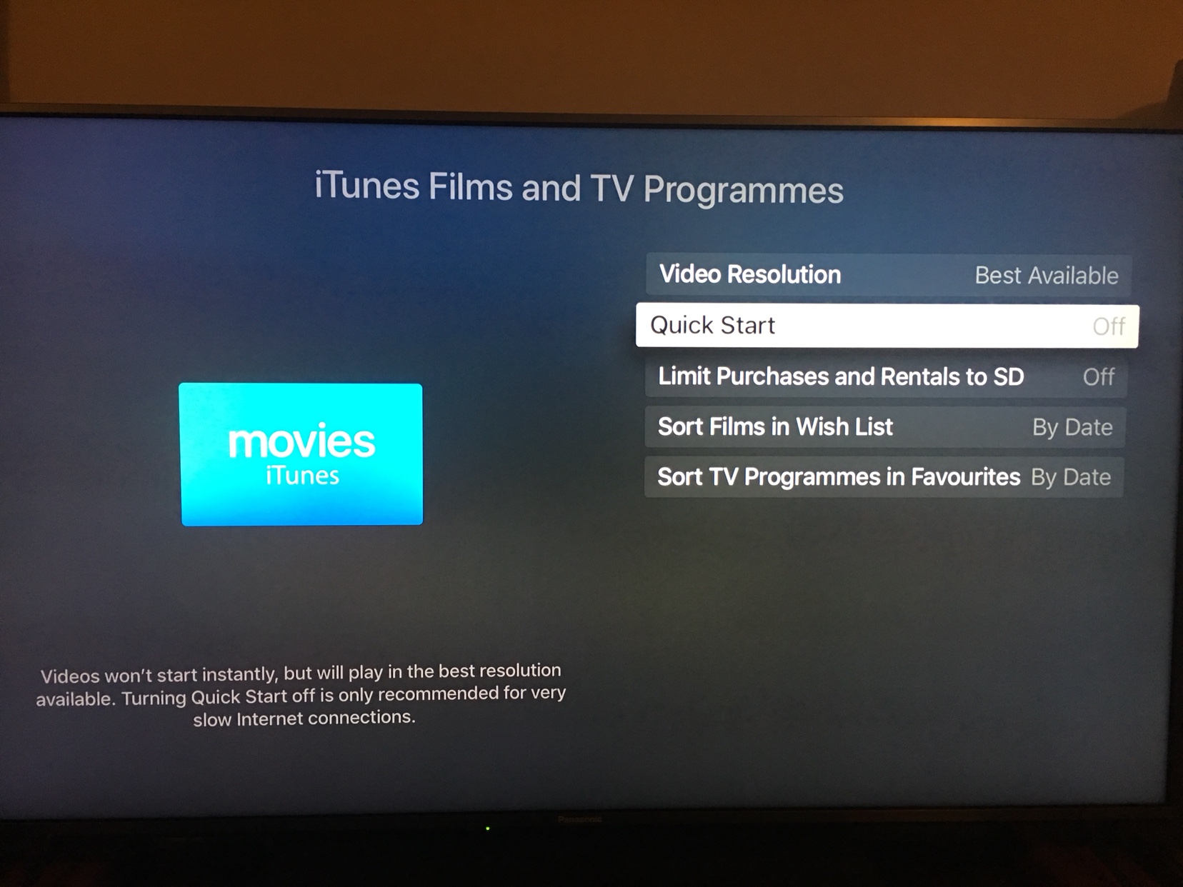

It only buffers with Quick Start off.
With Quick Start on it plays instantly with no buffering in the best quality your line can handle.
It does kinda tell you this on screen when you select either option.
With it turned off however then currently it won’t play back in 4K.
