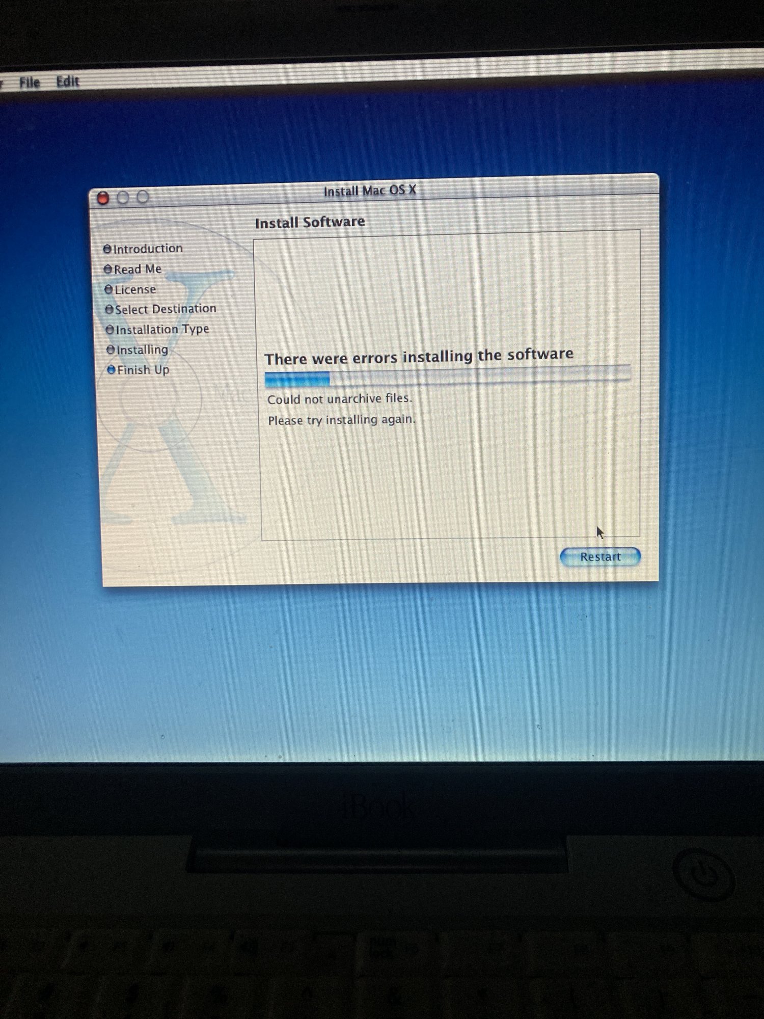

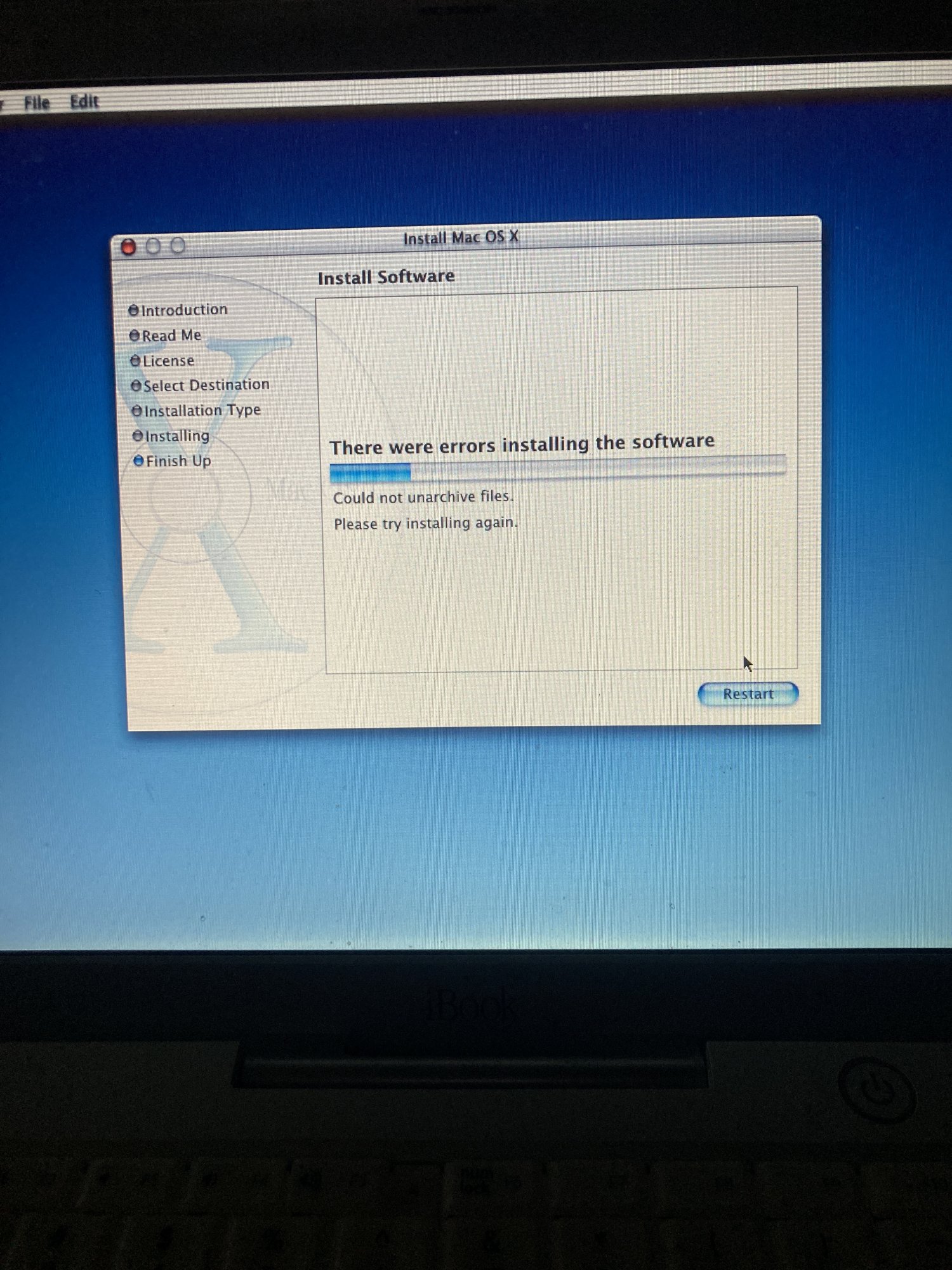

They both got about 5 minutes in and failed with an error that said something along the lines of “couldn’t unarchive packages”. I’m was going to try again with the newer 10.0.3 and 10.1.3 CDs.
Edit:
Didn’t work. I used a different Mac as well as the 10.0.3 installer and it still fails in the same place.
