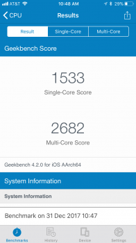

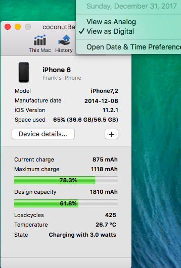

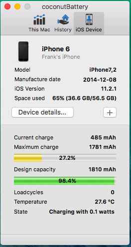

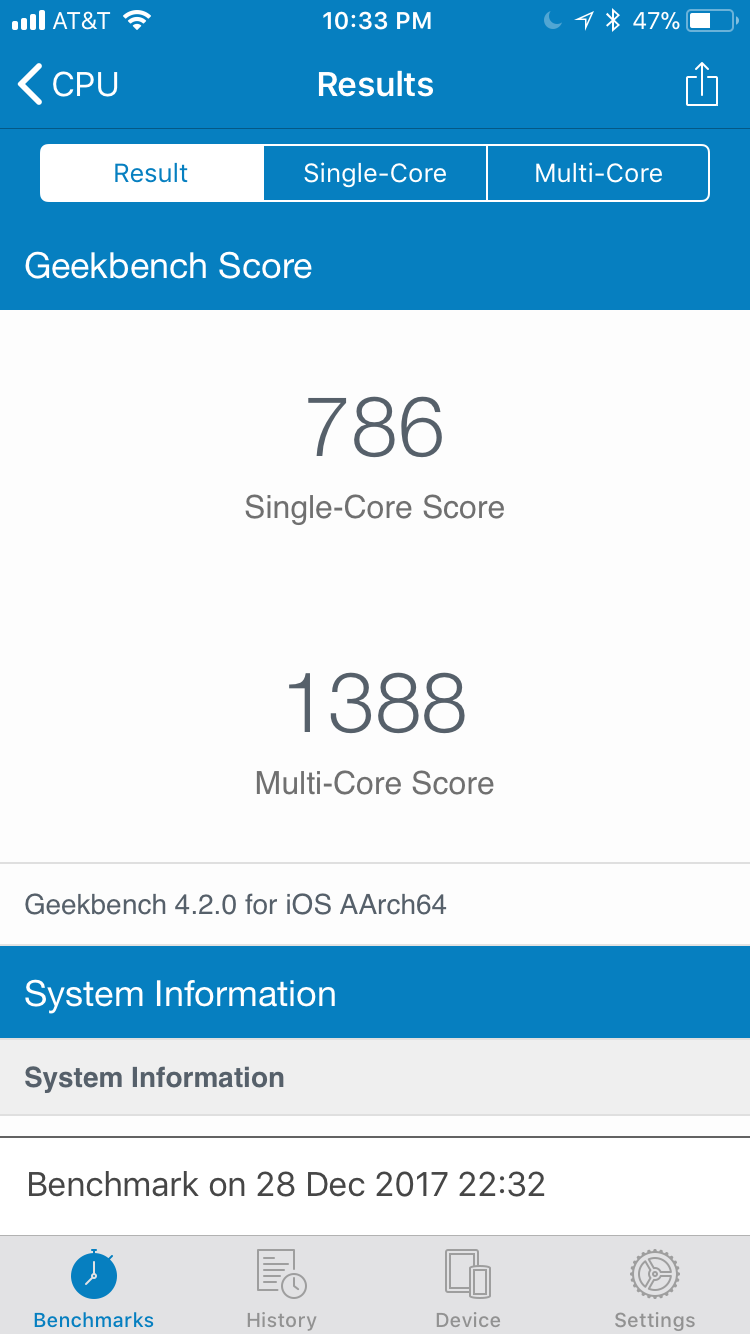

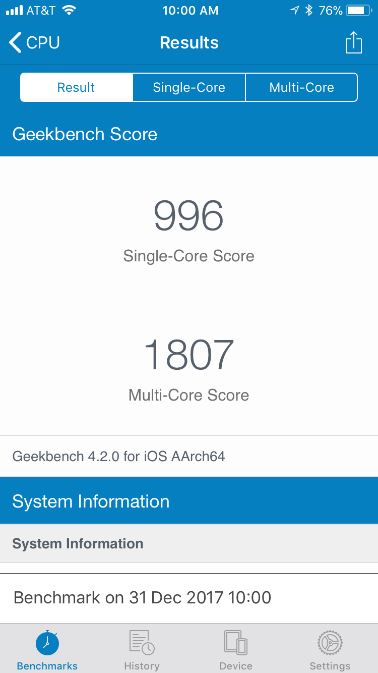

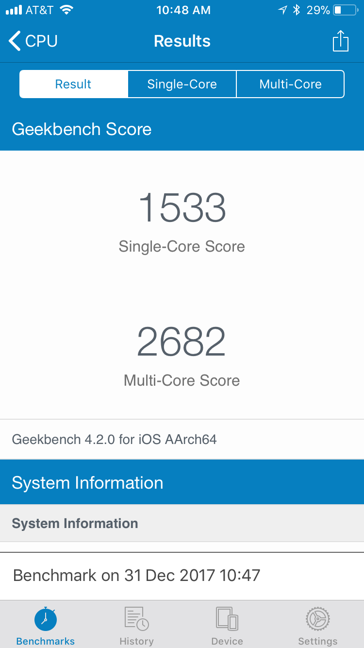

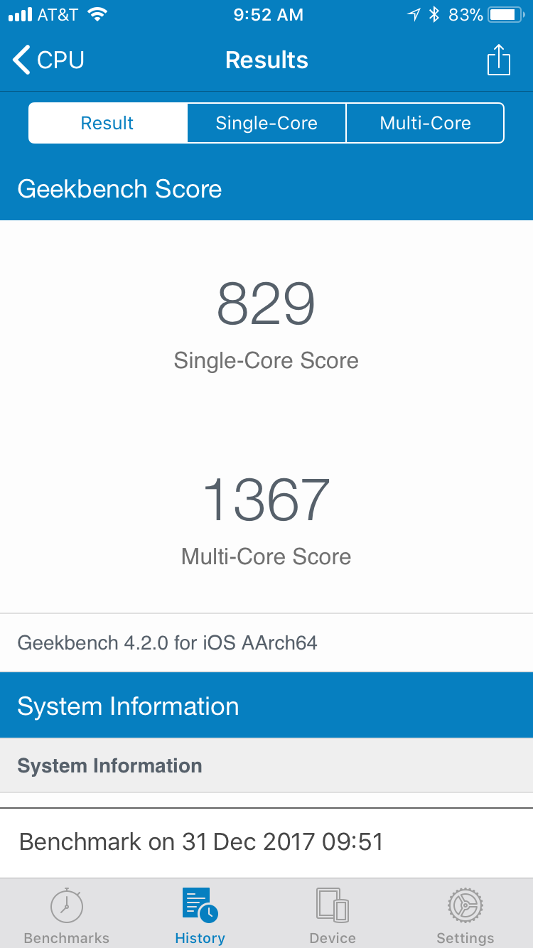

Like many other iPhone 6 owners, I have been struggling with the phone since updating to iOS11. Anyways, I just changed my battery and I have some before and after benchmarks for comparison.
Original Battery (62% health)
New Battery (98% Health - although I expect this to go up after the first couple of charges)
Geekbench4 Results Before
Geekbench4 Results After
As you can see, the battery makes a huge difference on benchmarks. Feel wise, the difference is even more pronounced. Apps that used to take 5 seconds to load take only 1 or 2 seconds. The camera app is faster. Screenshots are faster. It's totally worth swapping the battery for. I can probably go one more year before upgrading to the iPhoneX S2.
I will say that iOS10 is still much faster than my newly renovated iOS11 device. I accept that the 1GB of RAM is limiting and that I should expect some slowdown. But I needed wOS4, so I had to update. The battery swap at least makes the iOS11 experience bearable.

I didn't take it to Apple. I had ordered a 3rd party battery two days before Apple announced the $30 replacements. I was gonna wait for next week to have Apple do it, but I got impatient, so I did it myself.
It took me 30 minutes to do it. If I were a little younger and had better eyes, it would have taken 15.
I've gotten batteries replaced at the Apple Store before. They take forever. At least an hour, sometimes more. It's a busy store (Suburban Square Apple Store - Ardmore, PA), so I suspect they have lots of repairs going on.
