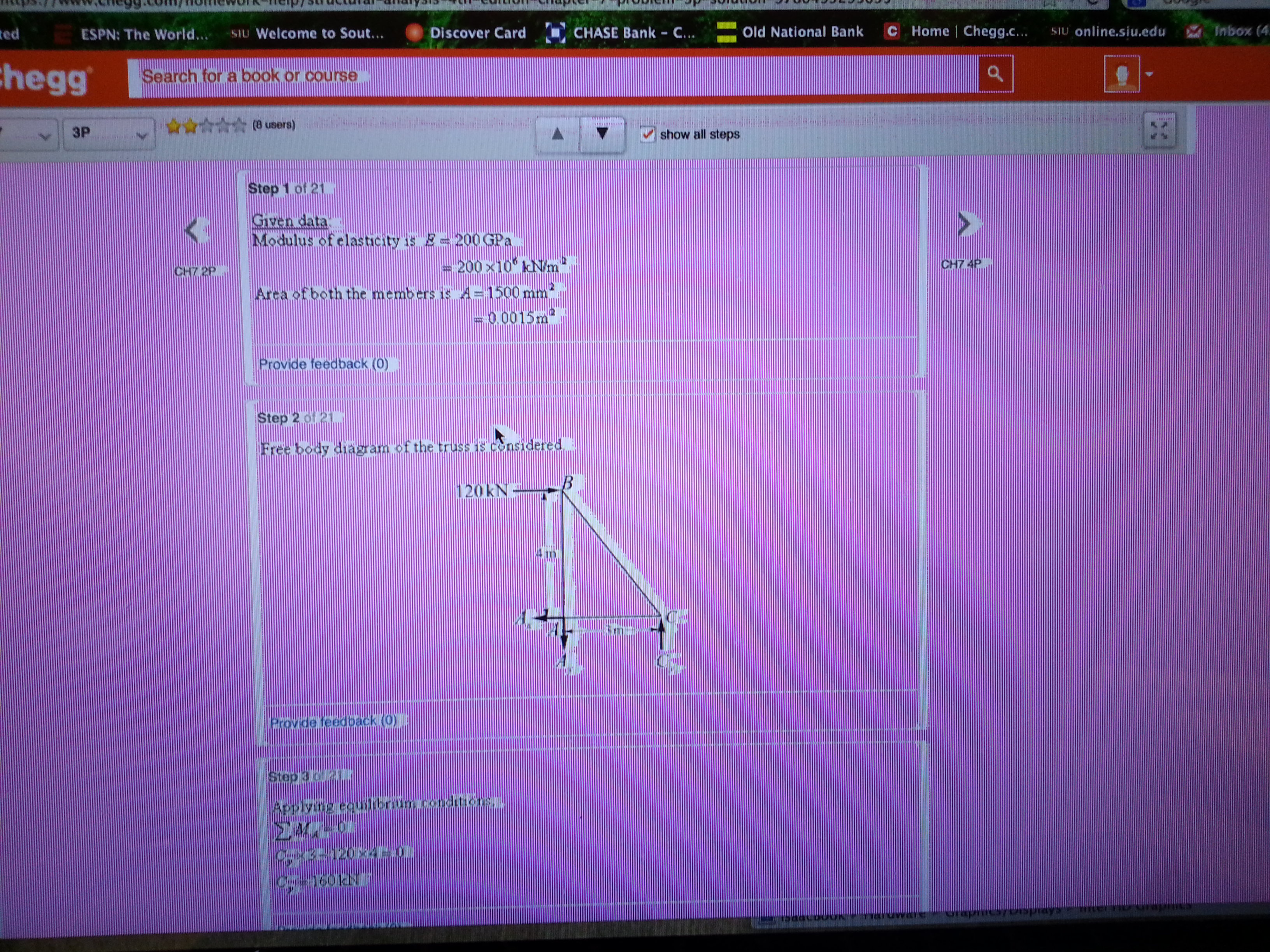

20131208_162922.jpgHey guys i just dropped my Mid 2010 Macbook pro 15-inch 2.53GHz Intel Core i5 and all the white color or at least most of it is purple. I was wondering if someone could help me out and maybe figure out what it is i would really appreciate it. And also how much the cost would be.

Thanks for your response. It slid off my bed which isnt that high so it may be that connectivity issue. As for the purple/pink lines, the run up and down the whole screen wherever there is white, so like the side of browser has the purple/pink steaks. It had like a 2 foot fall so i didnt think it was that bad. If its a new screen and i replace it myself how much would that run me?

Did it impact on the floor right speaker side or left?
Is there supposed to be something wrong with the picture that you attached?
I don't see any strange colors (other than a Firefox theme that I would not use)
If that's a screen shot, then that wouldn't show hardware problems.
You have to actually take a picture of the screen with a camera, and then attach the photo file.
