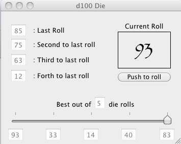

Tonight I really got into the Cocoa learning and it did not seem that hard. I got my random d100 dice roller working (I play RoleMaster with friends 🙂) where it keeps track of the last 4 roles. I also added a slider which I could set from values 1 to 5 to pick the highest roll out of X numbers of rolls.
I created 1 class and all the code from my IBOutlet and IBActions went in to. I wrote no code from main except what it came with when the program launched.
Here is what I am wondering:
Should I be writing more of this code in main.m and sending messages to different object methods, or is writing everything in 1 class normal? Pascal class was teaching me to send things out of main into Functions to process and keep my main part clean and easier to read.
Here is my class implementation

It seems a bit cluttered and I was just wondering, how to clean it. Jim showed me a nice wargame code clean up. I am just wondering what I could do to make this look nicer, even though it functions.
Thanks for any guidance.

Chown33- Thanks for showing me some short cuts and explaining dice/card classes and where things should go. I might spend my Friday night and expand that program a little by adding in an Experiences Point Calculator. Which sould be it's own class then. So main calls an NSwindow. I create a AppControler Class. Then I create sub classes for Dice and XP Calculator.
balamw - My Pascal teacher could not stress enough about top-down designs. I could never get that concept of approaching a project that way. Pseudo code like you are talking about is what I seemed to do for those projects. Kind of outline what needs to happen. Thanks for the advice.
PatrickCocoa - I wrote a little program for the arc4Random() using a 100 sided dice. It rolled the d100 1000 times and then it incremented a 100place index int array. Then with another for loop within a for loop I had it print a '*' for each time it rolled it so if number 35 was rolled 5 times I got "*****" starts. The result looked pretty random and I printed the result bellow. A visual representation was easier to see then a bunch of numbers.
Code:

I thought I could just take the app that was made in when I pressed BUILD and send it to a friend to open and check out. It did not work. Researching on line almost everything I could find was iPhone and for Xcode3 and all the steps to make a release version, holy cow.
If anyone has any links for Xcode4 and a non ios (Mac OX 10.4 or better) please let me know.
