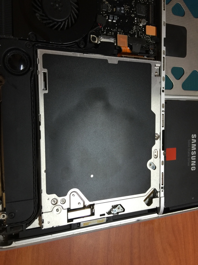

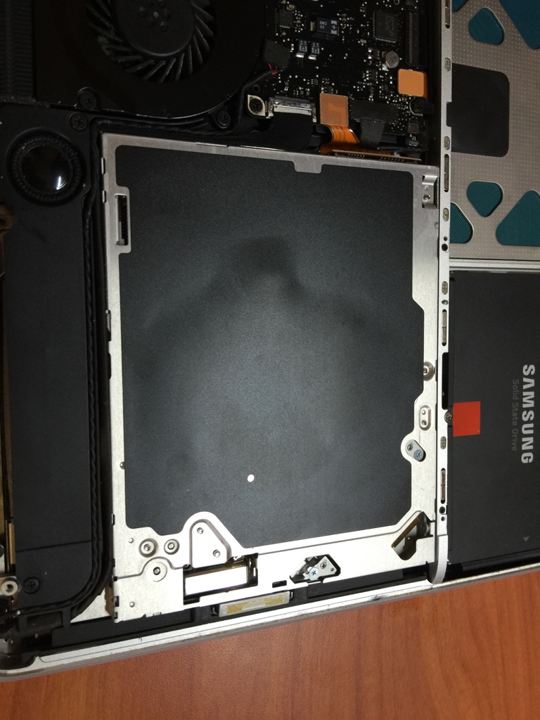

Pictured below is the part that's incredibly hot. It's not dusty at all. I pulled the ram and will reseat it. ImageUploadedByTapatalk1416767289.039257.jpg
That's the DVD drive. Probably coincidental that it's hot because it's a big flat piece of metal. You can unplug that from the board easily.

Pictured below is the part that's incredibly hot. It's not dusty at all. I pulled the ram and will reseat it. View attachment 515676
