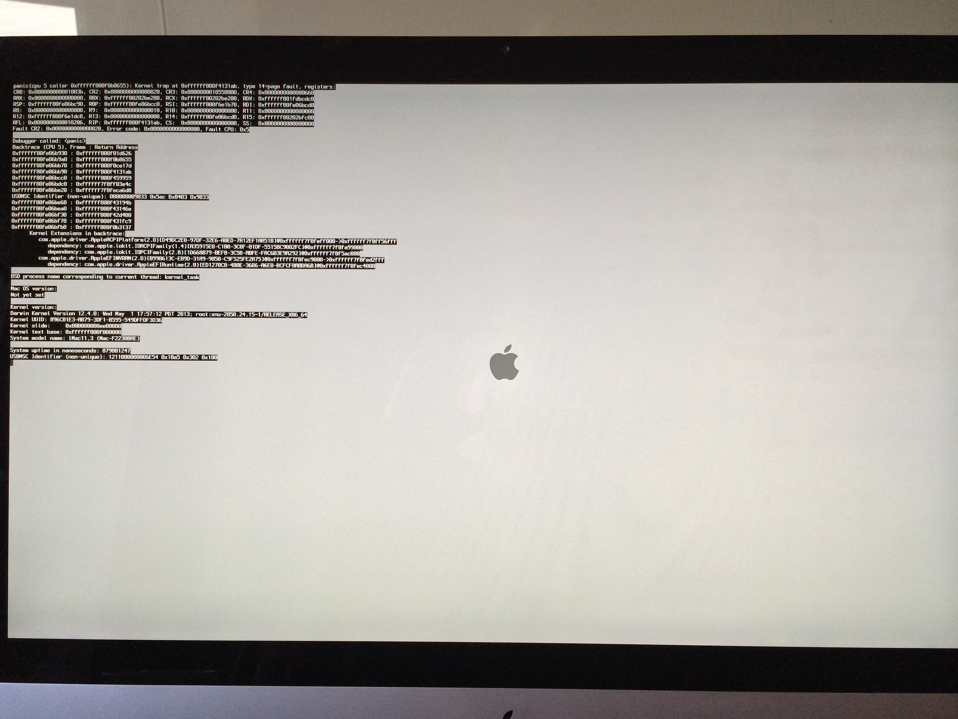

Hi Folks,
Recently installed an SSD into my 2010 iMac and wanted to see how well the system would run the Golden Master of Mavericks.
Created a bootable USB and completed installation to the SSD using the instructions at http://osxdaily.com/2013/06/12/make-boot-os-x-mavericks-usb-install-drive/
However the machine won't boot to Mavericks and Kernel Panics every time. I am able to boot back into Mountain Lion from the the existing install on my other installed Hard Disk but wondering if anyone has any suggestions on what might be causing this or how to fix.
Much appreciated!
Screenshot attached.

Well, the backtrace message clearly says that it's a driver/IOKit problem. I don't have any experience with this but why don't you do an Apple Hardware Test and report back? Might help..

Going by the image posted in the first post, it appears to be the one of your PCI-e cards. What kind of PCI-e cards do you have installed?

Please help me...
Look in System/Library/Extensions/
Mmmm, cannot find that damn file!
I have looked into the extension folder, with hidden files visible but unless I am blind it is not there:-(
This is what I see:
NMLGEDriver_106.kext
NMSamsungDriver_106.kext
NMSmartplugSCSIDevice_106.kext
NovatelWireless3G.kext
NovatelWirelessFilter.kext
NovatelWirelessUSBCDCECMControl.kext
NovatelWirelessUSBCDCECMData.kext
Those.
OK, I have removed those 7 recommended .kext files....
(NMLGEDriver_106.kext
NovatelWirelessUSBCDCECMData.kext)
.......However using EasyFind and searching also for invisibile files, I could not find any file called: de.novamedia.driver.NMSmartplugSCSIDevice 1.0.1
In fact this file: de.novamedia.driver.NMSmartplugSCSIDevice 1.0.1 does NOT appear in the list of kext files I have show before.
So is this file still present or not?
I am confused:-(
Andrea
Again kernel crash after removing previous 7 .kext files.
Very sad! :-🙂confused:🙁
Any clue?
Anonymous UUID: 0FCBB5E5-E206-D9EA-4FBC-184C27CE9F7E
Sun Nov 3 10:34:08 2013
panic(cpu 1 caller 0xffffff802acdc19e): Kernel trap at 0xffffff802ab0e11b, type 14=page fault, registers:
CR0: 0x000000008001003b, CR2: 0xffffff802afd1404, CR3: 0x000000002d1a5000, CR4: 0x00000000001606e0
RAX: 0x0000000000000000, RBX: 0xffffff804b856f00, RCX: 0x00000001f6d17ec0, RDX: 0x0000000ffffff810
RSP: 0xffffff81fb68be98, RBP: 0xffffff81fb68bf90, RSI: 0x0000000fb68bf600, RDI: 0xffffff802afd1404
R8: 0x0000000000000000, R9: 0xffffff802b2531a0, R10: 0xffffff802b2d15f0, R11: 0x0000000000000016
R12: 0x0000000000000000, R13: 0x000000000e8ad9c8, R14: 0xffffff81fb68bf38, R15: 0xffffff804b854008
RFL: 0x0000000000010206, RIP: 0xffffff802ab0e11b, CS: 0x0000000000000008, SS: 0x0000000000000000
Fault CR2: 0xffffff802afd1404, Error code: 0x0000000000000003, Fault CPU: 0x1
Backtrace (CPU 1), Frame : Return Address
0xffffff81fb68bb20 : 0xffffff802ac22f69
0xffffff81fb68bba0 : 0xffffff802acdc19e
0xffffff81fb68bd70 : 0xffffff802acf3606
0xffffff81fb68bd90 : 0xffffff802ab0e11b
0xffffff81fb68bf90 : 0xffffff802af75f28
0xffffff81fb68bfb0 : 0xffffff802acd6aa7
BSD process name corresponding to current thread: kernel_task
Mac OS version:
13A598
Kernel version:
Darwin Kernel Version 13.0.0: Thu Sep 19 22:22:27 PDT 2013; root:xnu-2422.1.72~6/RELEASE_X86_64
Kernel UUID: 1D9369E3-D0A5-31B6-8D16-BFFBBB390393
Kernel slide: 0x000000002aa00000
Kernel text base: 0xffffff802ac00000
System model name: MacBookPro9,2 (Mac-6F01561E16C75D06)
System uptime in nanoseconds: 2389692382
last loaded kext at 1653529643: com.apple.driver.AppleUSBTCButtons 240.2 (addr 0xffffff7fac33b000, size 20480)
loaded kexts:
com.rim.driver.BlackBerryUSBDriverInt 0.0.74
com.apple.driver.AppleUSBTCKeyEventDriver 240.2
com.apple.driver.AppleUSBTCKeyboard 240.2
com.apple.driver.AppleIRController 325.7
com.apple.driver.AppleFileSystemDriver 3.0.1
com.apple.AppleFSCompression.AppleFSCompressionTypeDataless 1.0.0d1
com.apple.AppleFSCompression.AppleFSCompressionTypeZlib 1.0.0d1
com.apple.BootCache 35
com.apple.iokit.SCSITaskUserClient 3.6.0
com.apple.driver.XsanFilter 404
com.apple.iokit.IOAHCIBlockStorage 2.4.0
com.apple.driver.AppleUSBHub 650.4.4
com.apple.driver.AppleSDXC 1.4.0
com.apple.iokit.AppleBCM5701Ethernet 3.6.9b9
com.apple.driver.AirPort.Brcm4331 700.20.22
com.apple.driver.AppleAHCIPort 2.9.5
com.apple.driver.AppleFWOHCI 4.9.9
com.apple.driver.AppleUSBEHCI 650.4.1
com.apple.driver.AppleUSBXHCI 650.4.3
com.apple.driver.AppleSmartBatteryManager 161.0.0
com.apple.driver.AppleRTC 2.0
com.apple.driver.AppleACPIButtons 2.0
com.apple.driver.AppleHPET 1.8
com.apple.driver.AppleSMBIOS 2.0
com.apple.driver.AppleACPIEC 2.0
com.apple.driver.AppleAPIC 1.7
com.apple.driver.AppleIntelCPUPowerManagementClient 216.0.0
com.apple.nke.applicationfirewall 153
com.apple.security.quarantine 3
com.apple.driver.AppleIntelCPUPowerManagement 216.0.0
com.apple.driver.AppleUSBMultitouch 240.6
com.apple.driver.AppleThunderboltDPInAdapter 2.5.0
com.apple.driver.AppleThunderboltDPAdapterFamily 2.5.0
com.apple.driver.AppleThunderboltPCIDownAdapter 1.4.0
com.apple.iokit.IOUSBHIDDriver 650.4.4
com.apple.driver.AppleUSBMergeNub 650.4.0
com.apple.iokit.IOSCSIMultimediaCommandsDevice 3.6.0
com.apple.iokit.IOBDStorageFamily 1.7
com.apple.iokit.IODVDStorageFamily 1.7.1
com.apple.iokit.IOCDStorageFamily 1.7.1
com.apple.iokit.IOAHCISerialATAPI 2.6.0
com.apple.driver.AppleThunderboltNHI 1.9.2
com.apple.iokit.IOThunderboltFamily 2.8.5
com.apple.iokit.IOUSBUserClient 650.4.4
com.apple.iokit.IOEthernetAVBController 1.0.3b3
com.apple.driver.mDNSOffloadUserClient 1.0.1b4
com.apple.iokit.IO80211Family 600.34
com.apple.iokit.IONetworkingFamily 3.2
com.apple.iokit.IOAHCIFamily 2.6.0
com.apple.iokit.IOFireWireFamily 4.5.5
com.apple.driver.AppleEFINVRAM 2.0
com.apple.driver.AppleEFIRuntime 2.0
com.apple.iokit.IOHIDFamily 2.0.0
com.apple.iokit.IOSMBusFamily 1.1
com.apple.security.sandbox 278.10
com.apple.kext.AppleMatch 1.0.0d1
com.apple.security.TMSafetyNet 7
com.apple.driver.AppleKeyStore 2
com.apple.driver.DiskImages 371.1
com.apple.iokit.IOReportFamily 21
com.apple.driver.AppleFDEKeyStore 28.30
com.apple.iokit.IOUSBMassStorageClass 3.6.0
com.apple.driver.AppleUSBComposite 650.4.0
com.apple.iokit.IOSCSIBlockCommandsDevice 3.6.0
com.apple.iokit.IOStorageFamily 1.9
com.apple.iokit.IOSCSIArchitectureModelFamily 3.6.0
com.apple.iokit.IOUSBFamily 650.4.4
com.apple.driver.AppleACPIPlatform 2.0
com.apple.iokit.IOPCIFamily 2.8
com.apple.iokit.IOACPIFamily 1.4
com.apple.kec.corecrypto 1.0
com.apple.kec.pthread 1
Model: MacBookPro9,2, BootROM MBP91.00D3.B08, 2 processors, Intel Core i7, 2.9 GHz, 16 GB, SMC 2.2f44
Graphics: Intel HD Graphics 4000, Intel HD Graphics 4000, Built-In, 1024 MB
Memory Module: BANK 0/DIMM0, 8 GB, DDR3, 1600 MHz, 0x802C, 0x31364B544631473634485A2D314736443120
Memory Module: BANK 1/DIMM0, 8 GB, DDR3, 1600 MHz, 0x802C, 0x31364B544631473634485A2D314736443120
AirPort: spairport_wireless_card_type_airport_extreme (0x14E4, 0xF5), Broadcom BCM43xx 1.0 (5.106.98.100.22)
Bluetooth: Version 4.2.0f6 12982, 3 services, 15 devices, 1 incoming serial ports
Network Service: Ethernet (puff), Ethernet, en0
Network Service: Wi-Fi, AirPort, en1
Serial ATA Device: Samsung SSD 840 EVO 1TB, 1 TB
Serial ATA Device: MATSHITADVD-R UJ-8A8
USB Device: Hub
USB Device: Hub
USB Device: BRCM20702 Hub
USB Device: Bluetooth USB Host Controller
USB Device: Apple Internal Keyboard / Trackpad
USB Device: IR Receiver
USB Device: Hub
USB Device: FaceTime HD Camera (Built-in)
Thunderbolt Bus: MacBook Pro, Apple Inc., 25.1
Hi again and many thanks for your support so far.
I do believe I have removed that .ketx file (com.rim.driver.BlackBerryUSBDriverInt 0.0.74) and probably couple of others,,,
This getting the kernel crash @ startup:
Sun Nov 3 15:34:00 2013
panic(cpu 1 caller 0xffffff80042dc19e): Kernel trap at 0xffffff800410e11b, type 14=page fault, registers:
CR0: 0x000000008001003b, CR2: 0xffffff80045d1404, CR3: 0x00000000065fb000, CR4: 0x00000000001606e0
RAX: 0x0000000000000000, RBX: 0xffffff80241bef00, RCX: 0x00000001945d7ec0, RDX: 0x0000000ffffff810
RSP: 0xffffff81ca2ebe98, RBP: 0xffffff81ca2ebf90, RSI: 0x0000000ca2ebf600, RDI: 0xffffff80045d1404
R8: 0x0000000000000000, R9: 0xffffff80048531a0, R10: 0xffffff80048d15f0, R11: 0x0000000000000016
R12: 0x0000000000000000, R13: 0x000000000e8ad9c8, R14: 0xffffff81ca2ebf38, R15: 0xffffff80241c2808
RFL: 0x0000000000010206, RIP: 0xffffff800410e11b, CS: 0x0000000000000008, SS: 0x0000000000000000
Fault CR2: 0xffffff80045d1404, Error code: 0x0000000000000003, Fault CPU: 0x1
0xffffff81ca2ebb20 : 0xffffff8004222f69
0xffffff81ca2ebba0 : 0xffffff80042dc19e
0xffffff81ca2ebd70 : 0xffffff80042f3606
0xffffff81ca2ebd90 : 0xffffff800410e11b
0xffffff81ca2ebf90 : 0xffffff8004575f28
0xffffff81ca2ebfb0 : 0xffffff80042d6aa7
Mac OS version:
13A598
Kernel version:
