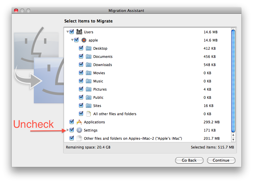

After you have a full backup on an external drive, you can do a clean install of OS X. When the install is done, you can use Migration Assistant to move your old apps from the external drive to your MacBook Pro. It would be advisable to NOT copy you settings from the external drive when given the choice.

Many thanks pastrychef!
And you are pretty sure that by doing that I will NOT copy to my fresh installed SSD disc any extension or preference that might be the previous cause of the kernel problem? Just wondering....
Andrea
By unchecking the settings, you should end up with a clean OS X.
No problem at all. Hope it solves your problem...
After you install OS X, try using the computer for a while before using Migration Assistant. (You can always launch Migration Assistant later on.) See how stable the computer is.

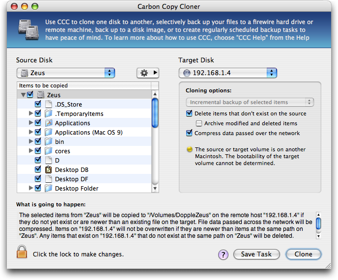

Hello, puffo25. Glad that the system is stable now. This proves that your issues were purely software related, which is great news.
Both Migration Assistant and Carbon Copy Cloner will allow you to restore specific portions of your backup back to your SSD (please see attached images). Just select the appropriate check boxes. I think that Carbon Copy Cloner gives finer control than Migration Assistant, though. For example, both will allow you to check/uncheck the Applications folder, but only Carbon Copy Cloner will let you select/deselect specific applications within that folder.

Thanks pastrychef for your continuous help!
When I use CarbonCopy (better than Migrator), however, I cannot easily copy a full application. There are certain apps that install several files (ie. main app, than few extensions, than preferences, registration number and so on. Photoshop and MS Office are 2 examples). If I do NOT have the original installer any more, when I copy the main app from the original backup, I do not know which other file to look from the original library or preference folder.
When I select as consequence an App to be copies, ie. Photoshop, CarbonCopy will NOT copy also all the pertinent (related) files and settings. Correct?
In that case I am a bit lost:-(
