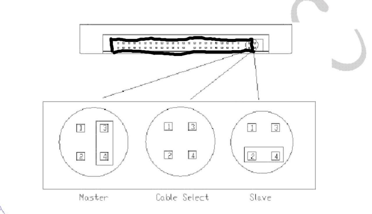

    Are you sure hard disk should be slave on iBook? I have put jumper off once, and the ssd was not seen by system.
    Putting the disk to slave mode is goin to be a problem because pata connector blocks the pins I need to put the drive into slave.

    #4
    you can short the two pins with thin wire, you do not need the jumper... just run some loops around both pins and you should be ok!
    I had the same problem with my new 32GB SSD. After viewing this diagram are you suggesting to wrap a thin wire between #2 and #4 pins? Will that activate the SSD?
