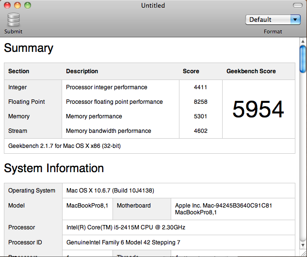

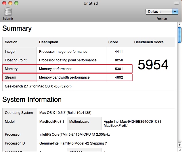

Benchmark it with Geekbench and you'll see. Check out my benchmark screenshot with stock 2011 MBP RAM (4GB @1333MHz) below. The 1600MHz RAM should perform marginally higher at stream: bandwidth performance (if it is indeed running at full speed).

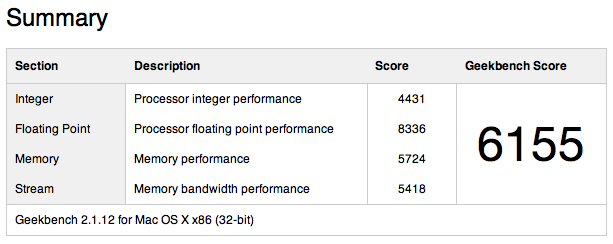

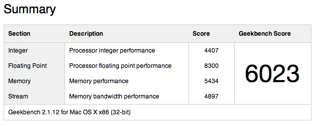

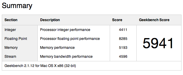

Here are my results.
Stock Configuration (Samsung 1333) - 5941
G. Skill (8GB 1333) - 6023
Kingston HyperX (8GB 1600) - 6155

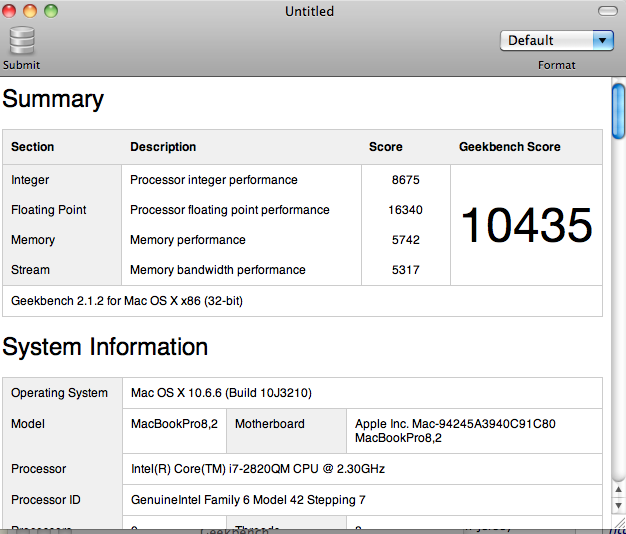

Then why are the memory benchmarks higher with the 1600? If the cpu can't take advantage of the extra speed, it should be very similar and not about 500 points difference.
5724/5418
vs.
5680/5109 (avg. of 5431/5005, 5865/5011, 5742/5311)
is a difference of 44/309 points, which is not that significant (it even happens among 1333mhz memories.
