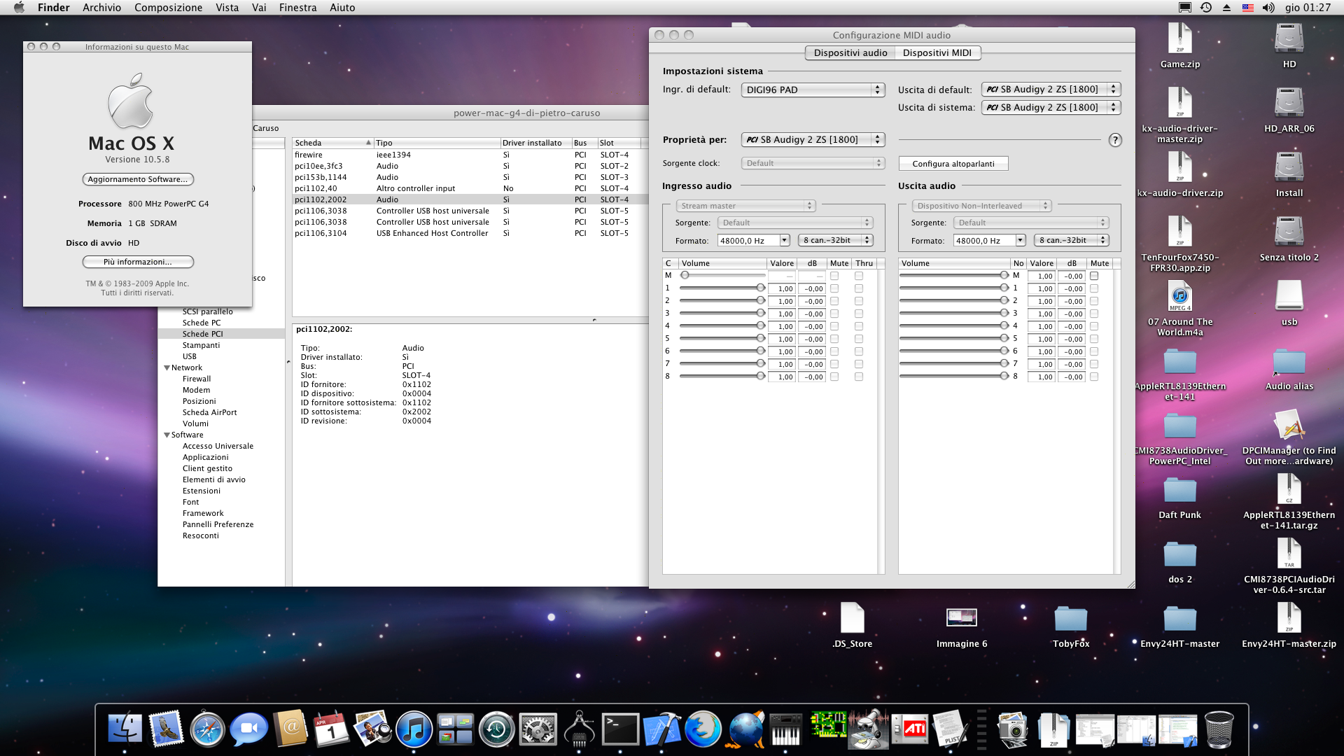

I managed to put together the first driver build that actually loads on my g4 and has some features working, playback is still not working but at least we have a starting point to begin with trouble shooting.
Here is a screenshot:
so i think the problem might be with some intel-specific stuff i didn't spotted (also because the code for the driver is huge) or with some other stuff about back porting i didn't know.
The problem at the end was something with the compiler, as soon as i switched to compiling for ppc only using gcc 3.3 the driver loaded fine

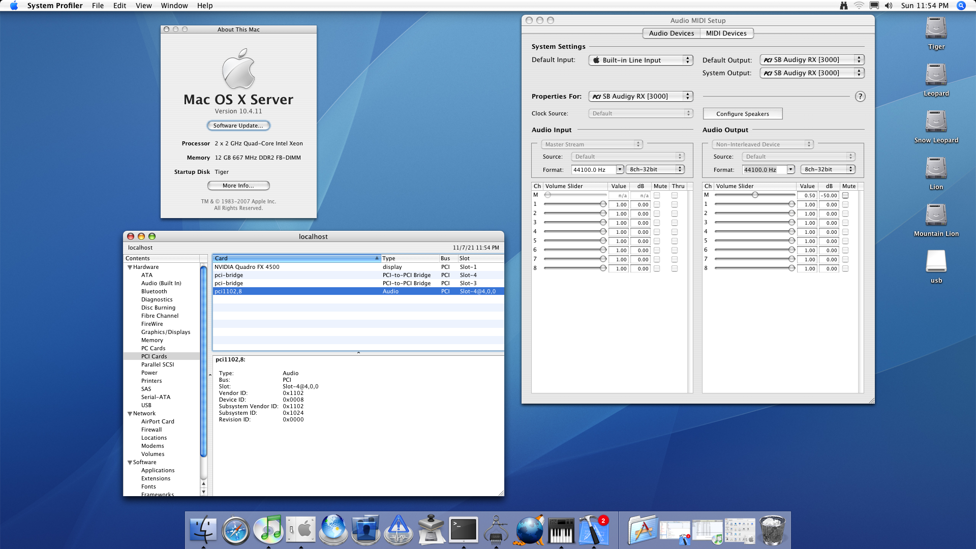

So updates, first of all i was able to get the latest kx audio driver working on tiger on intel macs only, here is a sound blaster audigy rx working on my mac pro (with some limitations like no proper sample conversion, and no support for nvram boot args to modify driver settings):
Second i went further in testing on PPC and it looks like the problem is with the sound card not reciving audio from the OS for some reason, in fact was able to test the dma buffers and confirm that they work, so no issues with them as I thought at first, perhaps this is an issue with just the OS X code afterall and not all the code that comes from the windows driver.
Reactions: reukiodo and Alb_rn
Guys i can't believe it! The playback works on the powermacg5 i just got and using Tiger as well! Apparently the problems i was having were caused by some os or kpi related issue. Now i am listening to RAM By Daft Punk very well on my G5!!! Amazing!

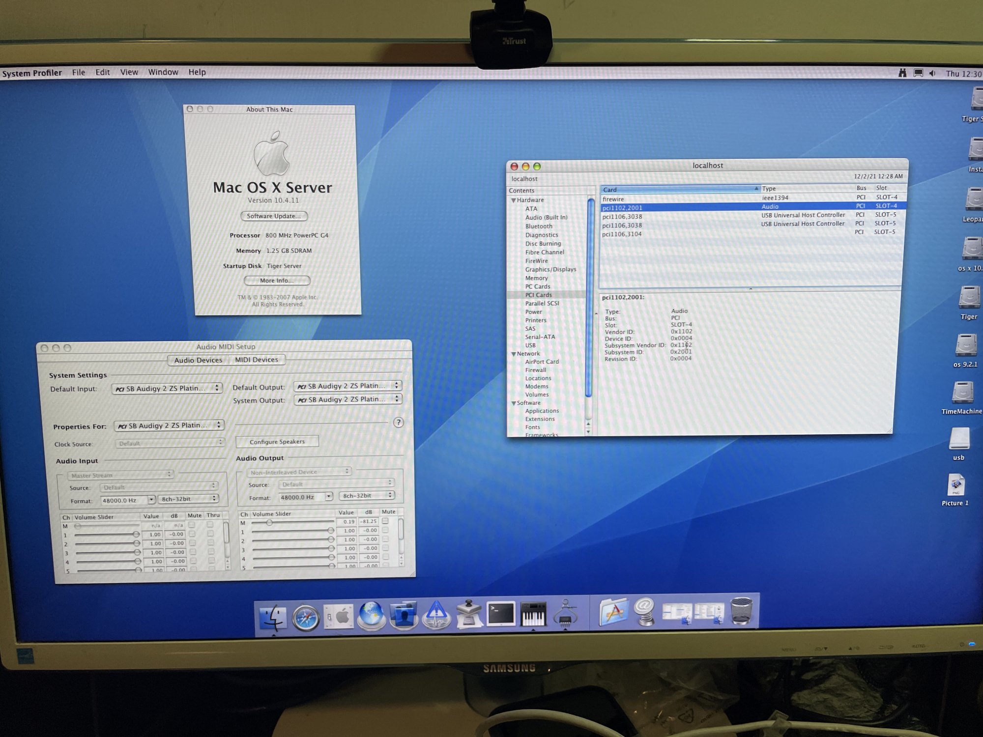

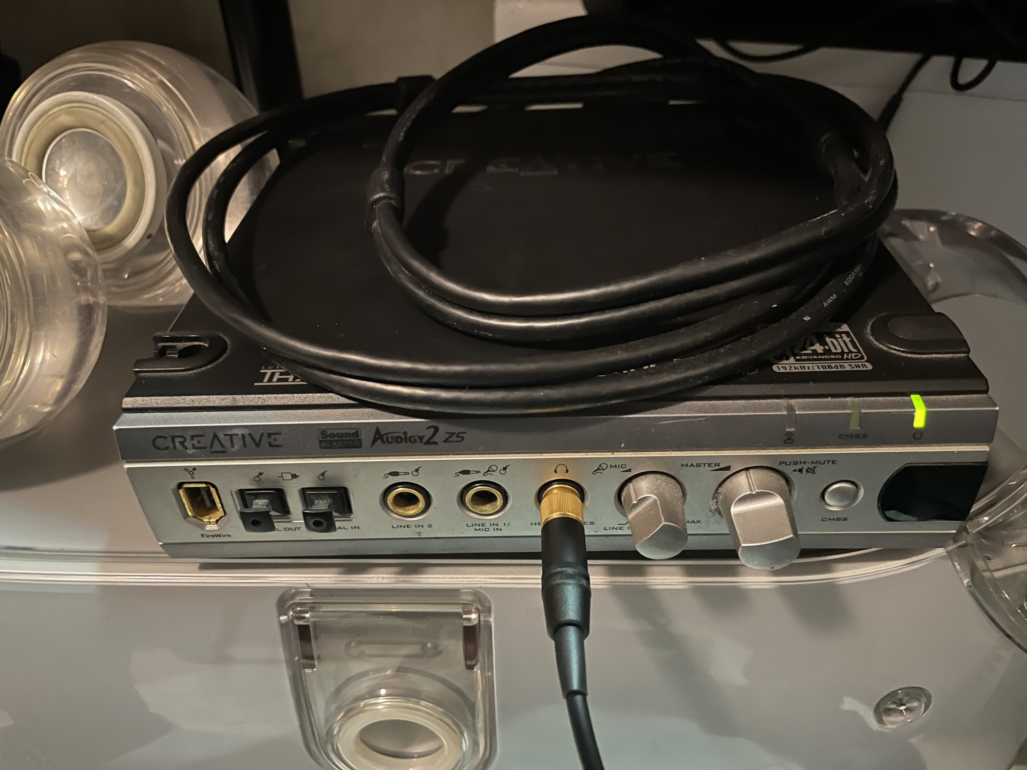

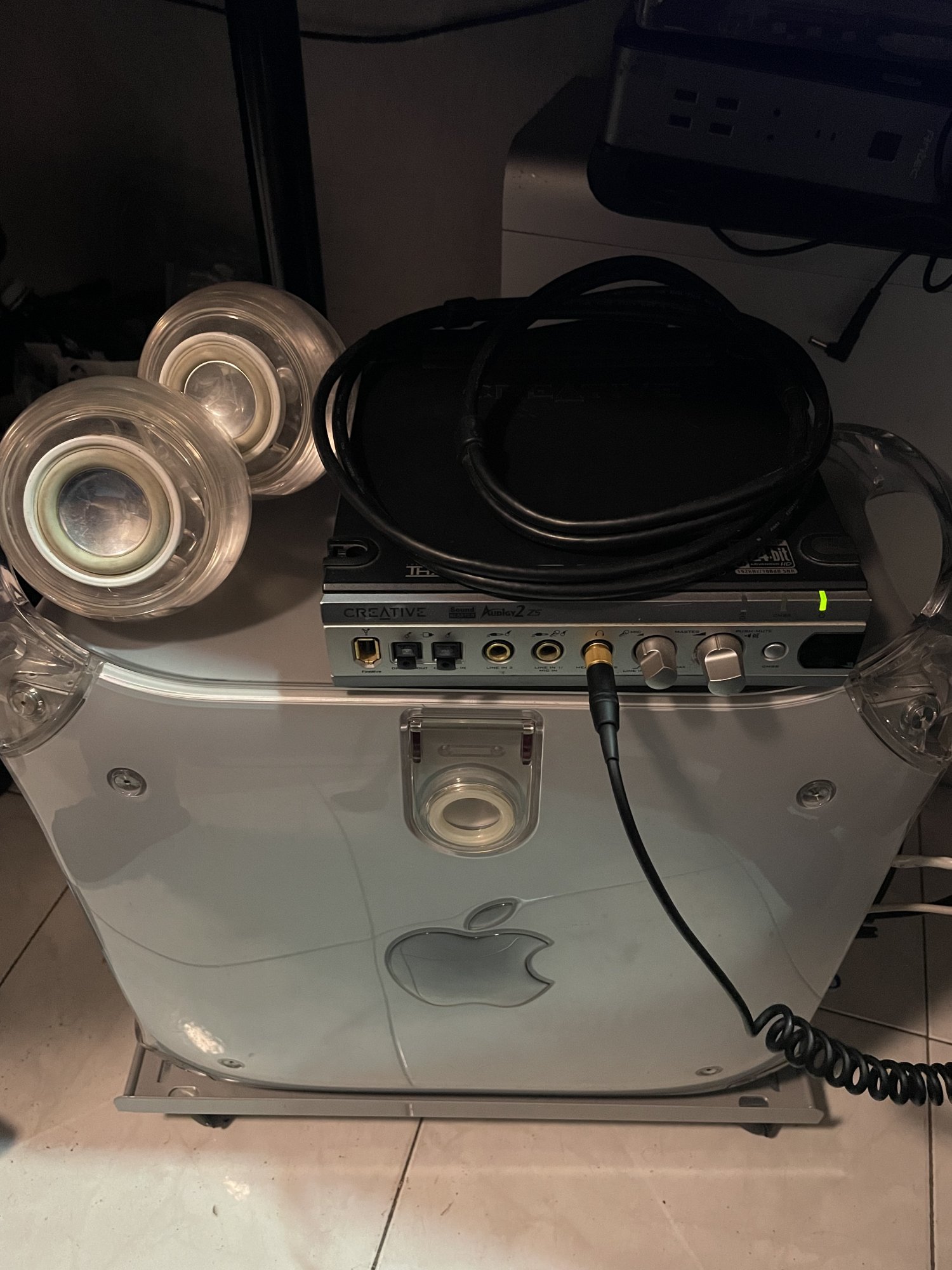

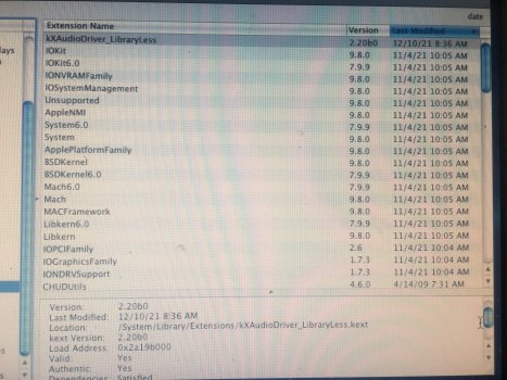

Update, the driver works on my g4 too but apparently it doesn’t work with consumer tiger, for some wired problem of the system it only works only with tiger server, this is valid for g5s too, but it works and now I can happily use my g4 with the audigy 2 zs platinum pro and the external i/o box. So as far as I know it should work with tiger server on a g3 too. I need to test it with a sound blaster live too but I expect it to be working. Also on the g4 192khz is working too but it very cpu intensive, I don’t think it going to work great on a g3, so my recommendation is to not go past 96khz on a slower cpu.
As for tiger server I got the installer from apple’s developers website btw, from this page (developers.apple.con/downloads/more) and you can download it too if you have a developer account, the download is 10.4.7 universal installer, it can be burned to dvd or on a flash drive, and it requires you to set your mac’s date to before the end of 2006 to accept the product key and be activated (you can set that from the terminal in the OS X server installer before you proceed to the installation by using this command: date -u 1201223006) and you can find the product key and the activation details in the release notes file for OS X 10.4.5 which is available on the same page. This doesn’t require you to disconnect the Mac from the network btw, also you can set back the correct date after you activated and configured the os installation.

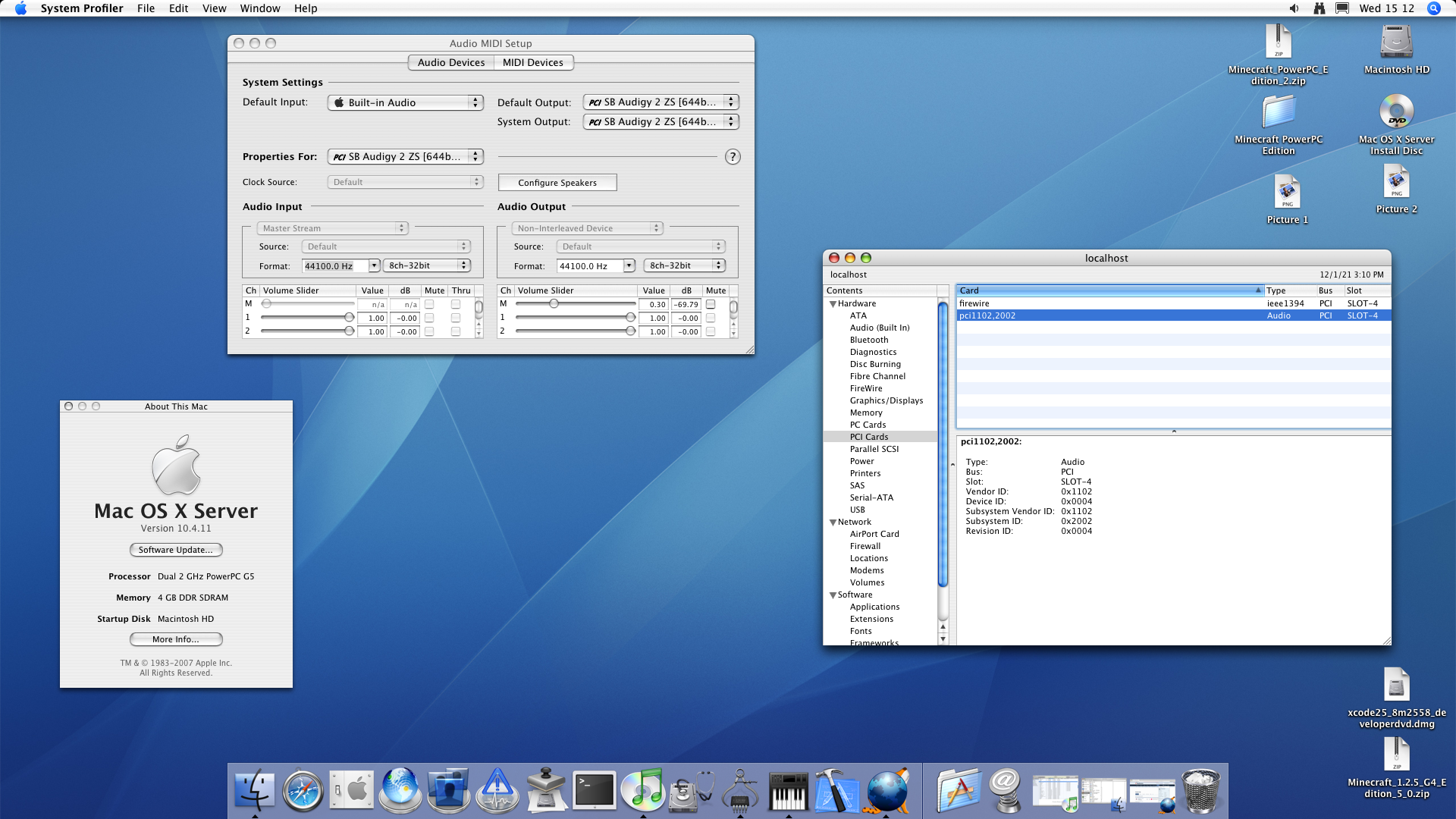

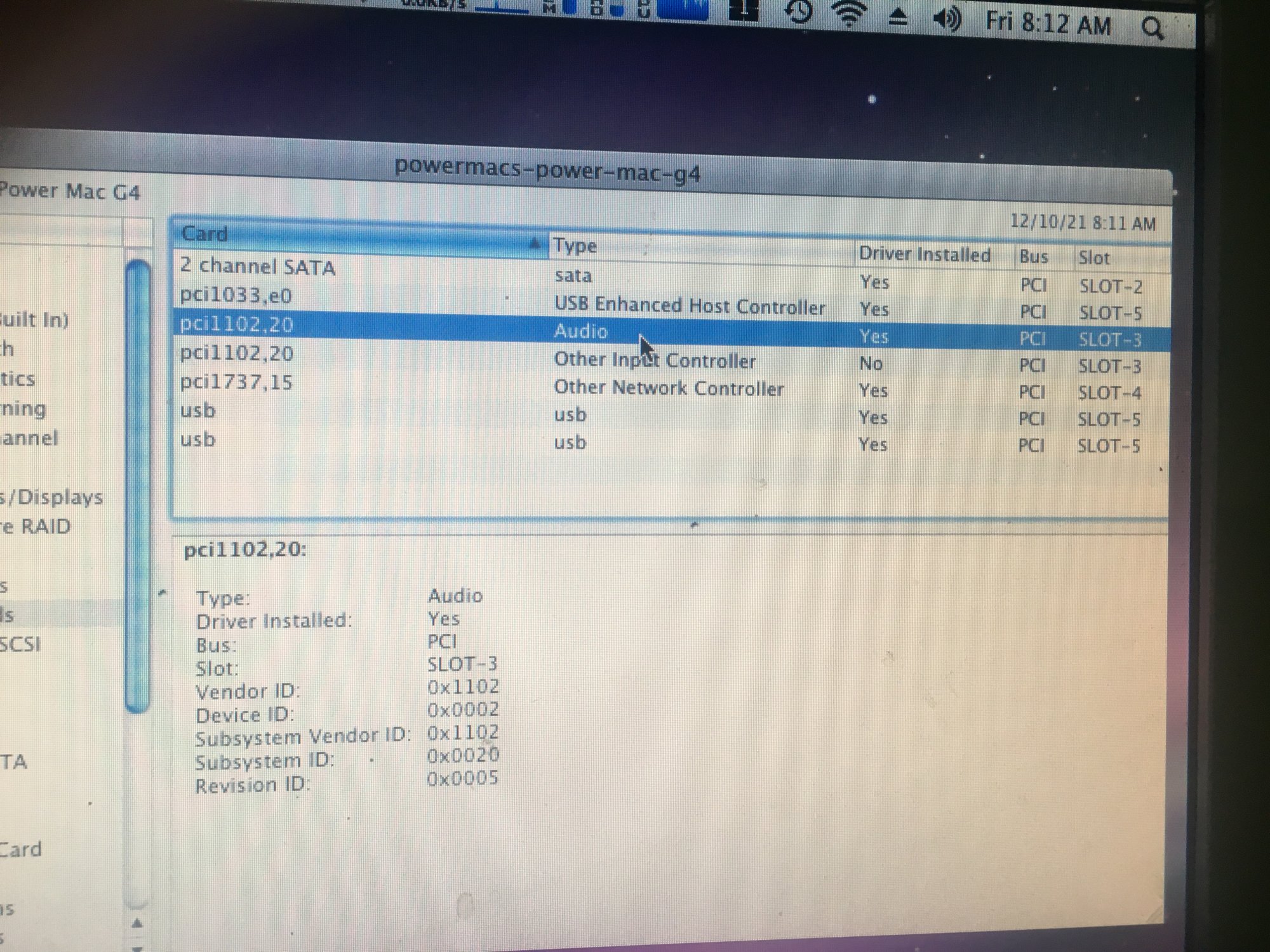

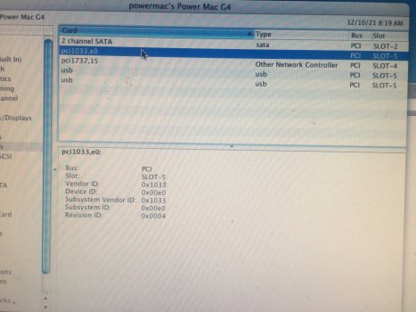

Works in 10.5.8,(when selected in VLC) absolutely no luck in 10.4.11(consumer, second picture) absolutely no recognition.
My device in signature.Card: Sound Blaster Live! Value.
Yes, this is a known thing, as i said there is an issuw with consumer tiger, for some reason the os refuses to load the driver and that happens with all custom os x audio drivers i tried, even for other cards, so i have to figure that out in some way, it seems to happen on intel macs too.
