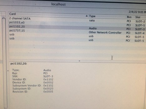

Got larger HDD, installed Tiger Server and it works! (Before I installed driver, it was not visible just like in consumer feline, notice missing “Other input controller”-that yellow gameport)
Yes, i don't know why but normal tiger is either missing some stuff or using some more restricted software, perhaps the api needed by the driver was fully deployed only on leopard for consumers some some internal apple reason. BTW i had some problems with the new source code release but it's getting ready, i need to tweak some stuff with the xcode project but it's working now (i had problems with the new experimental playback code crashing, but it's fixed now).

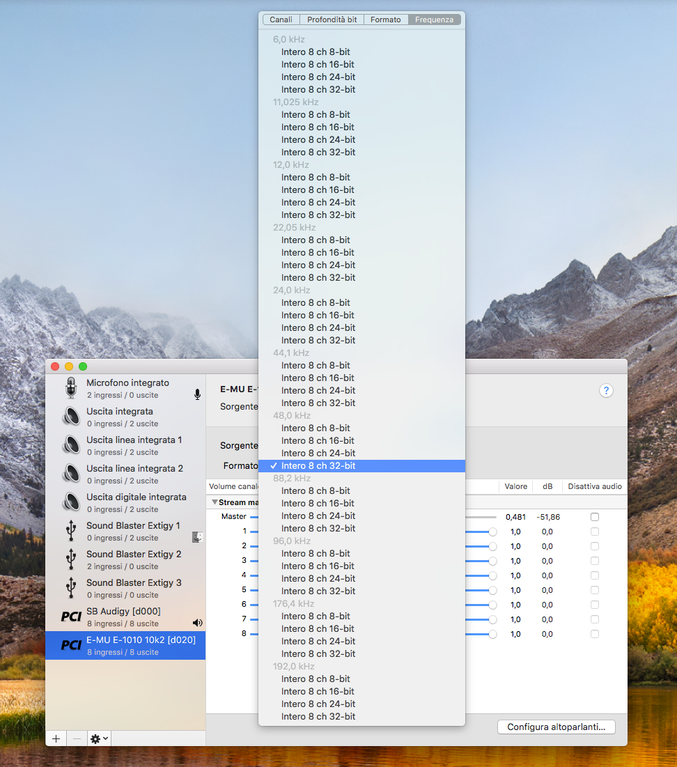

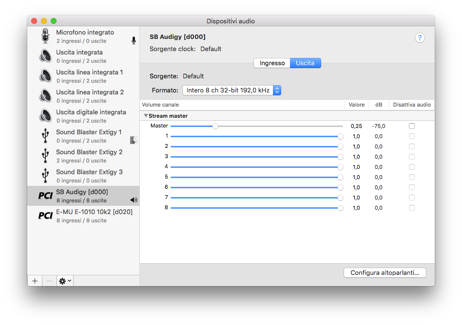

So i have managed to get multiple sound cards supported by the driver to show up for usage, so the next update will feature that. Also i have improved quite a lot support for sample rates on professional sund cards, toghether with overall performance while playing something back.
Here are some screenshots from my high sierra test rig (things will apply to powerpc macs too).
The new driver will be released for you to test as soon as i can test everything on my g5.

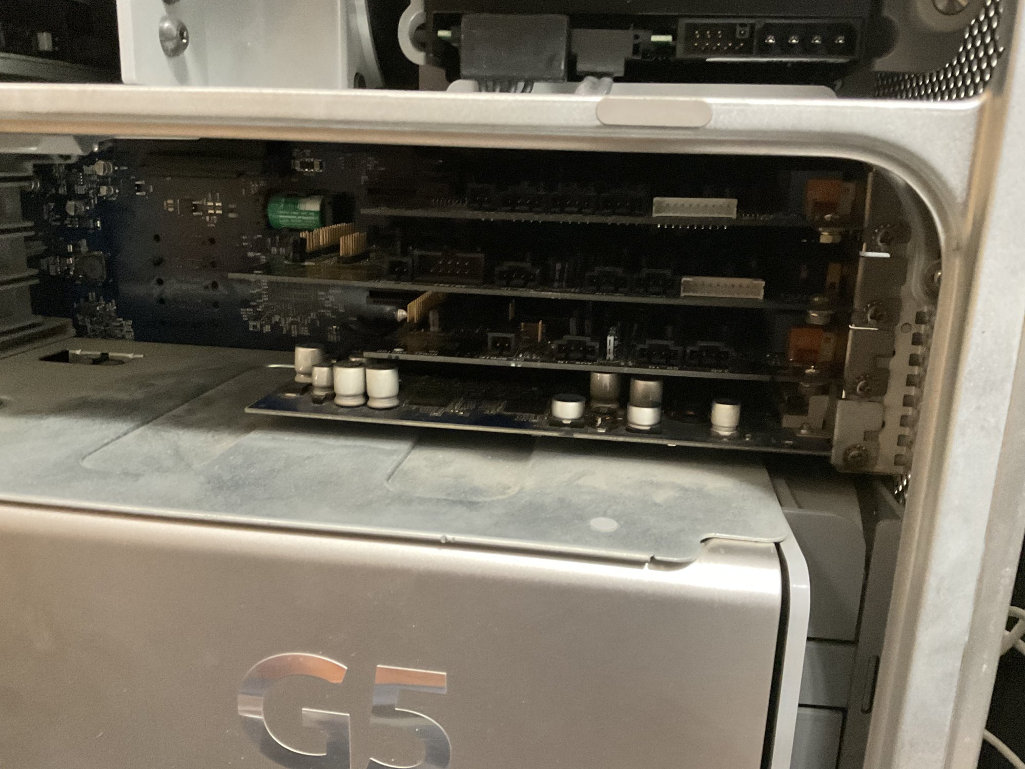

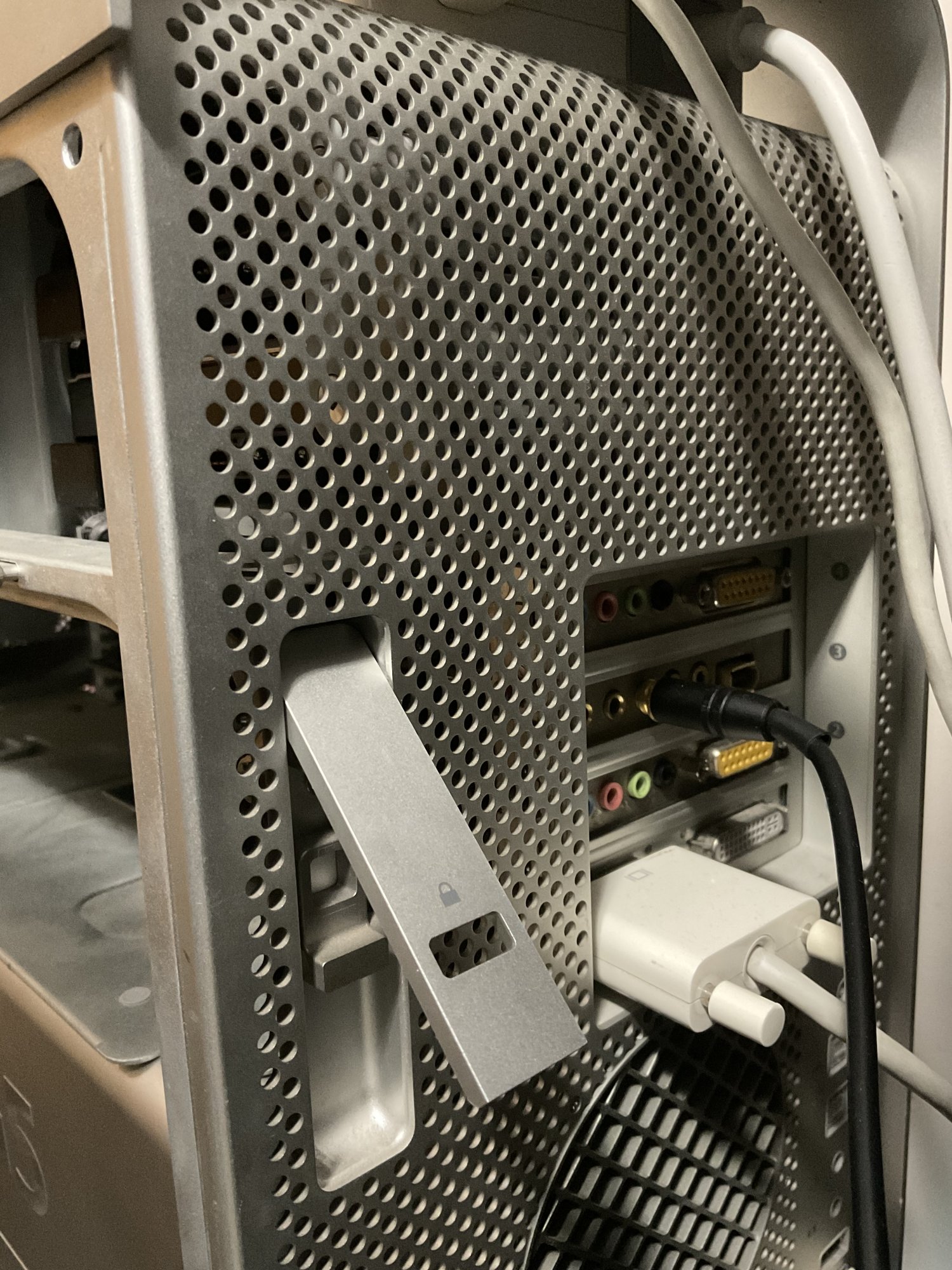

So after a lot of pain getting the sound cards to be detected and the mac to run stable, i am glad to present you this absolute abomination of a G5, featuring 2 sound blaster live 5.1 cards and a sound blaster audigy 2zs, in what i cal. the Sound Blaster SLI, all running using my new experimental version of the kx audio driver for powerpc macs.
The new release will come as soon as i am done testing it, since i have to test the new sample clipping and conversion code which should improve cpu usage while playing back. For now enjoy those pictures of the setup i made.
BTW as soon as i can i will also test 4 sound cards at the same time running in my g4 quick silver since it has one extra pci slot (which should be pretty much as much slots as you can ever use for pci sound cards in a powerpc mac running tiger server or newer).
