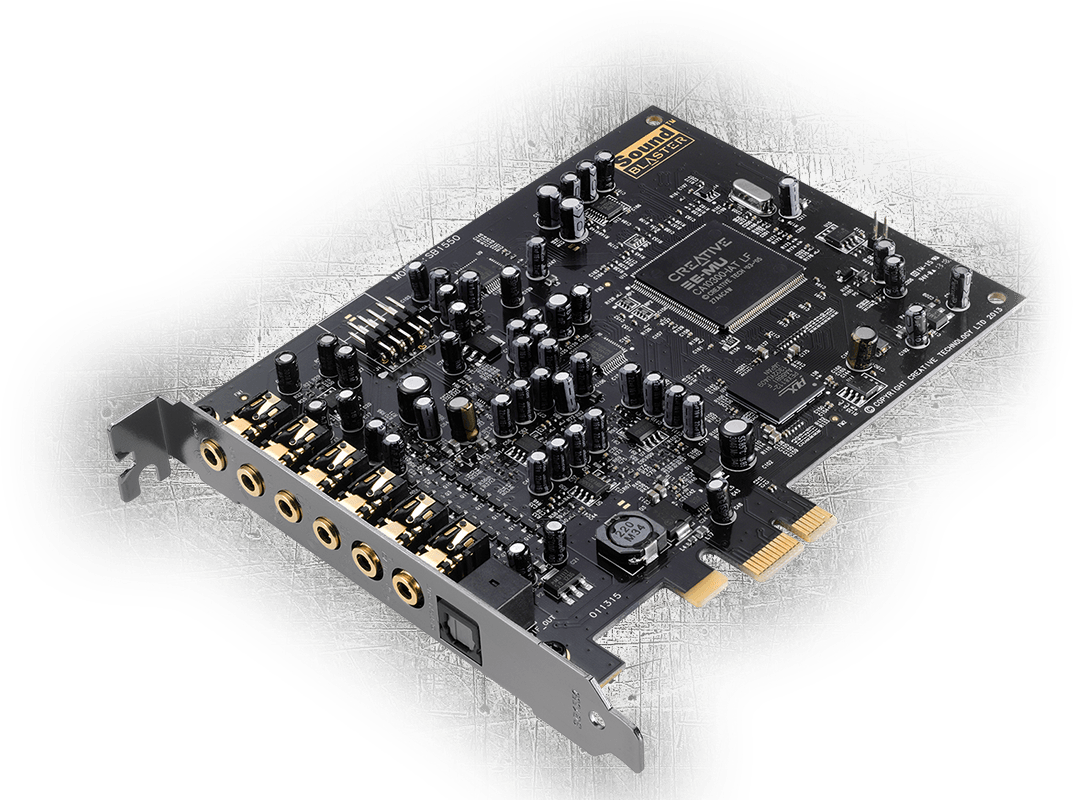

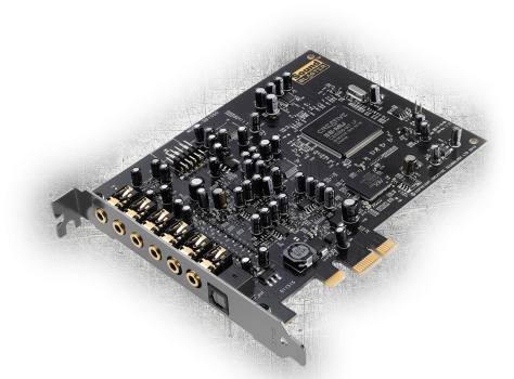

What is it's model number?
It's the sb1550 and it looks like this (see attached picture).
It's however untested by me on powerpc pc because i don't have the pcie g5, you might hear a hissing noise while connecting headphones or speakers to the card once the driver is loaded and for that i use a control app on intel macs that i haven't figure out yet how to port it to powerpc (i am not good in obj-c and it need to port it to obj-c 1).
