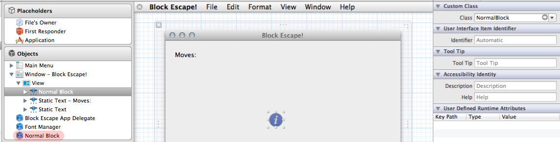

Disconnect and re-connect the connection to moveLabel in Interface Builder.
The aim here is to find out when the initialiser, awakeFromNib, and setMovesLabel are being called and on what instances they are being called.
These NSLog's will print out the method name and the address of the NormalBlock object. So you should be able to see if your mouse event methods are being called on the same instance as is the Nib setting movesLabel. You should also be able to confirm the movesLabel is in fact being set.
I know you didn't post the whole code of this class, but you get this idea.
If you get compiler errors about movesLabel being undefined, don't change it to _movesLabel, this would defeat the purpose of adding the logging accessors, change it to self.movesLabel.

Do you notice there are 2 NormalBlock objects here?
The first instance (0x1001579c0) is being inited, awoken and having moveLabel set.
Then a second instance (0x10014b660) becomes apparent and it's to this second instance that your mouse events are being sent.
So, why doesn't the label change?
Because the seconds instance's movedLabel hasn't been set and is nil/null. It's not the instance from the xib that has movedLabel set. It's some other instance.
Where/why are you seemingly unexpectedly creating a second instance?

EDIT: Follow up thoughts. Do you have this object in multiple XIB files?

Occam's razor. It's much more likely to be something wrong with how your XIBs are rigged up or something wrong in your code.
If we can find which initialiser is being used to initialise this second instance, we might be able to find out why/where/how it's being created. Do you notice that we don't have an initialiser logged for the second instance? That mens it's not being initialised via the NSTextField's designated initialiser (initWithFrame:).
So let's go through NSTextField's inheritance hierarchy to find all the possible initialisers that could be used. It looks simple, because other than NSTextField's designated initialiser (inherited from NSControl), the only other initialiser is init inherited from NSObject.

After reading other posts: Setting a breakpoint in initWithFrame and examining the call stack should solve the riddle.

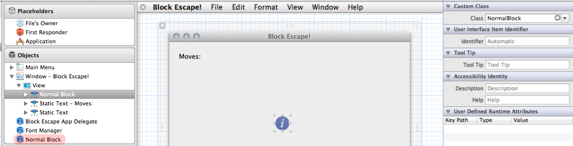

You do in fact have 2 NormalBlock objects in MainMenu.xib.
The first one in the one added as a subview (highlighted in grey below). It's the one on the window.
The second one is the one added as a top-level custom object (highlight in red below).
