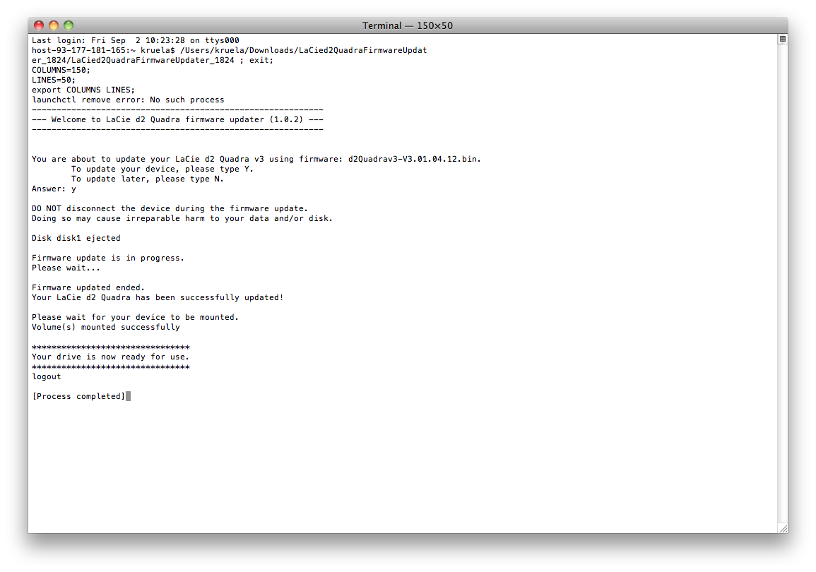

All you need is to connect via FireWire and follow instructions:

I tried to instal the firmware with no success.
In the Terminal, I 've got this message.
Can anybody help? Thanks!
______
Last login: Sat Jan 28 16:06:39 on ttys000
Isabelle:~ Maligoj$ /Users/Maligoj/Downloads/LaCied2QuadraFirmwareUpdater-MAC-1-1.0.3-Release/LaCied2QuadraFirmwareUpdater-MAC-1-0-3-Release ; exit;
COLUMNS=150;
LINES=50;
export COLUMNS LINES;
Password:
launchctl remove error: No such process
--- Welcome to LaCie d2 Quadra firmware updater (1.0.3) ---
Segmentation fault: 11
logout
[Process completed]
