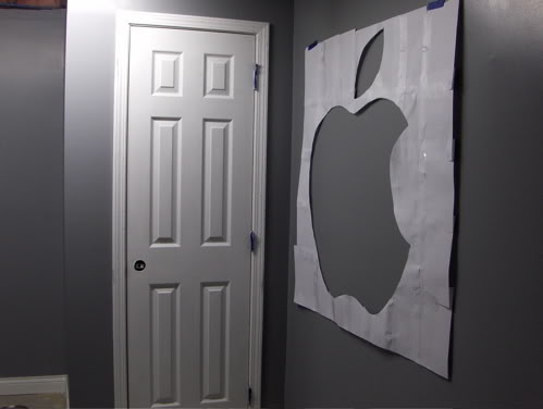

Parents got a new house and they have an extra room (very small) for me to store my old Macs. So I painted the room gray and made this 3.5' x 3.5' stencil to paint on the wall after the gray dries. Has anybody else tried this? If so, just wanted to see how it came out. I'll post some pics, either tomorrow or a couple days from now when this is all said and done.

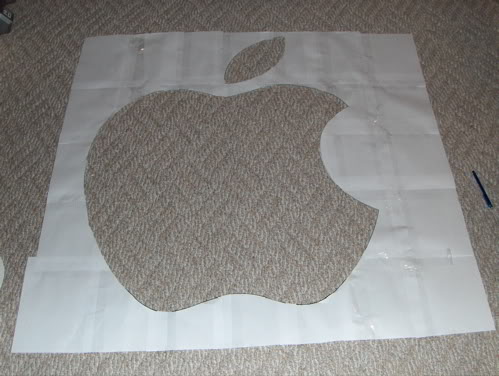

-Line up all those printed pages. Some will be blank because they are the inside or outside of the outline.

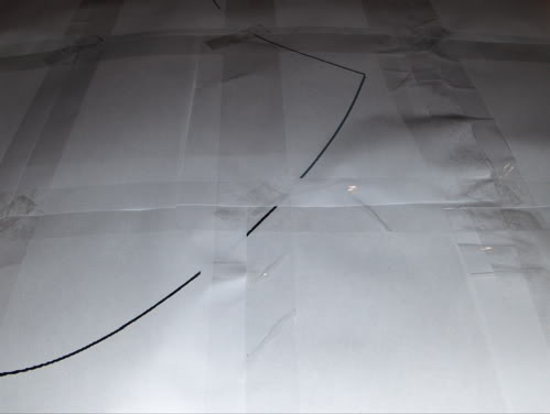

-Tape up the pages horizontally and vertically with large clear tape.
-Cut it out
-Tape it on the wall. I just taped the four corners.
-Paint! It took me 5 coats with an inch wide paint brush. I recommend a small paint brush because it's easy to be a clutz and have lingering bush hairs to go outside the outline.

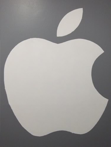

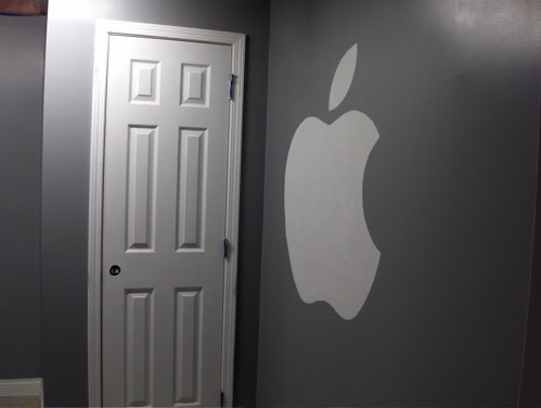

-I ended up painting with an off-white color so I had to, once again, paint the logo, but this time with a different color (flat white)
-Take stencil off and enjoy
-I'm going to do some pin striping around the logo because it looks a little frayed around the edges.

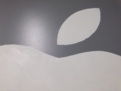

Also it seems that the left part of the Apple is slightly larger than the right (about 3/16" taller). This probably originated from the taping up procedure. The picture I took exaggerates that because of the angle it was taken in. But it always seems the left one is always slightly larger than the right. 😉
Well I hope you enjoyed the tutorial and let me say "Try at your own risk" I got lucky and only have a few small things on the logo to clean up.

actually looks very nice and i bet it was very tedious to do but in the outcome looks better than i thought it would 🙂
