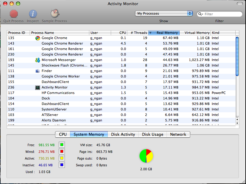

Youtube = Flash = CPU working hard = fan running. That would be normal. Did you actually ever follow people's advice and open Activity Monitor and check what your CPUs are doing - while Youtube is running? You realize that your fans are supposed to be running when your computer is working hard?
Yes, i have Activity monitor open to check. i only have MSN and 2 tabs (FB + youtube) open; is this consider CPU working hard? Here's a picture. The fan went up to 5xxx rpm with this and it comes down to 4xxxrpm without opening any other app or tabs. The tabs are FB, MR x 2, ifixit. Which number should I be looking at for CPU usage?
