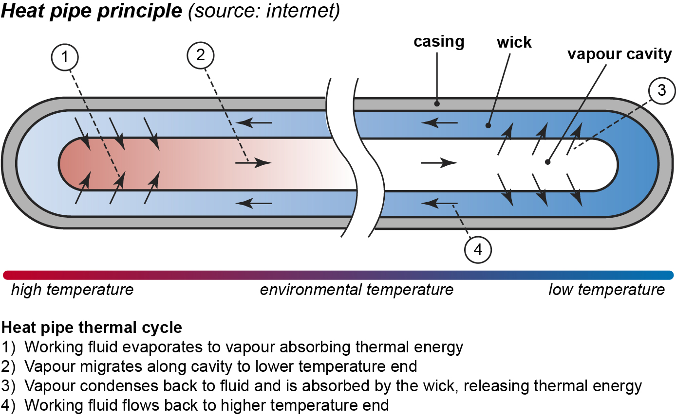

Other people said that the cooper pipes of the heatsinks may have leaks because they should have vapor inside for thermal transfer. But I'm not sure if it's true that this tiny cooper pipes have vapor inside.
Hope this can help you :)
I'm reasonably certain that there is no magic smoke inside the copper heatsink pipes.
As for the thermal paste, you take the heat sink off and see what the thermal paste looks like. If it's dried up you replace it. If it wasn't dried up, you replace it anyway, because you have to do that once you disturb it.
Reactions: JRoDDz
heat pipes do contain a liquid (distilled water + anticorrosion mix usually)
for the OP, as the others stated, clean (with isopropylic alcohol) both radiator base and cpu die / heatspreader and reapply paste correctly (not too much, not too little, seek guides if unsure).
Good pastes like noctua / thermalright / artic silver... can be left for a few years before needing replacement.
Reactions: guillepunx
I wouldn't have thought that a CPU heat sink would have pipes long enough to gain any significant advantage from vapor transport, but I see that I am wrong; thanks for the correction. Whether the iMac uses that sort of cooler, I couldn't say.
