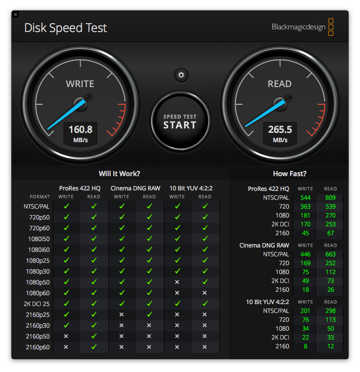

I just installed the MX500 using the OWC Data Doubler and 4GB of RAM salvaged from a MacBook. Opening the case was quite a pain, as was removing the two smaller antennae. Once I installed both and sealed it up, I was devastated to see a blinking file icon with a question mark which indicated no boot drive was found. After more trials of opening the case again (this time much faster) I realized that the SATA connector was not seated at all so I reseated it and everything worked. The RAM definitely makes a noticeable difference.
However, I ran a test of the SSD with Blackmagic Speedtest (running from the HDD) which reported reads and writes around 100-130 MBps. Isn't this staggeringly low compared to the expected 1.5 Gbps or 3Gbps?
I'm cloning my HDD to the SSD to see if it makes much of a difference or how much faster it feels.
Disappointing that this newer model apparently does not get 3 Gbps. I guess I have to decide if I should keep it or look for one that will get the full speed. I was considering the OWC one but it is over 50% more for less than half the storage.
Just for reference: here the best result of BlackMagic on my Mini Late 2009 with Samsung EVO 840 (256).
Please notice that this is the BEST result (usually the first), if I let the execution to continue usually I get also wort write results (very low if compared to the first). A little suggestion: just after the installation of the SSD, I had to reset PRAM to improve performances of the SSD.
1,5Gbps- speeds up to 150MB/s.
3Gbps- speeds up to 300MB/s.
Your Mac mini is Sata II (3Gbps) but it seems it's on Sata I speeds, like it was said on post#4.
I just found this topic here on macrumors. See if it can help you
Again, for reference, my Samsung EVO 840 is listed as having 3GBit link and also 3GB for negotiated speed (my DVD is instead listed as 1.5 negotiated speed), boot ROM version is MM31.00AD.B00, SMC version is 1.35f1.

  • Unfortunately the Crucial MX500 does not get 3 Gbps speed. I suppose the M500 or one of the OWC ones is recommended if you want the full speed. In my case, I'm pleased enough with the speed I'm getting and it was significantly cheaper than other options.

I ran the SSD speed test again and was pleasantly surprised to see it now consistently gives 200 MB/s write and 266 MB/s read speeds so I can definitely recommend the MX500 as a solid choice for SSD.
