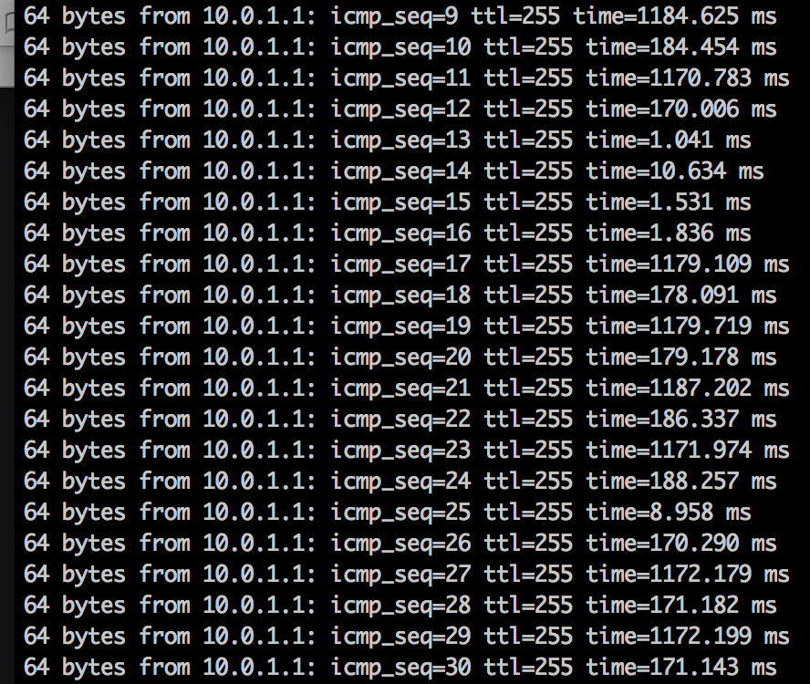

My contribution, I'm definitely seeing an issue. I've noticed performance problems in the past, but figured it was internet issues and it would resolve itself. My Mac Pro didn't seem to be having any problems, which I thought was odd, but I let it slide. When I saw this thread, I brought out the ping and low and behold:
This is about four feet from my 802.11ac Airport Extreme. My 2012 macbook? No issues.
Ethernet cable:
wi-fi from Apple Time Capsule 5g network. The Time Capsule is under my desk, less than 3ft from the iMac:
D-Link router 8ft away in same room as iMac:
This is why I don’t use wi-fi with my iMac - except for Time Machine backups…
