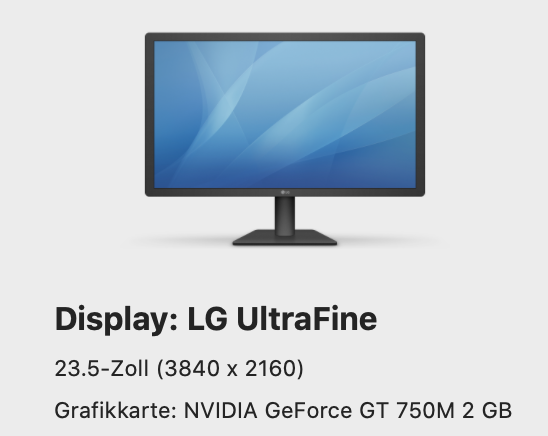

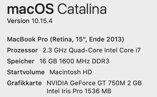

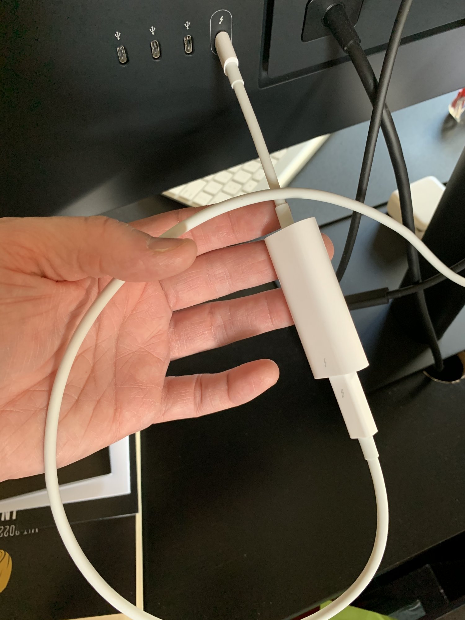

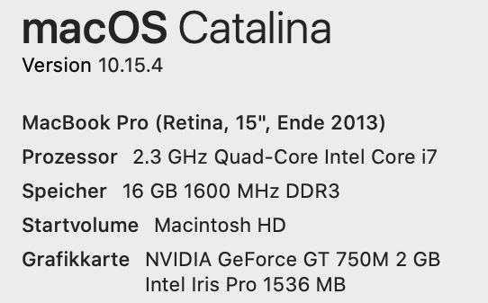

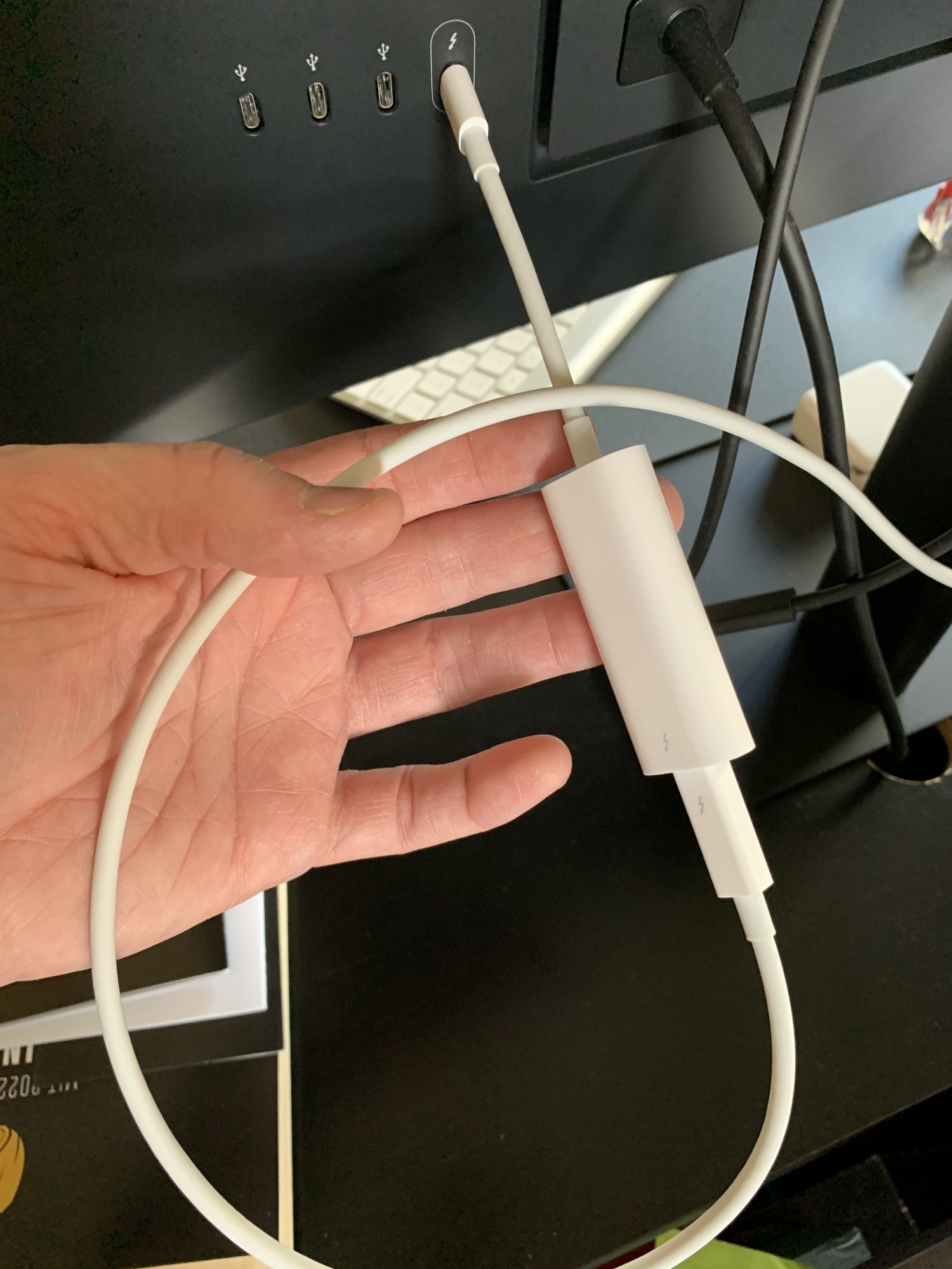

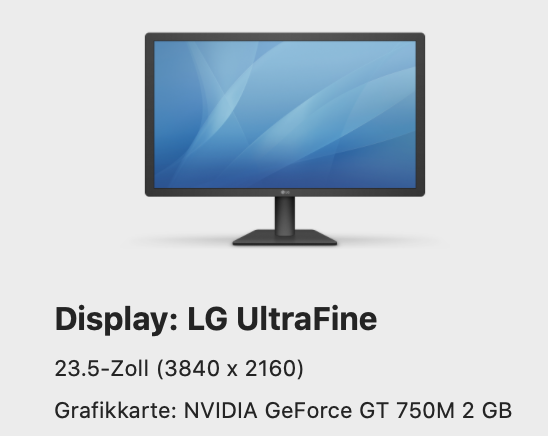

To resurrect this thread again and provide some hopefully helpful update on my experience.
I am using the new 23.7'' UltraFine™ 4K Monitor (LG 24MD4KL) with my Late 2013 MacBook Pro 15" (with NVIDIA GeForce GT 750M 2 GB) and it works just fine. Think having the model with a dedicated GPU is key here.
Have bought Apple's Thunderbolt 3 to Thunderbolt 2 adapter as well as a Thunderbolt 2 cable from Apple. At first it did not work when I plugged the screen in using macOS Mojave (10.14), but after updating to macOS Catalina it works fine and I have been using it for the last few weeks without issues.

Saw this thread was bumped. I don’t know what the refresh rates are but I’ve gotten my late 2013 to work on both the 23.7” Ultrafine 4K and the 27” Ultrafine 5k using a DisplayPort to usbc cable.

I simply use the original Apple mini display port cable it came with and have the white Apple DisplayPort to thunderbolt adapter they sell.
