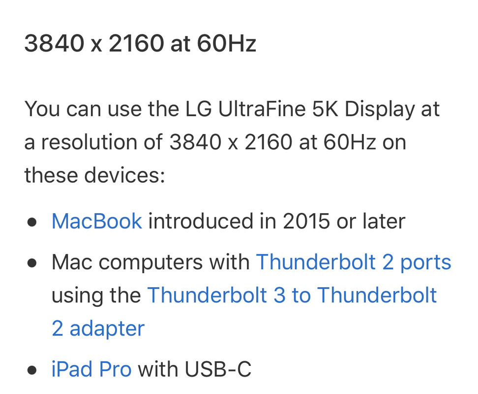

@ARK I also have MBP 15" 2013 but with Intel Iris Pro 1536 MB only. How do you think will the 27MD5KLB-B work for me either with 60HZ or it's only option for GT 750M? Can you check it please?
I wouldn't have high hopes for it to run at 60GHz, maybe at lower resolution 3840 x 2160 (163ppi)?
(https://support.apple.com/en-us/HT210205)
Sorry its taken so long to post. I honestly dont know but I gather that the GT 750M is automatically turning on to drive the 27MD5KLB-B.
