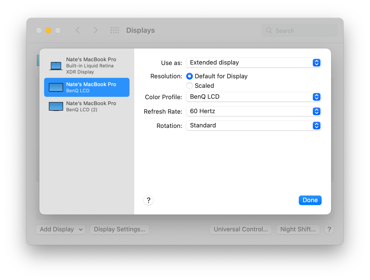

I'm running Monterey on a "MacBook Pro (16-inch, 2021)" and can drive two 27" 4k 60Hz monitors. These are Benq BL2711U monitors. https://www.benq.com/en-ap/monitor/designer/bl2711u.html
I was also able to drive these on my previous MacBook Pro, which was a 15" I believe 2018. It had a touchbar and only USB-C ports.
I'm not daisy chaining them. They're not capable, but also everything I've seen is that they have to be really expensive monitors to daisy chain because of the DisplayPort requirements. So I just have 2 separate video cables running from the monitors to my laptop.
Gotcha, I take it you're not using the setup in your original post anymore then? I'm trying to figure out how to restore the 4k 60hz external display setting in my late 2013 MBP.
Looks like you probably upgraded your computer not long after making the OP, so you probably never hit this problem with Catalina on a 2013.
Sorry, I'm not. I got a new work MPB in like 2018, then switched jobs this year which got me the 2021 M1 MBP.
