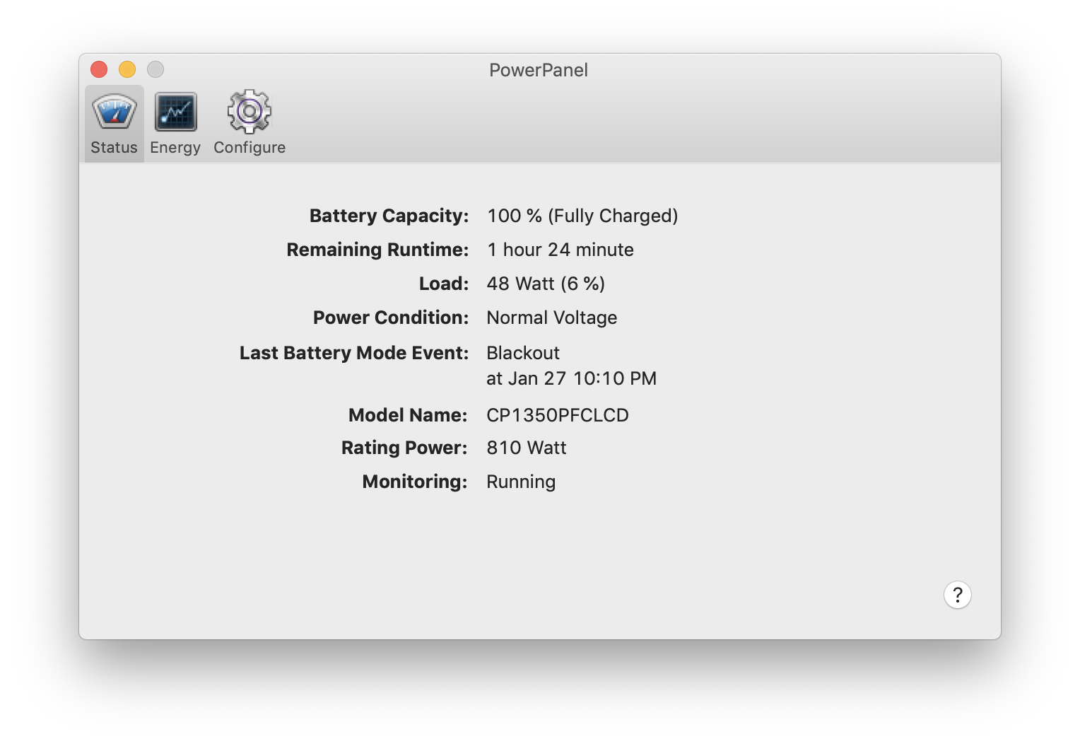

Unlike APC, CyberPower still provides software for the Mac beyond the basic built in support. Here is a screenshot of PowerPanel showing the average load of a 27" 5k iMac late 2015 on the Cyberpower unit.
The APC was never overloaded, battery was a possibility. I've just never had good success with APC units. So it was time to try something else, or just stick to a good surge protector. So far, so good.
FYI, the blackout status was from when I tested the unit, no actual power disruption happened. Power is usually pretty reliable here other then summer when there are storms.
