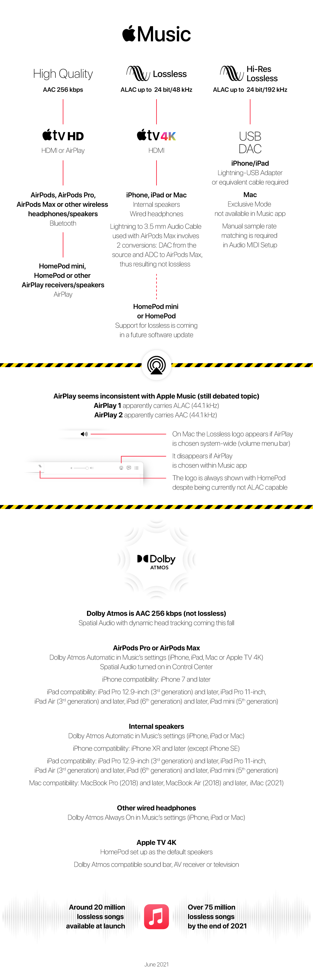

It's so confusing that I thought to prepare a cheat sheet:

@B/D Let's forget for a moment the lossless icon shown (apparently a mistake) in Music app when a HomePod is used.
I guess that the AAC conversion is happening only when Apple Music is streaming. I mean, the subscription. Local files are streamed to HomePod with ALAC, in my opinion, as are other sources.
AFAIK AirPlay 2 uses two modes: Real Time and Buffered. The former uses ALAC, the latter AAC. Apple Music streaming uses the Buffered mode, thus AAC.
Ironically, if you use another source, say YouTube, and stream its audio via AirPlay 2 you get an ALAC stream. YouTube is of course compressed upstream, so the ALAC received actually doesn't mean that the source is lossless. It's like getting a PNG originating from a JPG. Even though PNG is lossless, its original source already "compromised" it.
Obviously all my talks are a speculation because very little is officially known about AirPlay protocol, let alone what's going on inside a HomePod.
To recap: local files are probably streamed to HomePod in ALAC. Apple Music to AirPlay 2 provides an AAC stream. Why did Apple do this is beyond me. Officially, as you know, Apple announced that an update is coming to "unlock" ALAC for Apple Music, too.
There're evidences by Naim (using AirPlay 2) getting AAC from Apple Music.
If I stream Apple Music to an Apple TV HD (again, via AirPlay 2) the lossless icon is present despite it shouldn't be there (as per Apple's informations which mention only Apple TV 4K). BTW, with Xcode it's possible to debug on screen what an Apple TV is getting. I haven't tried it.
My AirPlay 1 streamer gets ALAC (as confirmed by the manufacturer's representative).
As you can see, something is wrong. I hope Apple will fix/clarify the AirPlay (1 and 2) behavior, eventually.

Thank you very much, @Marco Klobas
So, correct if I´m wrong, but if I understood you correctly, the audio situation on the Homepod as of today goes as follows:
A). You can, indeed, stream local CD quality files in the Homepod in ALAC, FLAC, or AIFF. These files will be played as they are (ie, no sound quality loss), by the Homepods.
B). However if you Airplay a lossless CD quality file from Apple Music to the Homepods, it will be converted down to AAC 256kbps before playback on the Homepods.
If so, seems dumb to me. An ALAC stream is an ALAC stream, and Airplay is lossless in real time mode. Why the Homepod would differentiate between local files and files from Apple Music, allowing lossless in one case but not in the other, and changing airplay modes (real time vs buffered)?.
What are we missing here?. Thanks again.
@B/D
A) Correct (with the AirPlay intrinsic limit of 44.1 kHz for audio).
B) Local files (those present in your Music Library and stored locally) are streamed ALAC. Those coming from iCloud (Apple Music catalogue) are streamed AAC.
It's definitely dumb. This is the reason why many AirPlay users (e.g. Naim users) are disappointed to see coming an AAC stream from lossless Apple Music. As you said, if everything were working as expected, Apple shouldn't have announced a lossless update for HomePod.
Most of us, me included, took for granted that lossless Apple Music would have supported AirPlay as expected: lossless at 44.1 kHz. Unfortunately, that's not the case. At least for AirPlay 2.
It's not the receiver (HomePod or whatever) that messes the AirPlay stream. It's specifically the Apple Music app.

Thanks again, @Marco Klobas
Yes, is a very weird situation. i thought the upcoming software update to the homepods would be required only to enable Siri to request the ALAC version of a song (if available) to the apple servers when you ask her to play something, but that in the meantime, we would be able to stream apple music lossless from our Macs and IOS devices to the Homepods. That´s not possible, unfortunately.
But wait a minute, when the update arrives to the homepods you will be able to play Apple Music lossless directly on the homepods (either by Siri or by remote controlling them from IOS or Mac Os, which is NOT Airplay), but if you use Airplay, it still will be AAC, because the problem, as you said, its in the airplay 2 implementation of the Music app regarding Icloud Music content. Am I right?.
What a mess...
PD: I guess this also means that, currently, I can´t Airplay lossless Apple Music to a Sonos speaker either. The direct stream of Apple Music lossless (ie, using the Sonos app), is currently not possible (a software update is required, just like the homepods), and I was thinking of using Airplay to circumvent this limitation.
Damn.
@B/D
On Apple's support page regarding Apple Music lossless curiously AirPlay is completely absent. Never mentioned.
I suppose that the Apple Music AirPlay handling by Music app will be fixed for all AirPlay devices, HomePod included of course.
iOS 15 beta shows already lossless audio for HomePod. I guess ALAC will be eventually available in both ways, either directly (e.g. invoking Siri) or via AirPlay.
I see no reason why Apple should't leverage its AirPlay technology to provide lossless audio (within the current 44.1 kHz limit). I even hope they will upgrade it to hi-res. I'm not holding my breath, though.

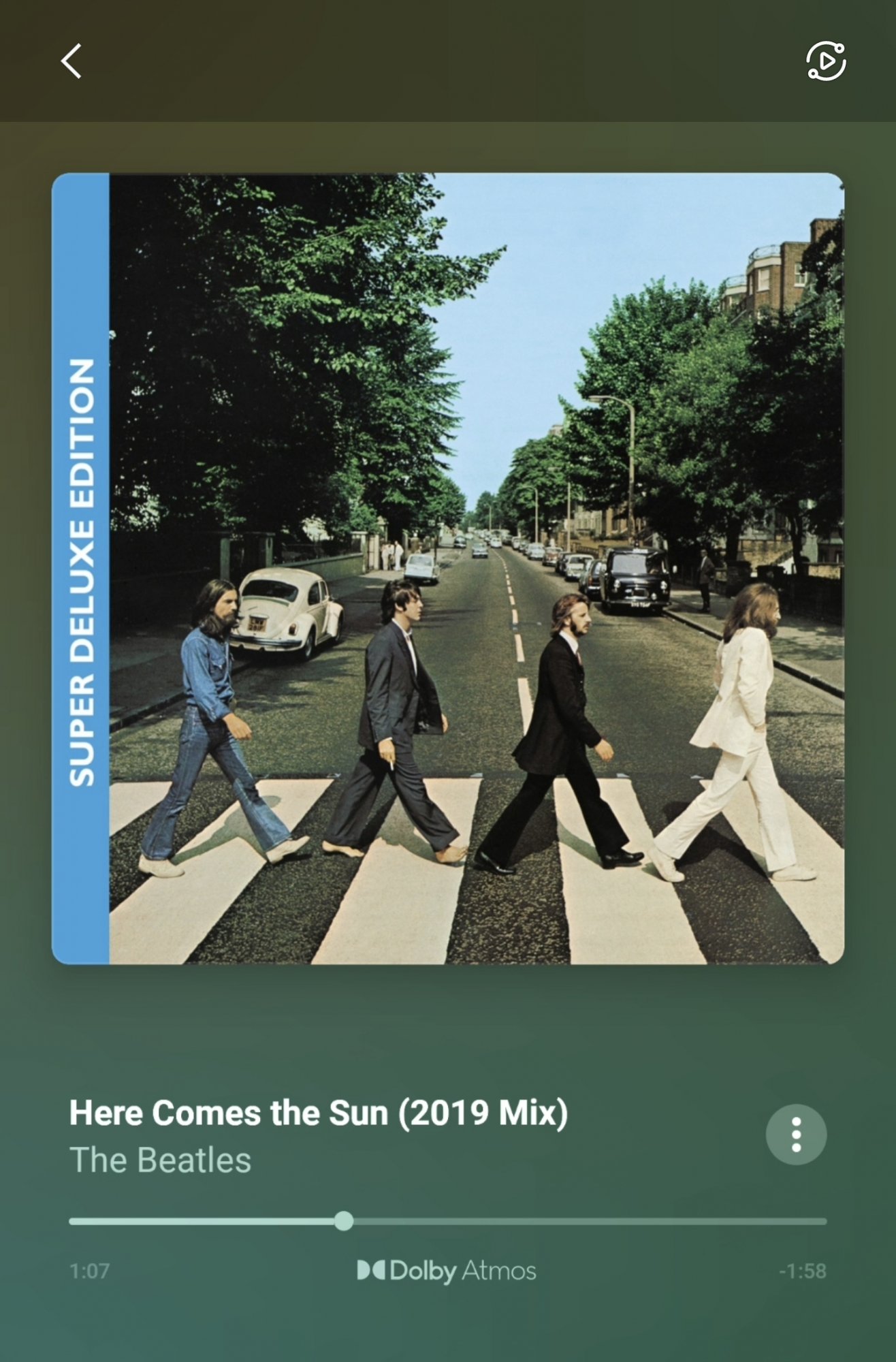

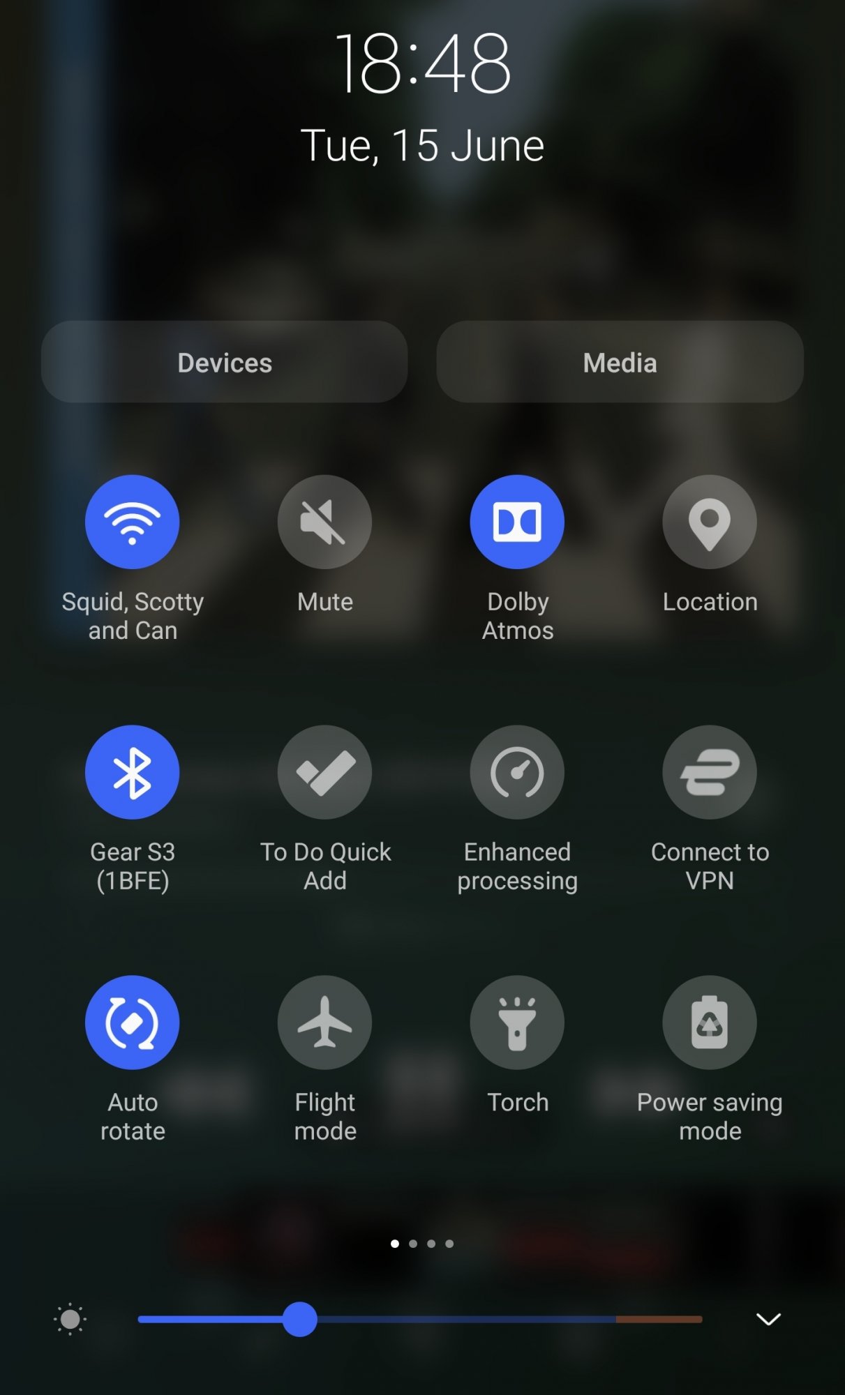

Fair-play Apple, this is actually pretty cool. I turn off dolby atmos on my s10+ samsung options bar.... Go into apple music, play a dolby atmos track and it automatically re-enables the phone dolby atmos option. Must be detecting it properly as a Dolby Atmos stream.
Sounds great too.
