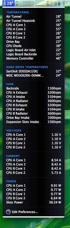

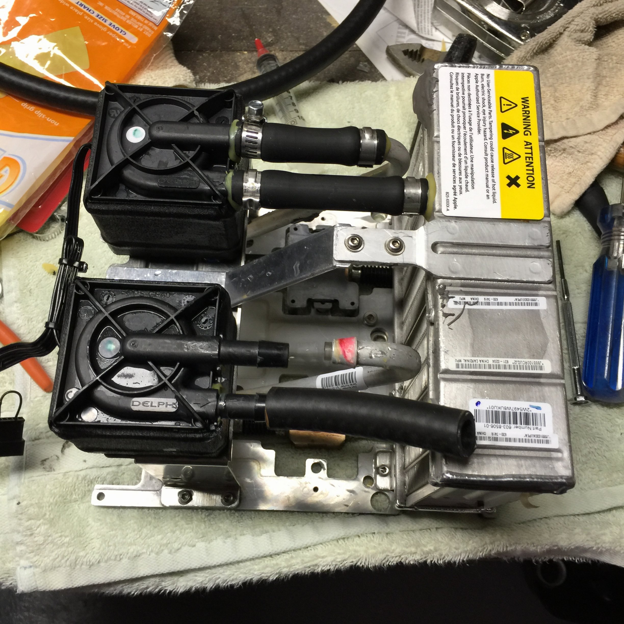

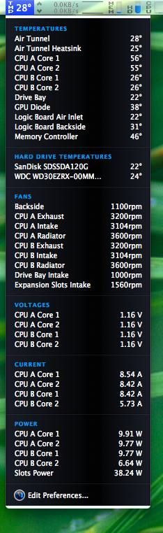

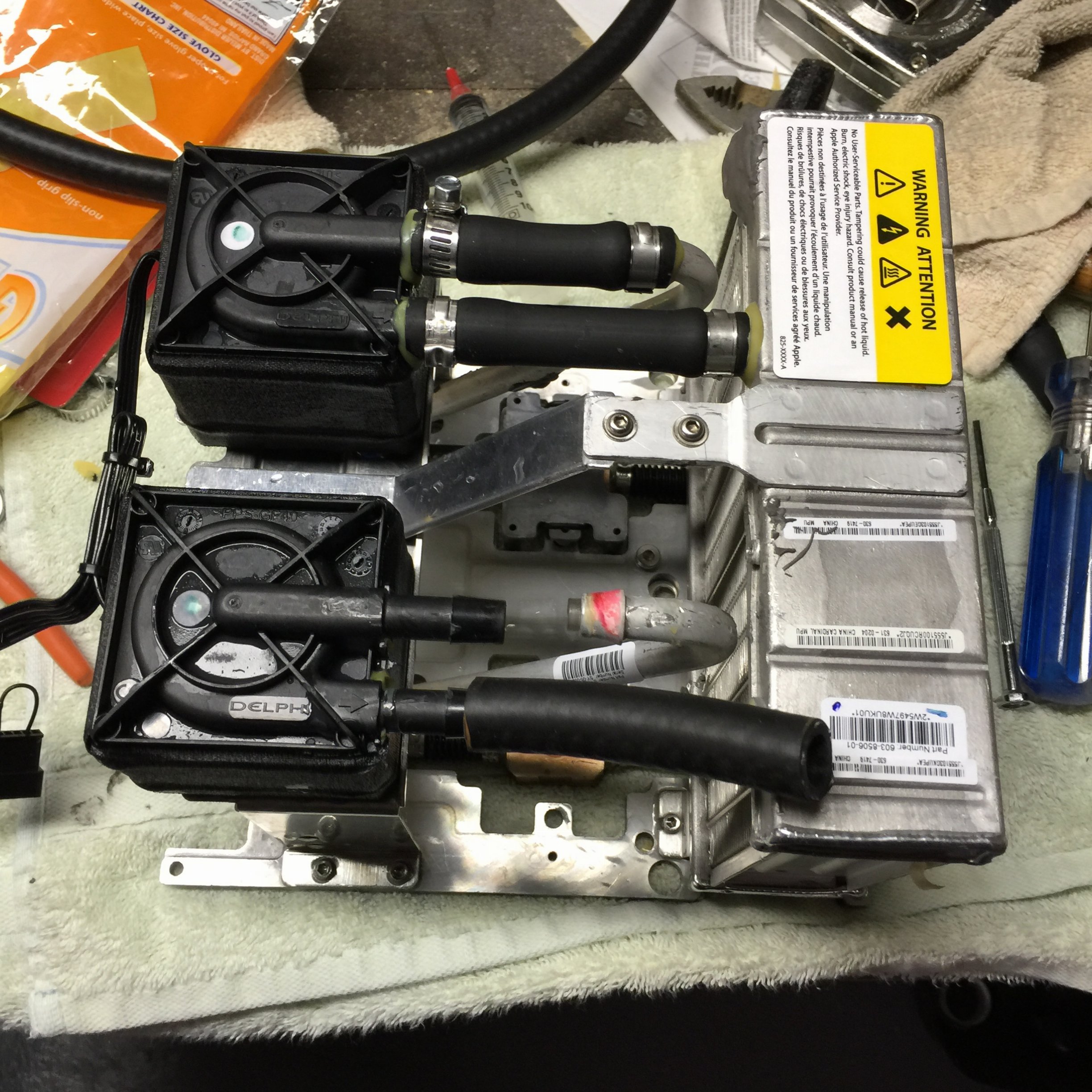

Soooooo....I tore into my quad LCS hard core tonight and did a complete flush once again and replaced the tubing on the A pump. The pump itself had a good flow during flushing and I spent some more time going reverse direction on the CPU runs. Since I couldn't find any corrugated type tube at the auto store, I decided not to tear into that part of the unit. If you recall, CPU B after my last flush was reading around 30C, I'm thinking of leaving that pump alone for now. If all works out, what is the ideal temperature these units should be at?
