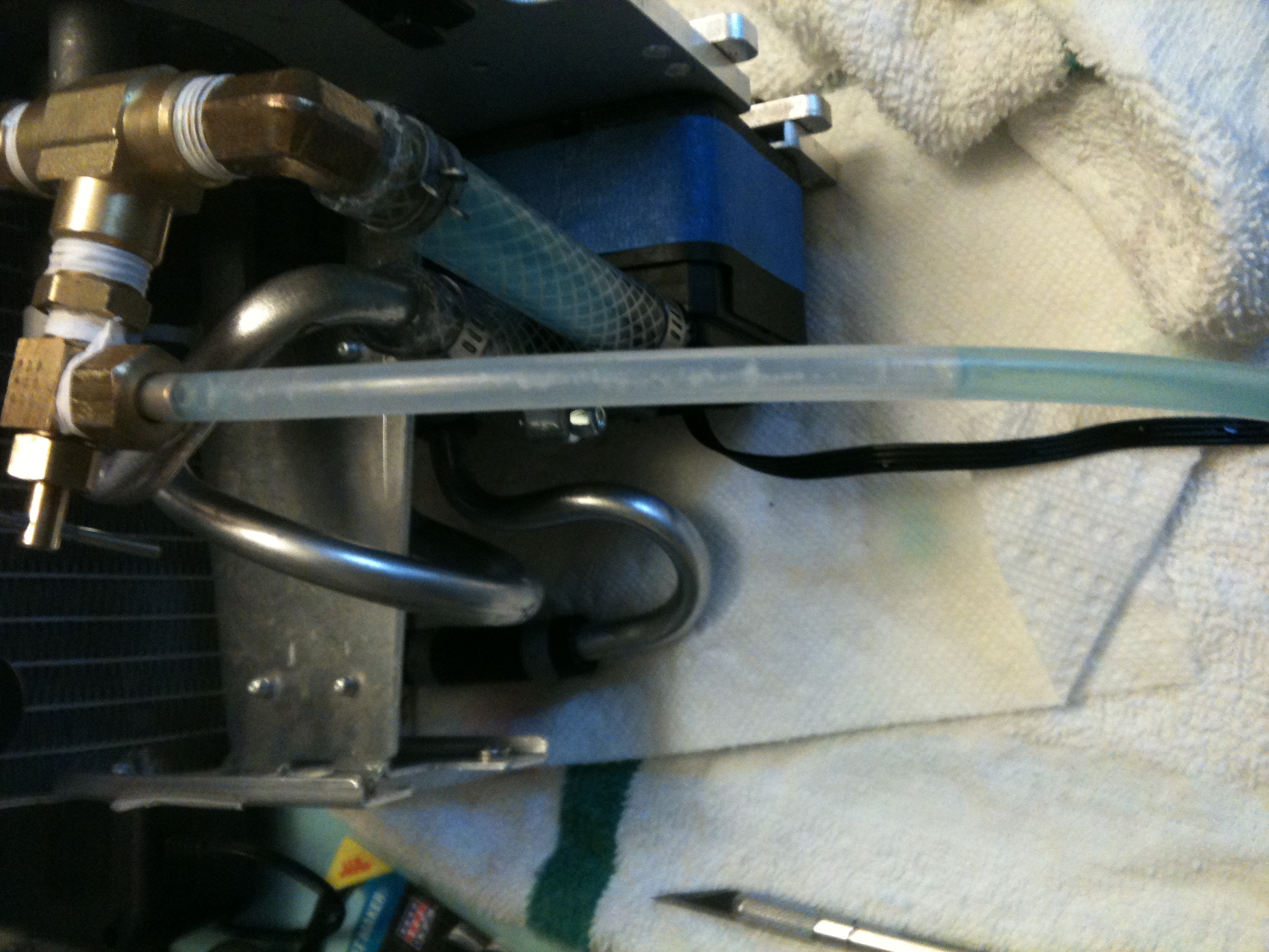

The rubber tubing had to be cut off with an exacto knife because there was some corrosion on the metal where the rubber tubing connected to the aluminum tubing. I disassembled the pump and cleaned it out (not as difficult as it sounds). Its 2 torx screws to remove it from the LCS and 4 torx screws to release the top plate. I also used a dremil tool with a wire brush attachment to remove the corrosion on the aluminium tubing tips.
While I was wanting to use clear tubing, so I could see if the coolant was flowing, I was not too trusting of some others doing rebuilds using tubing found at their local hardware store. My concerns were with the temperatures melting the tubing, chemical resistance and possible pressure failures. While MSC industrial supply (www.mscdirect.com) carries some possible clear tubing that can be purchased by the foot for less than $1.00/per foot, I have been without my machine for over 2 weeks and didn't want to wait for the order and possibly purchasing the wrong size as I did with the O-ring.
----MY CUSTOMER SUPPORT EXPERIENCES WITH MSC HAVE BEEN NOTHING SHORT OF TOP NOTCH. I CALL AND TELL THE SALES REP WHAT I AM NEEDING. SINCE EACH TIME I HAVE CALLED MY QUESTIONS HAVE BEEN OF A VERY TECHNICAL NATURE. THEY ARE MORE THAN HAPPY TO CONNECT ME WITH A TECH PERSON. MY QUESTIONS WERE RELATED TO THE BEST MATERIAL FOR MY APPLICATION WHEN PURCHASING AN O-RING, WHICH CLEAR TUBING IS BEST, AND EVEN HELPED ME FIND SOME POSSIBLE SOLUTIONS TO BE ABLE TO VISUALLY CHECK COOLANT FLOW IN LIEU OF USING CLEAR TUBING. I NEVER FELT LIKE THEY WERE RUSHING TO GIVE ME AN ANSWER AND TOOK THE TIME TO DO THE RESEARCH AND DOUBLE CHECK THAT THEIR SUGGESTED SOLUTION MET MY SPECIFIC NEEDS OF CHEMICAL RESISTANCE, TEMPERATURE, AND PRESSURE. AND IF YOU ORDER BY 8 PM EST YOU CAN HAVE IT DELIVERED NEXT DAY AT NO ADDITIONAL CHARGE. THE ICING ON THE GEEK CAKE IS THAT THEIR CATALOGUE (CALLED 'THE BIG BOOK') IS A 6-7 POUND HARDCOVER BOOK THAT IS OVER 5" THICK. YOU CAN REQUEST ONE AT NO COST AND THEIR WEBSITE SHOWS, IN THE ITEM DESCRIPTIONS, WHAT PAGE IN THE BIG BOOK YOU CAN FIND THE ITEM. YOU CAN READ MORE ABOUT THE ITEM, TYPICAL APPLICATIONS, AND I HAVE FOUND IT AN IMMENSELY USEFUL AND HELPFUL RESOURCE FOR EDUCATING ME ON SOLUTIONS AND PRODUCTS I AM NOT TOO FAMILIAR WITH. COMBINE THAT WITH THE CONVERSATIONS WITH THE MSC TECHNICAL PERSONS, I FEEL CONFIDENT WITH MY CHOICE OF ITEMS FOR MY REPAIR. AND ON A DIFFERENT NOTE THEY ALSO SELL LOTS OF OTHER ITEMS RANGING FROM THE MORE PEDESTRIAN TO THE TECHNICALLY EXOTIC. BEING A STRINGENT DIYer I AM LOOKING FORWARD TO TACKLING SOME HOME PROJECTS THAT WERE HAD TO BE LEFT TO A PROFESSIONAL BECAUSE I COULDN'T GET ACCESS TO THE SAME MATERIALS LIKE CLEANING MY HVAC EVAPORATOR COIL. ITS AN EASY ENOUGH PROCESS TO DUPLICATE AFTER WATCHING THE HVAC REPAIRMAN; SIMPLY OPEN UP THE UNIT AND SPRAY ON A CHEMICAL AND WIPE AWAY ALL THE GRIME. MSC SELLS THE COIL CLEANER SO NEXT TIME I CAN SAVE SOME $$ ON A SERVICE CALL!!! IF YOU LIKE READING MANUALS AND TECH SHEETS THEN YOU WILL FIND THE MSC 'BIG BOOK' A WONDERFUL READ. I WON'T SPOIL THE ENDING BUT WILL SAY THAT IT IS A BOOK THAT YOU HAVE TO PUT DOWN FROM TIME TO TIME SINCE IT WEIGHS SO MUCH 🙂-----
I choose to go to my local auto parts store and purchased radiator tubing and will be using that. MSC also has lots of options that you could incorporate into your rebuild like flow indicators and flow sights. Both will allow you to visually detect if coolant is flowing. If I find that refilling the radiator is not too difficult I might add some kind of piece that will allow me to visually check coolant flow at a future date.

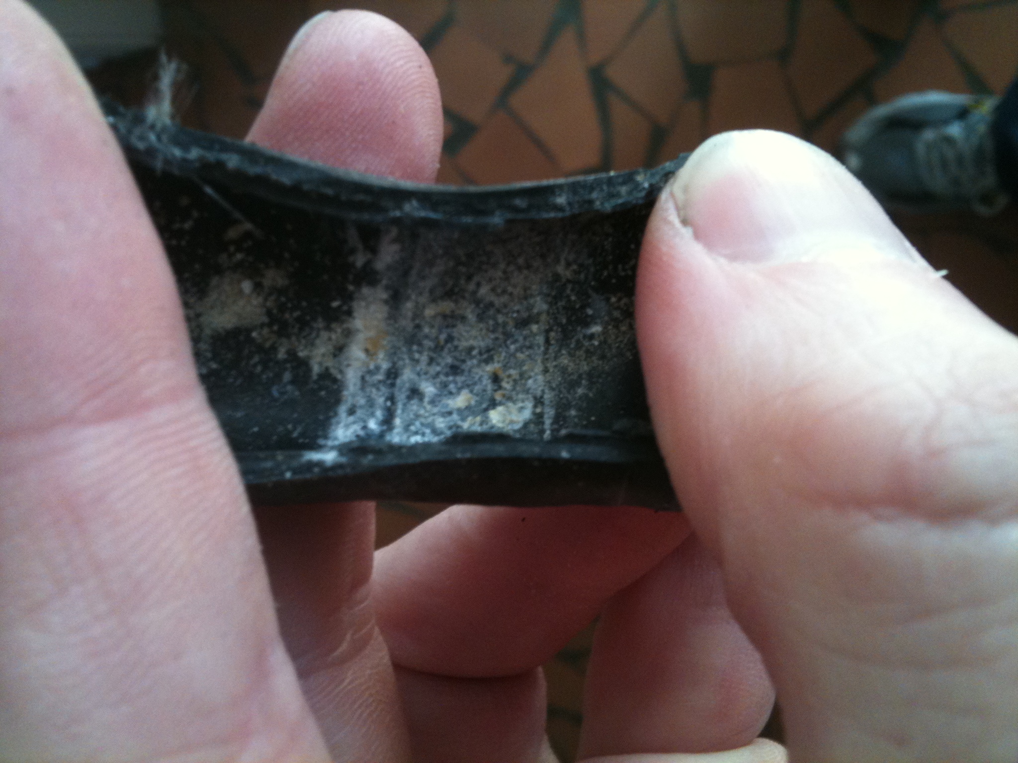

I used jewelry cleaner to get the junk out from in between the copper blades of the heat block after I used an exacto knife to go between the blades and scrape out gunk. I was careful to not bend the blades to much but just enough to get the knife in.

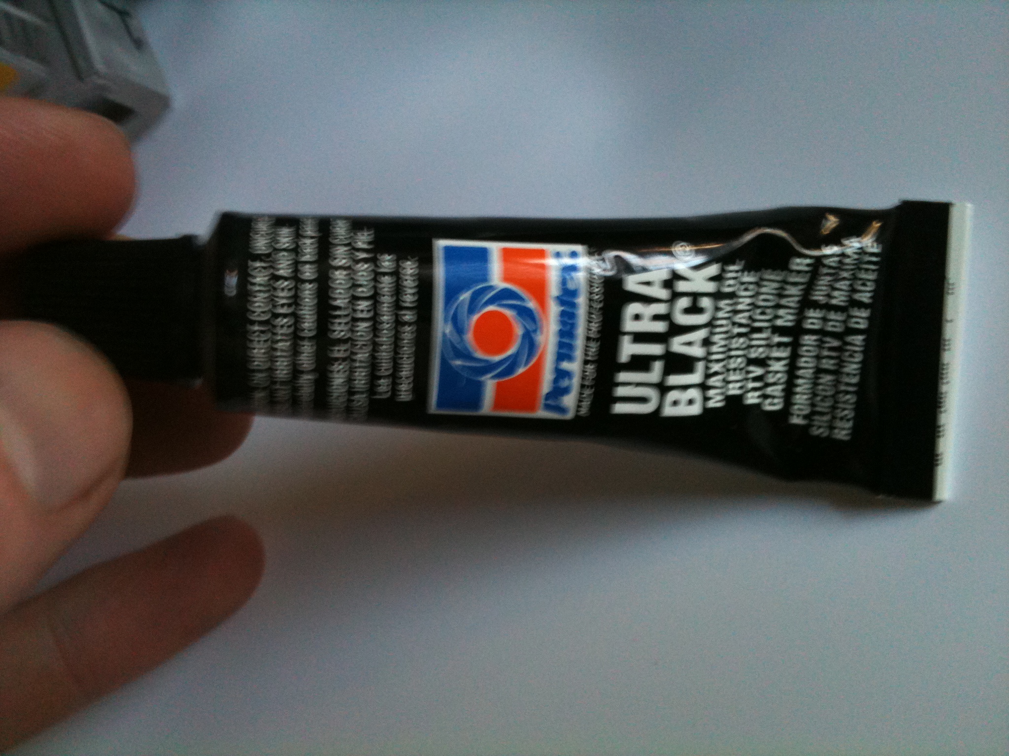

I put in the new O-Rings and used automotive gasket sealant before attaching the heat blocks to the LCS. IMG_0376.JPGBe sure to tighten the screws uniformly so the gasket sealant makes a good tight seal. The repair I did on the broken plastic lead that connects tubing so the coolant can come into contact with the heat block worked like a charm. Another note here is if you use plumbing clamp on the plastic parts be sure that the large part of the clamp, where you use your screwdriver to tighten the clamp, isn't moving the plastic part off center. If you don't have the plastic part screw holes lined up with the metal screw holes in the LCS plate you won't be able to screw the heat block plates back. If you remember that little tid bit then you just saved yourself 30 or so minutes trying to fit a screwdriver or needle nose pliers into the middle of a bunch of metal and rubber tubing to move the clamp.

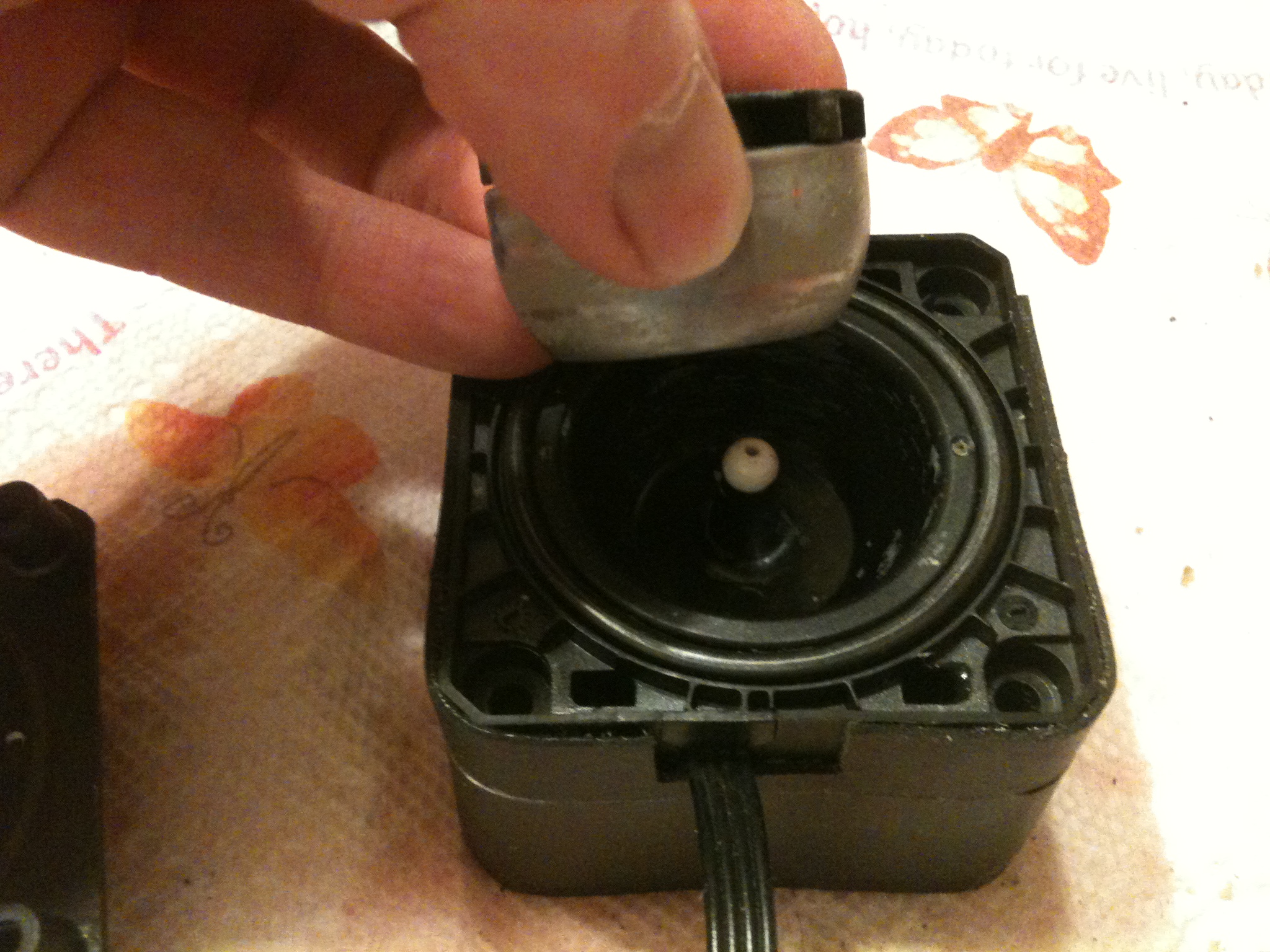

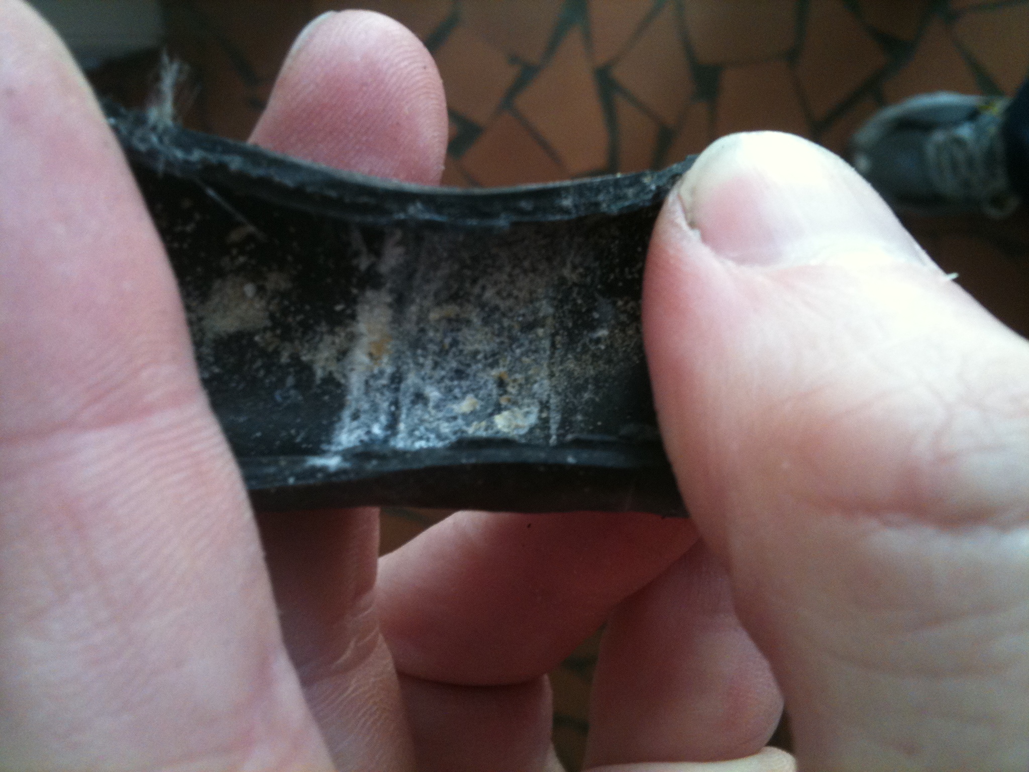

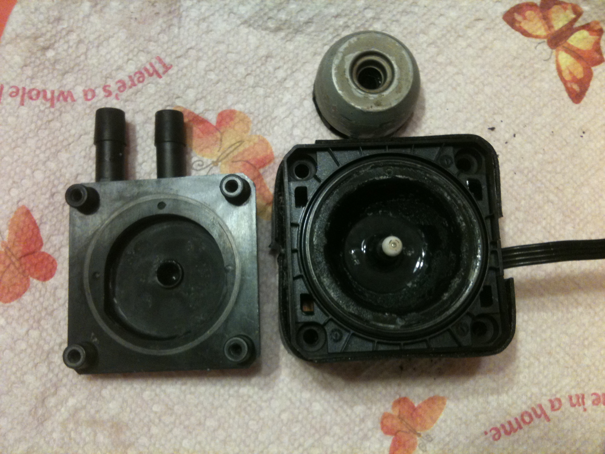

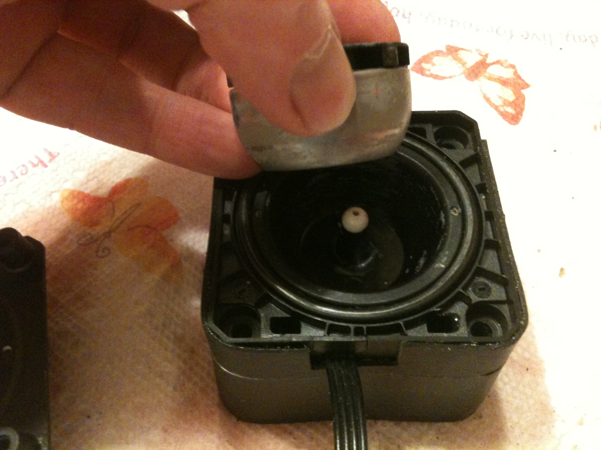

I disassembled the pump to clean it out before putting back onto the LCS. IMG_0325.JPGIMG_0327.JPGRemember that this thread is about a G5 dual 2.5, which has a single pump. ------REVISION: I would apply the gasket sealant also to the pump the next time I do a replair. Couldn't hurt and as long as the pump was open it takes no time add the sealant.----The pump has 4 screws holding on the 'cap'. Inside is a large metal half sphere that is solid and it has some weight. It is magnetically held in place, which is how the motor spins it to move the fluid. You can simply pull it out but the magnet is strong so there will be some resistance.
Upon disassembly there was only some mild 'crust' in the bowl where the metal sphere goes. I just scraped it clean and put the motor back together.

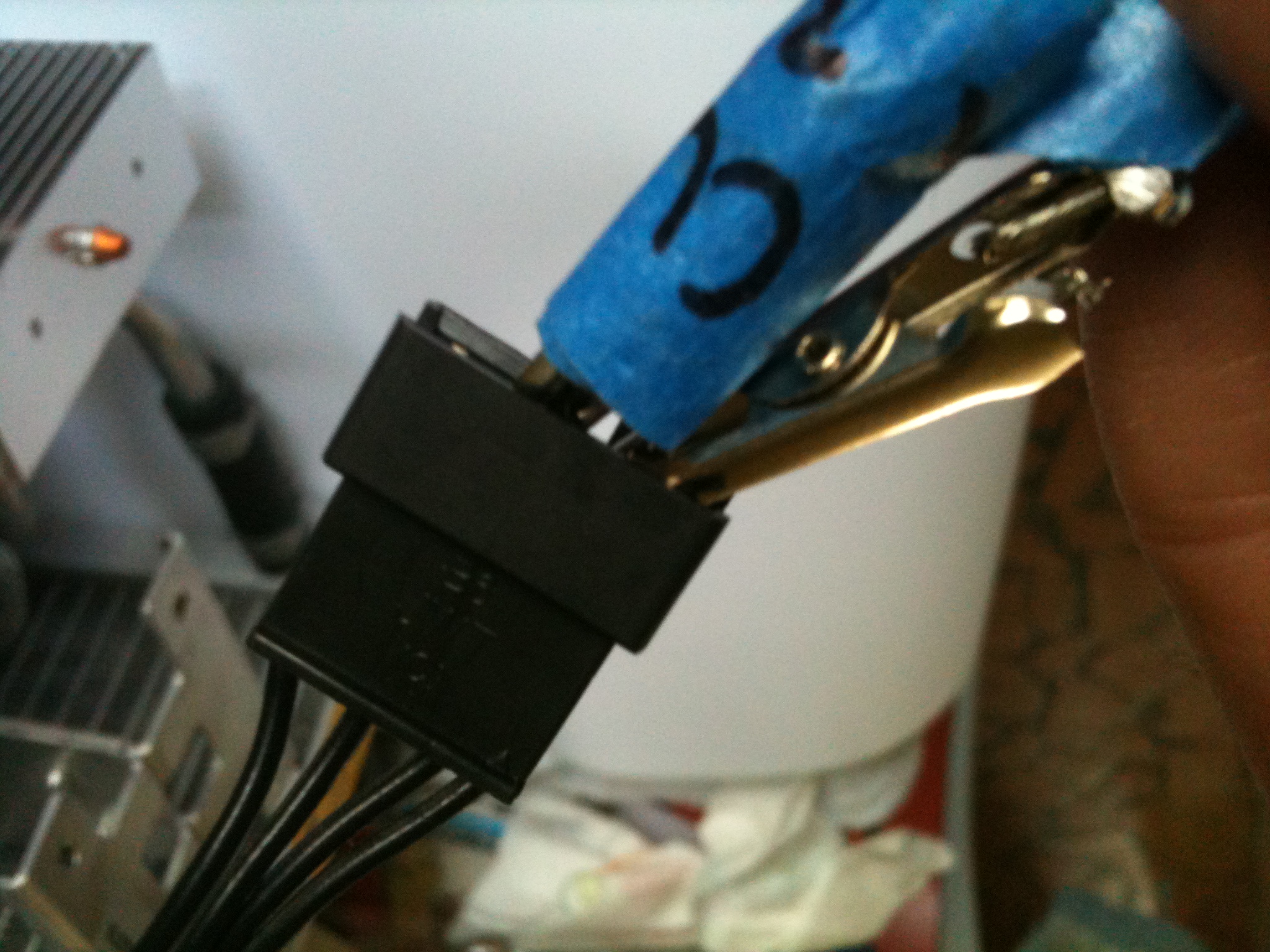

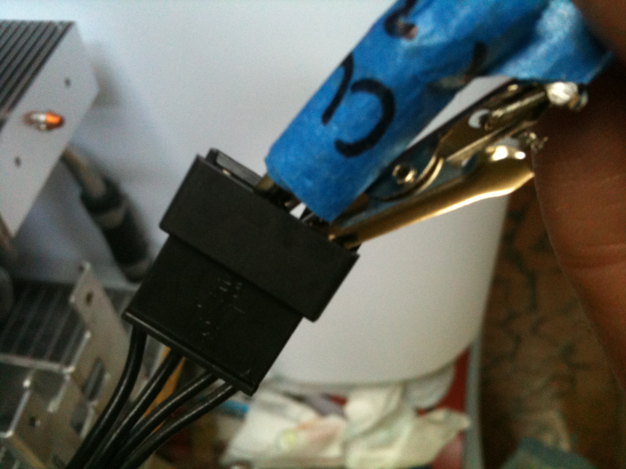

I tested the motor by attaching 2 leads to metal probes in the housing that connects the motor to the computer power supply. In my research regarding how to power up the motor I found info that didn't work for me so I had to figure it out on my own.
I first tried to plug the motor back into the computer and that didn't work. I had an old 12v power supply block that I put small clips on so I could attach the power supply to the motor leads. It was a bit of trial and error but I was able to get the motor to operate.
The motor has a 6-lead connector. Where the wires go into the back of the connector you can see numbers above the wires. Not all the wires are attached to metal leads. I put the clips on 2 and 4. Since I was working with liquid I filled the LCS in my bathroom. I plugged the power supply into a GFCI outlet (it has a test and reset button) that I was able to use as a switch instead of plugging and unplugging the power supply.IMG_0372.JPG

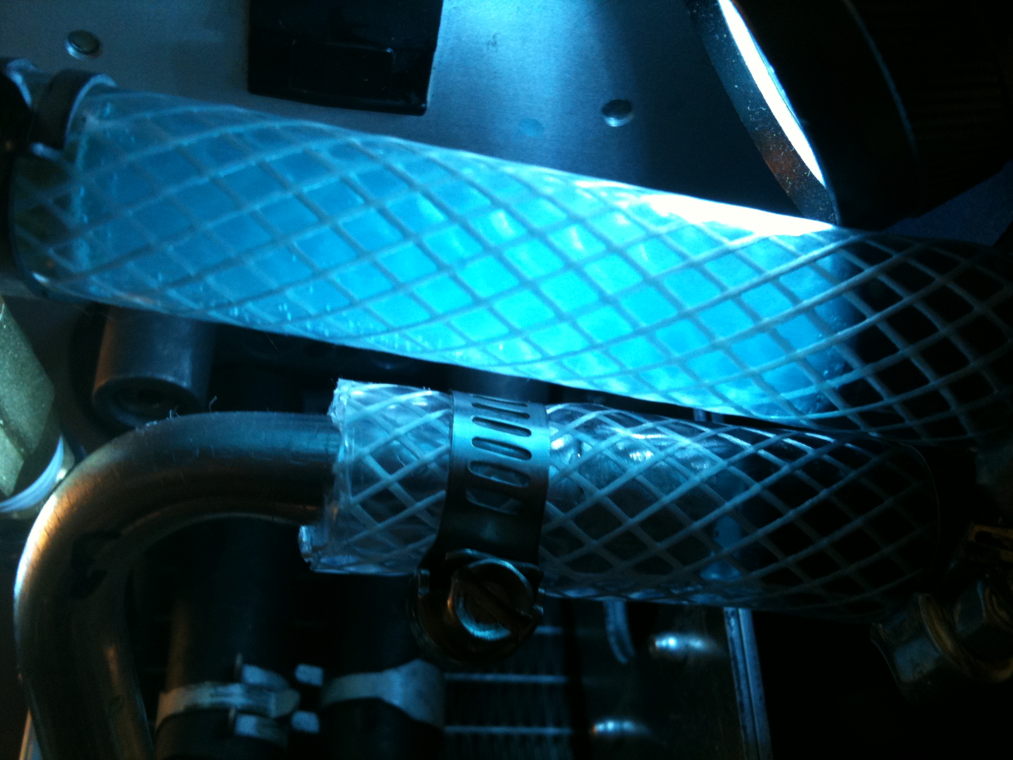

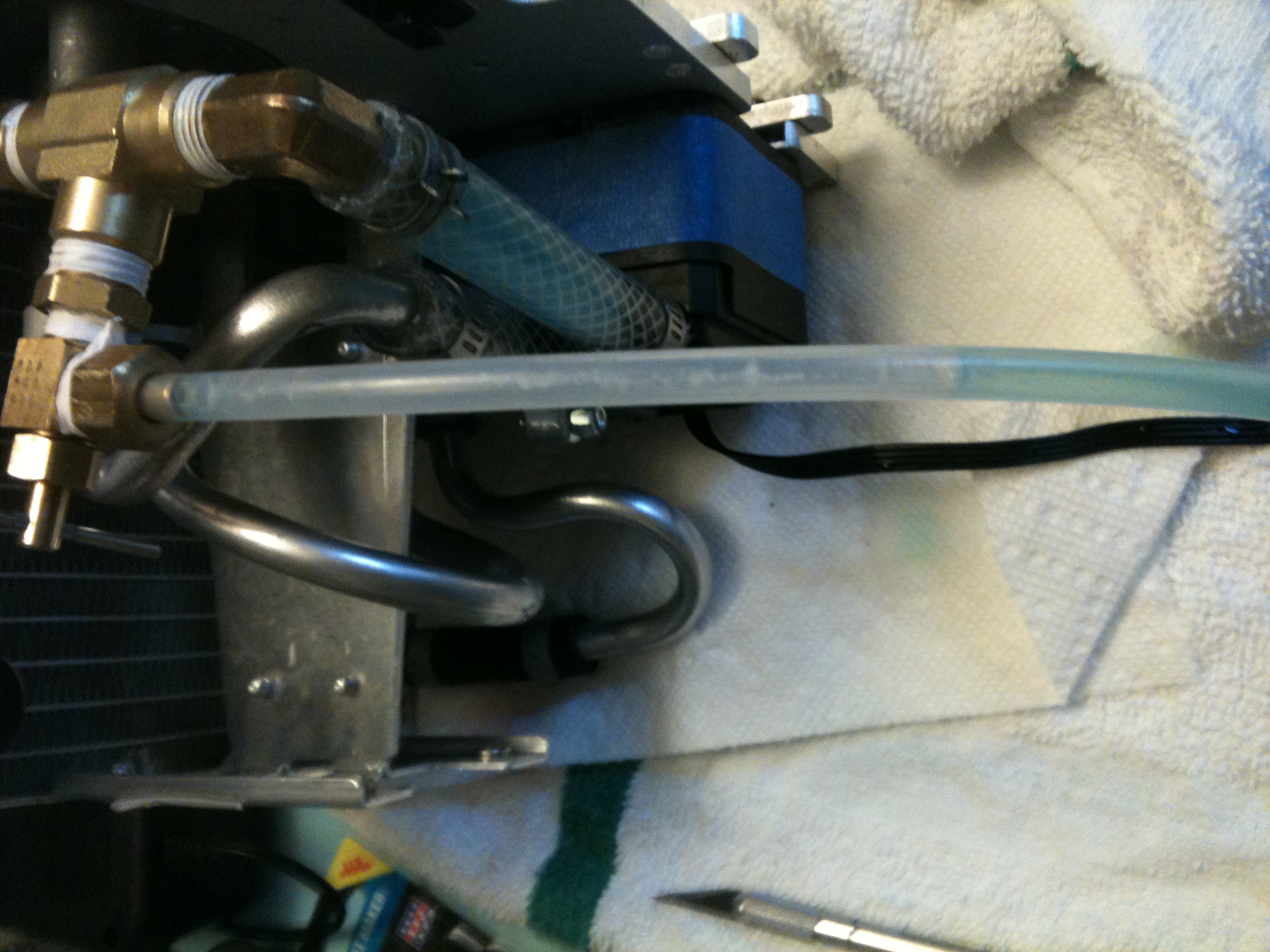

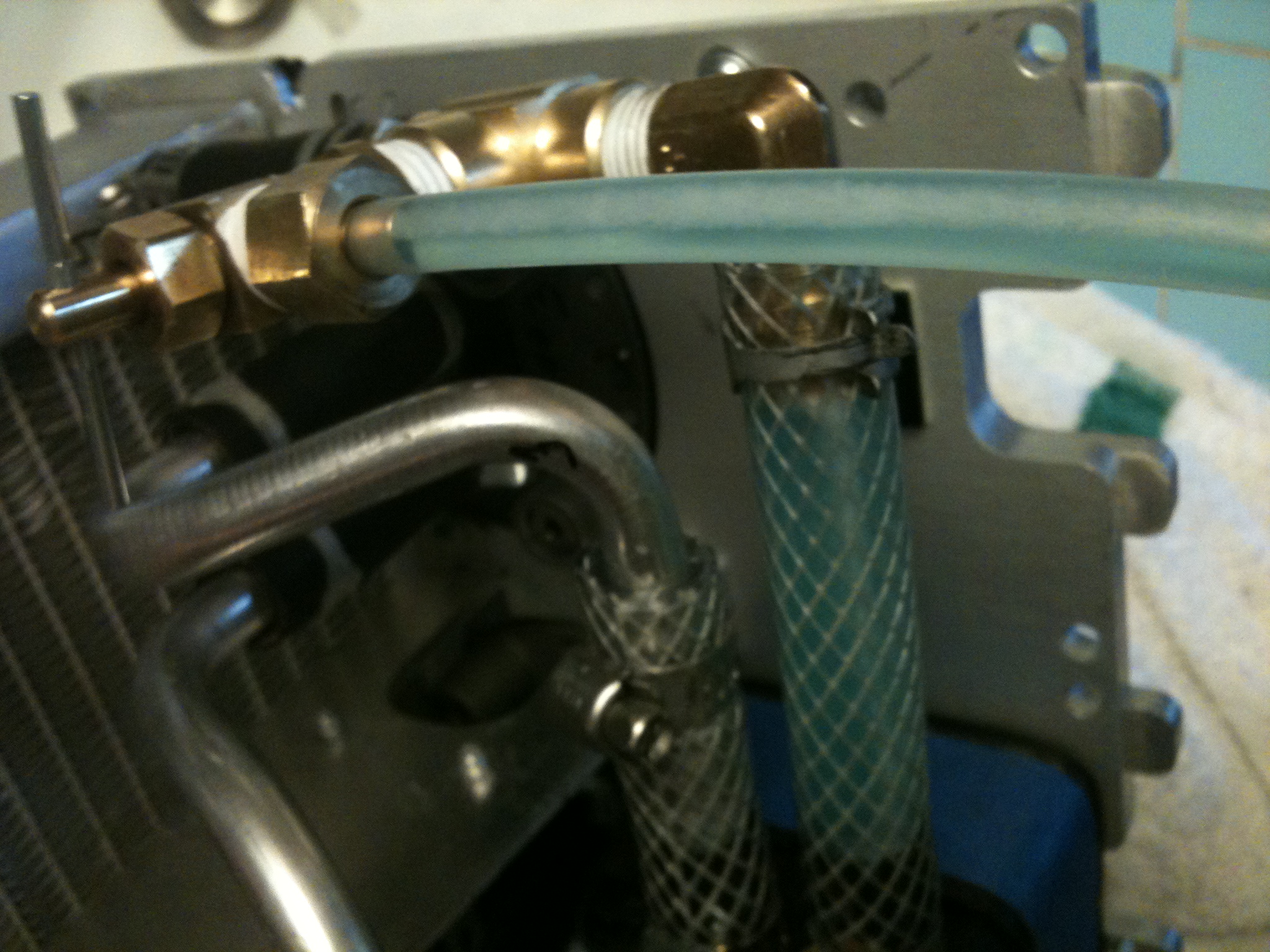

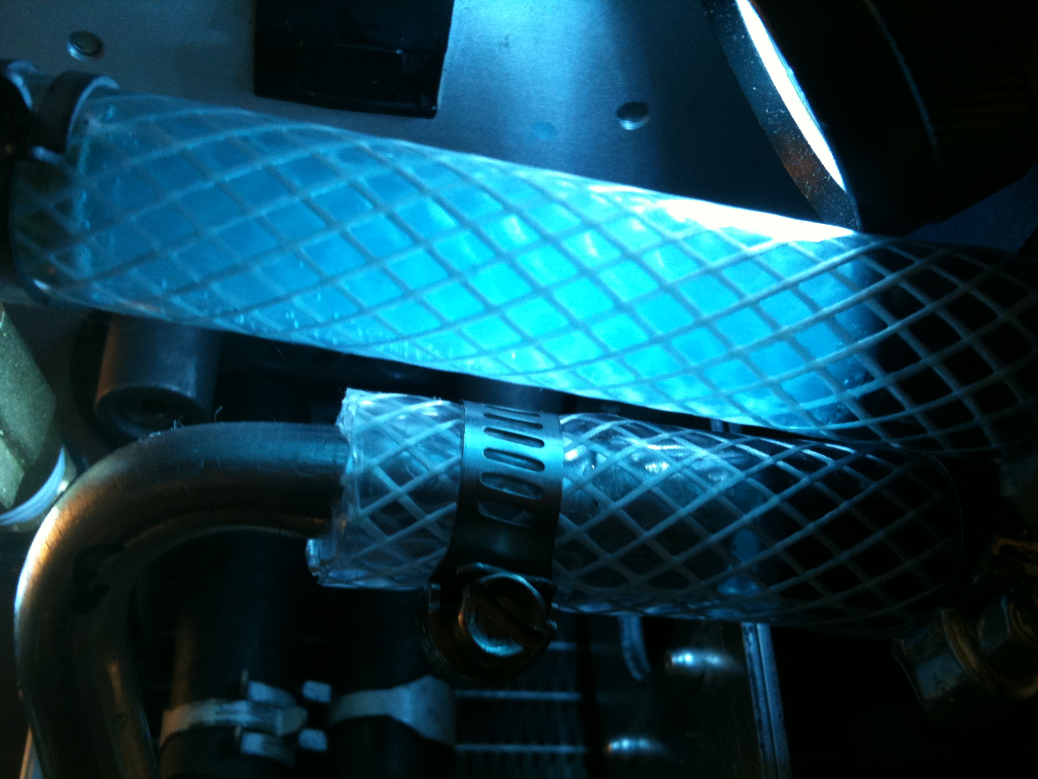

I replaced all the tubing since its cheap and the inside was very cruddy. IMG_0345.JPGI went to my local auto parts store with the old tubing in hand for sizing and got 3 feet of radiator tubing. It is the 3/8" flavor. I also got a foot of some clear tubing that is rated at 175 degrees F and 75 lbs of pressure, which I expect (and hope) is enough. While my favorite industrial supply company, MSC, has clear tubing that has higher temp and pressure rating I didn't want to wait any longer to get my computer back up and running. The clear tubing will allow me to visually check that the coolant is moving though the system.

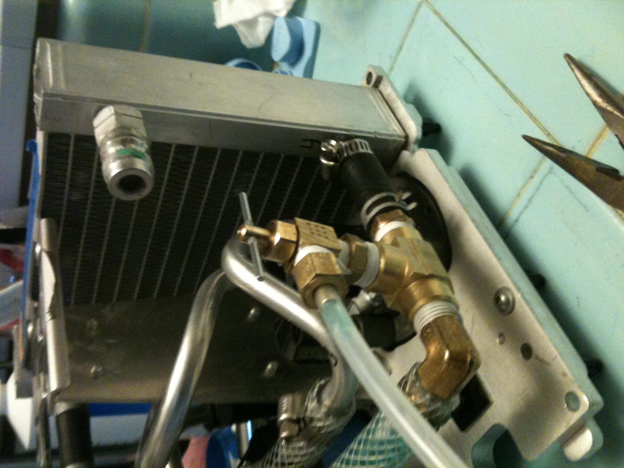

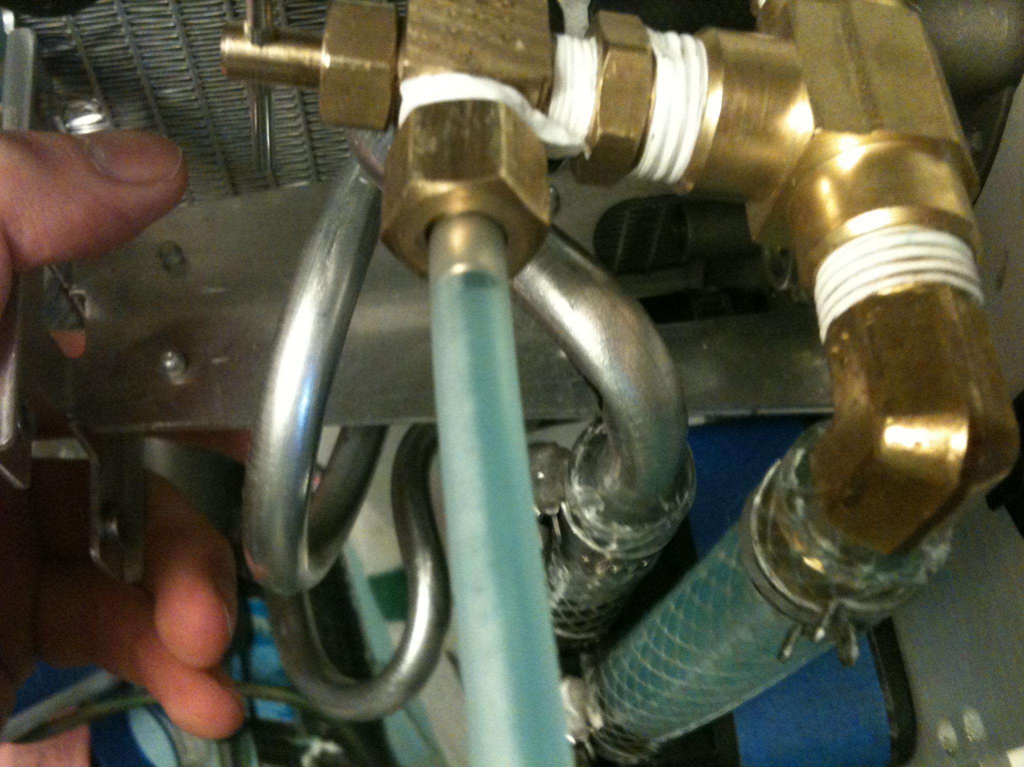

This is where my rebuild takes a turn so I hope you are wearing your seat belt.
As I hope you are able to use this thread as one of many threads to educate you on what others have done and learn from their successes and mistakes. My original concept for my repair was to put a valve inline. I did this using brass plumbing fittings. I went to Home Depot and stood in front of the brass fittings looking for the parts I needed. There are compression fittings and threaded fittings. I found a 3/8" compression-style valve and a standard threaded Tee fitting. The Home Depot guy said the two can't be connected. I was thinking that I was going to have to order the parts but thought I would go to another hardware store and guess what....Ace Hardware had the part that was able to connect the compression valve with the threaded Tee fitting. I attached 1 foot of clear tubing on the valve. More on that later...

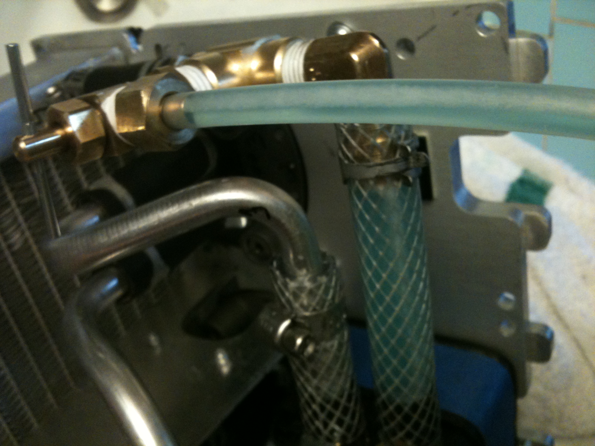

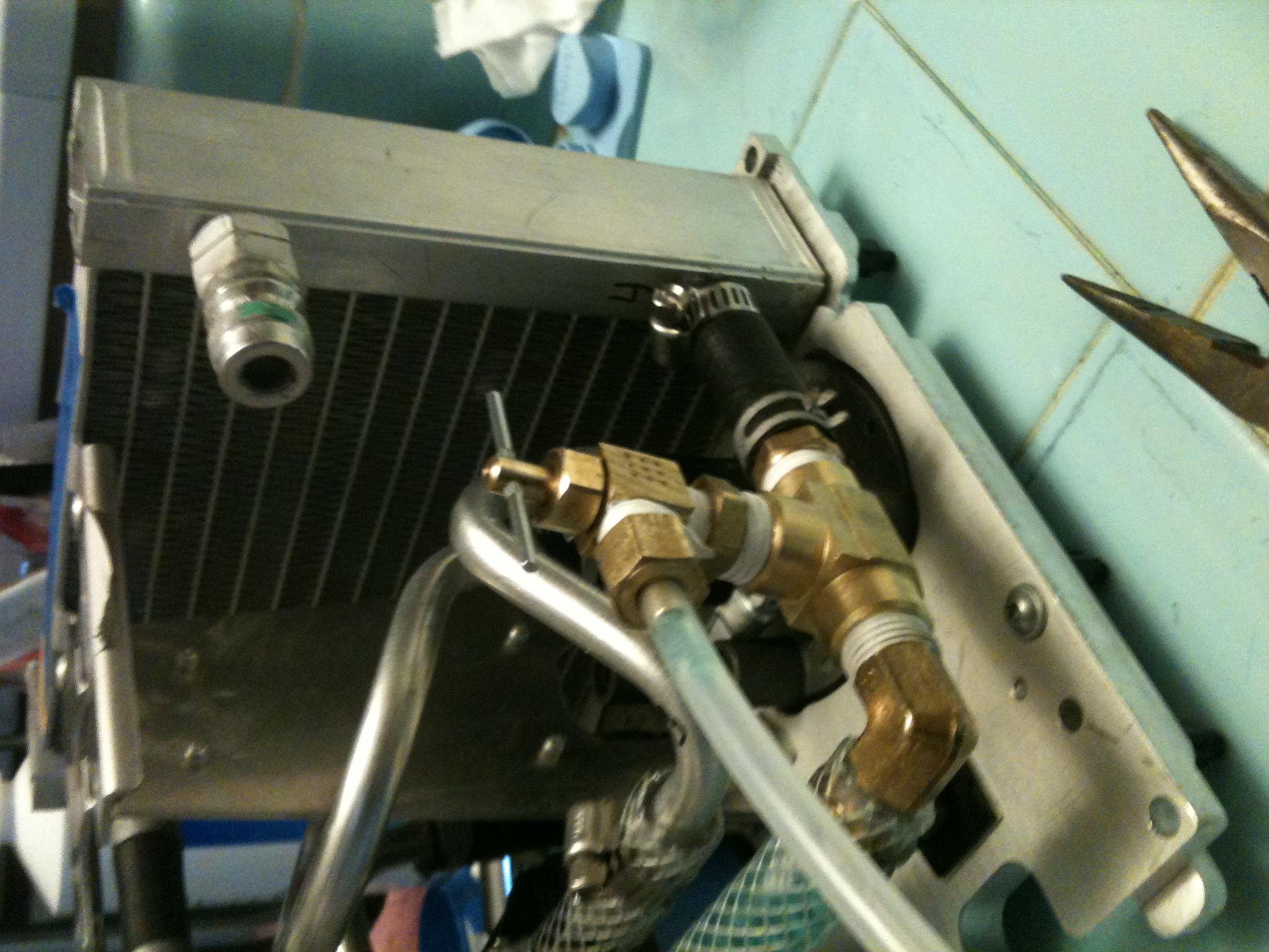

I put 3/8" brass barb fittings on each end of the Tee to connect the Tee to the tubing. I reused the clamps that were originally on the LCS and swopped out some plumbing clamps. Don't forget to use teflon tape on the treads before you attach the fittings to each other for a water tight fit. The threaded fittings are tapered so it will appear that the fitting isn't screwed in all the way since you will see threads after you have tightened the fitting. That is normal and expected. The taper helps to make a tight fit.
Now the tubes and clamps are on, the Tee and valve are in place, with the exception of connecting the tube that comes off the output port on the motor (there is an arrow showing the direction of the flow next to the port). The goal starting was to open the valve on the Tee, attach the coolant bottle onto clear tubing coming off the valve, and fill until there is coolant coming out. I didn't have an aquarium pump to pull the coolant, as seen on one thread, and running the pump didn't pull the coolant out of the bottle that I thought it would. I got a hand pump at an auto parts store but that didn't work as it induced air into the LCS.
I drilled a hole in the top of the coolant bottle so I could easily attached the bottle to the tubing going to the valve. However, I needed to also poke a small hole into the side top of the bottle so I could use my finger to cover the hold when I am squeezing coolant into the LCS and when I release the bottle I would move my finger letting air back into the bottle so I can resqueeze the bottle to put in more coolant. If the air hole wasn't there when I released the bottle after squeezing coolant into the tube it would get sucked back into the bottle.
I have more to add but going to stop for now. My next post will cover using the valve in order to bleed out air from the LCS.
Thanks for reading 🙂

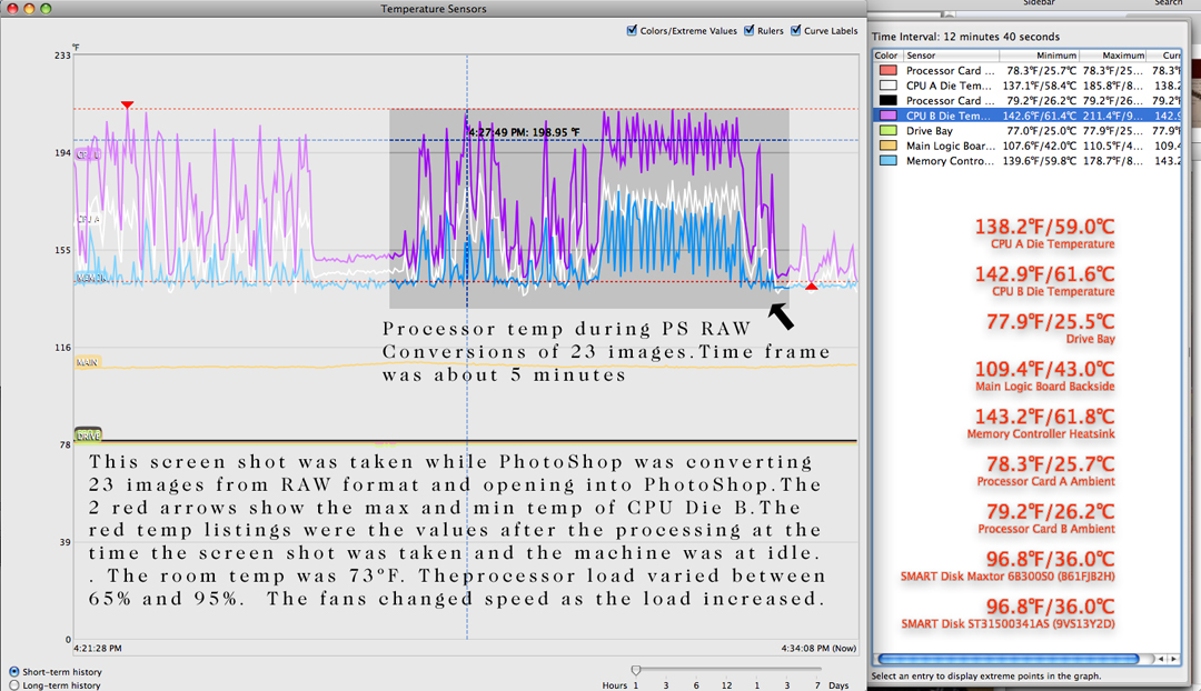

CPU A Die: 99.4ºF
CPU B Die: 101.5ºF
Processor Card A Ambient: 78.3ºF
Processor Card B Ambient: 77.0ºF
These values are from the app Temperature Monitor. The app tells me that the Cooling target temperature is 180ºF. I found that value when I viewed the 'Show System Info' and clicked the 'more info' button.
I can recall operating at temps in the 190-210ºF range!! I guess I am very lucky that my chips didn't turn into charcoal!

Running ASD to do a Thermal Calibration
I was able to do some work and put the computer through some processor intensive tasks. The max. temp. I saw was about 155ºF and that was a peak value. With the processors working at 80%+ for a good stretch while it was creating, exporting, and uploading a website out of Adobe Lightroom the temps. hovered around 135-150ºF. At idle the temps. would drop down to around 100ºF (+/- 10ºF).
I downloaded the Apple Diagnostic Disk (ASD) 2.5.8 from a file sharing site and created a CD so I could boot the G5 to do the Thermal Calibration. The download came with plenty of info on how to perform the test and what to do if any errors come up.
I have a screen shot that I will post later of what the software interface looks like.
It took about 20 minutes to complete the calibration on each processor. The first calibration passed. The second processor gave me an error of Tafs is out of range and to replace the processor. I am running the calibration again hoping with better results. I am going to do some more research on this error and see what it means. So that is where I am at currently.

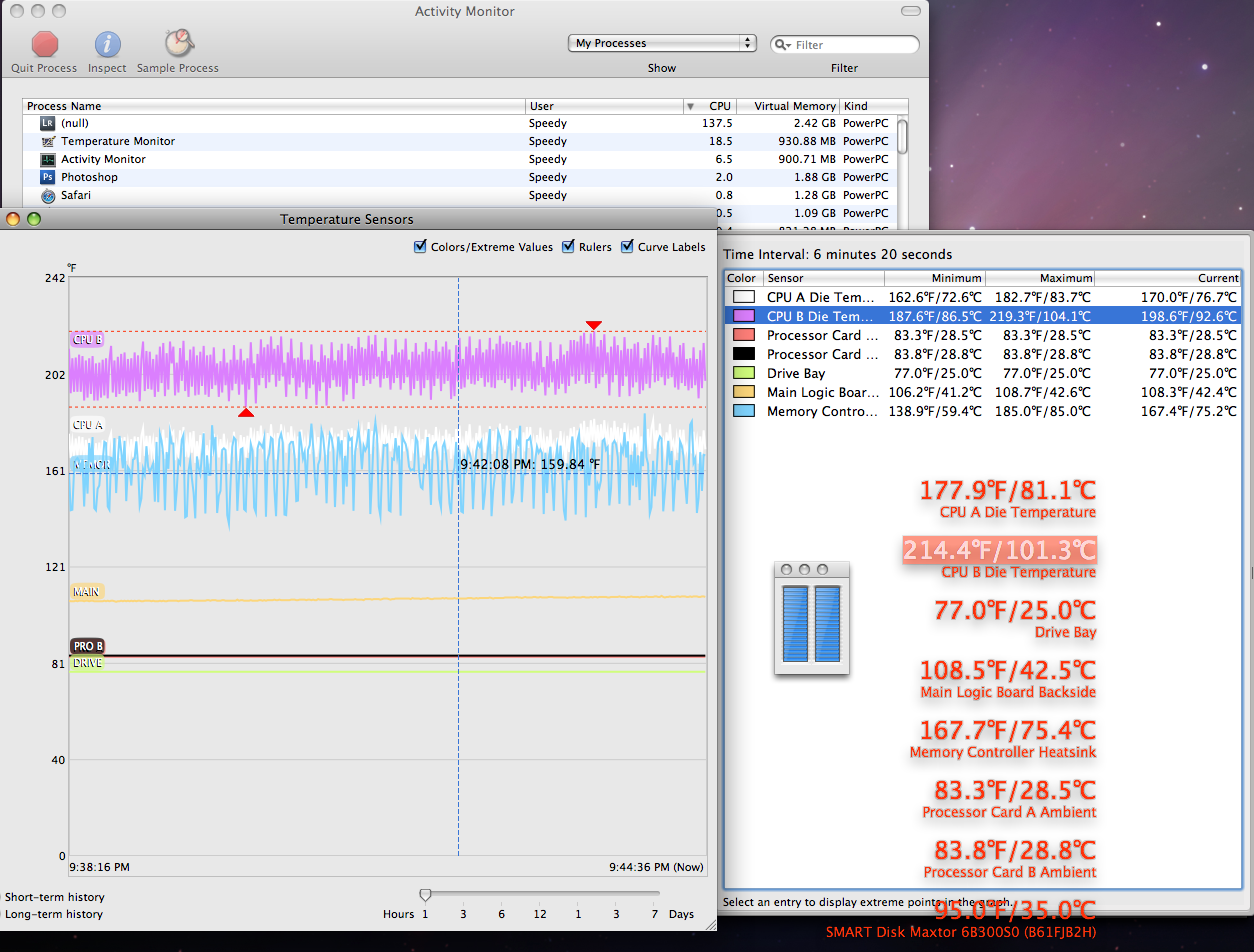

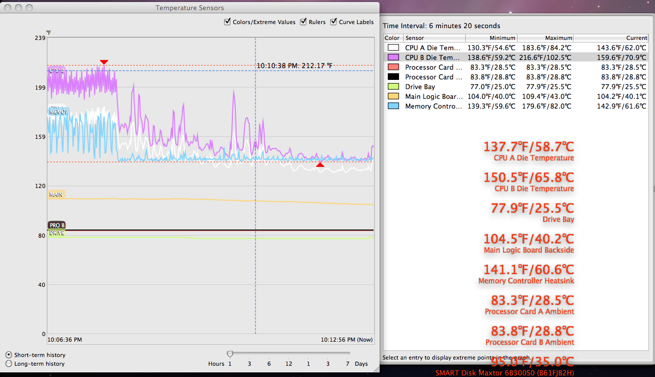

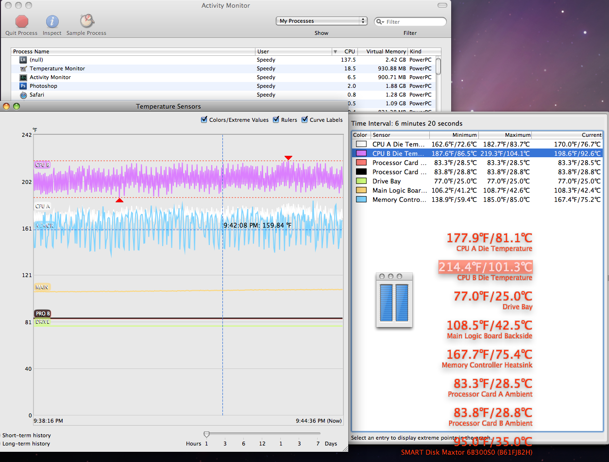

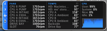

Second try on Thermal Calibration
Well, I guess it is time to clean up all the confetti and send the party band home.
I haven't researched what my 'Tafs is out of range' error means yet but after running 2 passes on the Thermal Calibration my machine booted fine but now the fans are moving very slowly and the idle temps are now around 150ºF for each processors with no apps running except the Temperature Monitor and the Activity Monitor.
The idle temps I posted in a previous entry were lower than the current idle temps because the fans were constantly running much higher than they are now. The farthest forward fan was running on high and the middle and rear fan groups were not as fast or working as fast.
I worked the processors at 90+% for 5 minutes and the temps. were up in the 190ºF range and even spiked over 200ºF for a second or two. At the higher workloads the the fans do spin up and slow down when the machine is idling.
I did notice that one processor was around 15ºF to 20ºF when the temps were up in the higher range. Part of me says that is normal since the coolant has to flow over one processor then the next before cycling through the cooling blades to release the heat. At idle the the processors are within 5ºF of each other.
I am uneasy about the higher temps not completely sure of what the correct range of temps are and when I should begin to worry that something isn't working correctly. If you know of a resource, a link, or even have those values I welcome your input.
---I AM WONDERING IF ANY OF THESE ISSUES MENTIONED IN THIS POST COULD HAVE ANYTHING TO DO WITH MY THERMAL PASTE APPLICATION. THAT MIGHT EXPLAIN THE HIGH TEMP DIFFERENCES BETWEEN PROCESSORS BUT THE COOLANT EXPLANATION FITS BETTER. JUST THINKING OUT LOUD ON THIS ONE-----
Maybe I am just being a nervous nelly and the current temp values are within tolerances or not. But between the error on one of the processors when I ran the Thermal Calibration and now the higher operating temps I am not ready to rest on my laurels just yet.
Its time to mount up and take to the Information Superhighway...UP...UP...AND AWAY!!

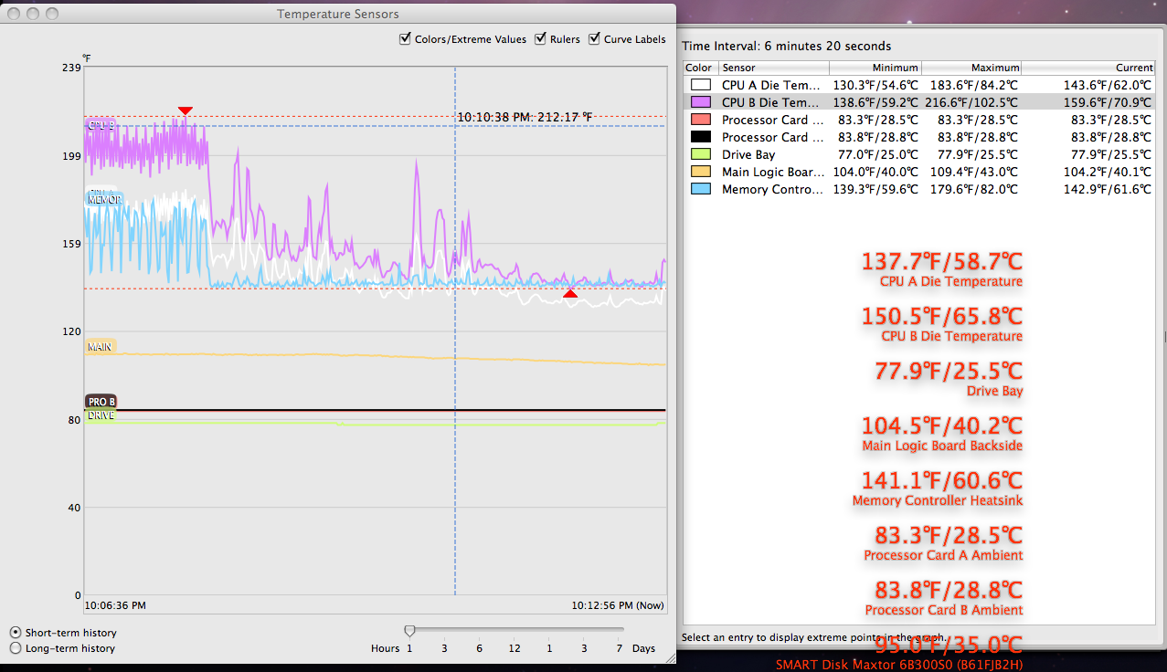

----FIRST UPDATE-----
I went into Energy Saver Preferences and there is a pull down menu for Processor performance. There are 3 settings: Automatic, Highest, Reduced. I was at Highest. I changed it to Automatic and the temps immediately went down 20ºF and are now, at idle, 130ºF (+/- 3ºF). That is a step in the right direction.
When I put a heavy load on the processors for 5 min the temps hover around 185ºF on one and 200ºF (+/- 5ºF). When the load is reduced back to idle the temps return to the 130ºF range.

What thermal paste did you use? like the online documentation? arctic silver 5? I hope you never slaggered the CPU die like they did. It was far too much! Too much is as bad as too little.
Also read up a little on your error...
One thing I can't see mentioned in this thread is the need to have the ambient room temperature below 25ºC (77ºF). The manual explains it a little.
It may be worth running the calibration again (possibly after you strip, clean etc) and making sure the room temp stays pretty stable.
http://discussions.apple.com/thread.jspa?messageID=8489978
I think those temps are pretty high. I folded with my quad for a bit and the temps stayed in the 150-160*F at the very most with all cores @ 100% I believe. 200*F seems very hot to me so be cautious.
You got all the air out of the lines right? Oh and running a thermal calibration is really only needed when switching CPUs/logic boards. Just changing the O-rings shouldn't have mattered but doing the TC is necessary I think if you are having problems like you mentioned.
Somebody has similar temps he has with a dual 2.5.
http://discussions.info.apple.com/message.jspa?messageID=10271285
CPU A Temp - 55.1C/131.3F Min - 93.1C/199.5F Max
CPU B Temp - 49.6C/121.4F Min - 80.4C/176.8F Max
Powermac G5: What are normal temperatures?
I think these ones were air cooled?
http://mac360.com/index.php/mac360/comments/why_is_my_powermac_g5_so_hot_really_its_hot
You have to take the CPU out as if I remember correctly it's part of the heatsink. Plus you can't rerun the thermal calibration if it's successfully done and passed. I tried it once on mine after reading some people saying the calibration can *sometimes* fall out a little.
It wouldn't let me calibrate mine as it said it wasn't needed.

So I did some research and didn't get my answers about the Tafs error when I did the Thermal Calibration.
I did read about the ambient room temp effecting the temp so I am cooling down the room to see what that does for me.
I also was going to run another Thermal Calibration but the software said I didn't have to. "Thermal Calibration is valid no calibration required." I read that someone did 3 tests and on the third test all errors on the earlier tests were gone.
I didn't want to press my luck since the fans do have variable speed at different processor loads.
So, now I just want a definitive answer to the normal operating temps and what the top end is so I don't fry my machine.

Adding more photos for reference
I didn't realize until I started to add photos that I can only add 5 per post. So these photos are the photos of the new plumbing fixtures I incorporated into the LCS.
The first photo shows the compression valve fitting. Underneath the valve is a connector that allows the compression fitting to connect to the brass Tee fitting. On both sides of the Tee where the tubing is connected is where the brass barb fittings go. The white that is visible at each connection is Teflon Tape. All parts were found at various local hardware stores. I always like to ask questions of the sales folks to get their ideas on projects. They will sometimes know of a better item than the one I think I need. Case and point was one sales guys told me that compression fittings and brass fittings can't be connected together because the are different 'types' of fittings. I went to a second hardware store, shared my dilemma, and not only did he know that I could get a compression valve to connect to a brass fitting, he had the part! There is a more detailed description in the earlier post dated 3/16/11 titled "LCS refilled and tested for leaks."
Photos #2, #3, #4 show air inside the tubing. In photo #2 you can see very small bubbles. In photos #4 and #5 are shots of the small tubing coming out of the valve. The way I would bleed the air out of the system by having the LCS turned on its side just like it would live inside the computer and opening and closing the valve to release the air. By doing so would allow the bubbles to exit the system.
I had to experiment on how to get the air out. Here are some ideas that didn't work:
--don't try to suction out the bubbles. I would put the small tubing into my mouth and suck on it like a straw with the valve open then close the valve quickly after I couldn't suck any more out either because I would pull the coolant into my mouth or the suction was to great. While I was able to pull the coolant out with air bubbles the negative pressure was strong enough to pull air into the system. I figured this out after a couple of hours of using this technique. My best guess that the negative pressure was pulling air from the pump gasket seal or from a connection on the top of the system.--
--I also tried to use negative pressure from the coolant bottle. Remember that I put a small hole in the tip of the bottle so I could allow air to enter the bottle by moving a finger off the hole after the bottle was squeezed. I would squeeze the bottle, attach it to the tubing, open the valve, and allow the bottle to return back to normal, which would pull coolant and air from the LCS. Same issues as sucking with my mouth...pulls air into the system and we are trying to get air out.---
--I would run the pump with the valve closed. The pump would make a 'sizzling' sound as air moved through. I would cut power to the pump (by tripping the GFCI outlet) and in less than a second I would see a large bubble rise from the pump towards the valve. Before the bubble would reach the valve I would turn on the pump (by resetting the GFCI outlet) and open the valve immediately. The bubble would leave the LCS and come out the tube connected to the valve. See photo #4. While I was able to get the air out this method didn't seem to work. This method led me to the final approach that proved successful.---
I added a step to the description listed above of running the pump with the valve open so the LCS would equalize the pressure inside the system with the pressure outside. Once that was achieved I turned off the pump, closed the valve, and put coolant into tubing. I would then power on the pump, open the valve and the coolant would be pulled into the LCS. I repeated this adding of coolant until no more coolant was pulled into the system and some stayed in the tube that is connected to the valve. I would close the valve and turn off the pump still leaving coolant in the tubing.
When the pump shut off I would see a bubble rise from the pump towards the valve. With the pump still off I would then open the valve first then power on the pump. The air bubble would 'burb' out of the valve and be visible in the tube (See photo #2) I would tap on the tubing to get the bubble to rise through the tubing until it was released. As I would be tapping other air bubbles would come out on their own and I would tap those bubbles out as well.
Now that the system was equalized and coolant was still in the tubing I could see bubble leaving the system. As more air is taken out of the LCS the coolant in the tubing would be pulled into the LCS, replacing the air that was removed. When the system needed more coolant I would power off the system, close the valve, and add more coolant to the tube going to the valve.
I would repeat this method until I felt most if not all the air was removed. If I started with this method of bleeding out the air I think it would take at least an hour not including having the system run with the valve closed for 15-30 min at a time to allow smaller air bubbles to combine to make larger and to check for leaks.
Tilting the LCS in different angles while the pump was running helps to release air. I did the tilting toward the end of the bleeding off of the air.
Air bubbles would be visible in the clear tubing where the flow of coolant was going into the pump. They would just sit there and not move while the pump was running. Cycling the pump combined with tilting with the pump on and off helped to get those bubbles to move.
As the pump becomes much quieter as more and more air is removed from the system. In the final stages of the bleed process I would run the pump for longer stretches of an hour or two (with the valve closed). When I started a long run the pump may be 'sizzling' because of some air inside but when I returned the pump would be whisper quite. I would turn it off and leave it until morning and continue to bleed out more air.
I knew I was finished when I couldn't see any more air in the clear tubing and the pump wasn't making that sizzling sound. Since the LCS as been in the machine and under 'working' conditions of heat and running for hours and hours the pump is still quite and no visible bubbles seen in the clear tubing when inspected with a light shining on the tubing inside the computer.

Screen shot of Temperature Monitor
Here is a screen shot of the readings from Temperature Monitor as Photoshop was processing files. You will see in the darkened area that the temp did spike up to around 210ºF/100ºC but was only there for a fraction of a second.G5 LCS repair-screen shot of raw processing-small.jpg
Click on the photo to see a larger version in a new window.
Heavy Processor work
Here is a screen shot of my machine exporting files out of Adobe Lightroom. The files are camera RAW files (about 13 MB each) and they are having my file adjustments applied, then resized, and converted to JPEGS. There are 283 files in total.
As you will see from the screen shot with loads hovering around the 90+% range for 5 minutes (the time frame visible in the graph) the temps over around 180-190ºF for CPU A and 195-215ºF for CPU B. This is by far the heaviest load I have placed on my machine since the repair.
The ambient temp in the room at the time of the screen shot was 73ºF.
You will also notice at the top of the photo the Activity Monitor data how much "CPU" each Application is using.
The screen shot below is of iStat which is a widget. You will see the fan speeds, internal temps, and CPU usage. I am not clear as to where iStat gets it temp data from or how frequently it updates because the CPU and fan values change every second.
When you compare the values between Temperature Monitor and iStat the following values are equal:
Hard drives
CPU A Ambient
CPU B Ambient
Logic Board
Drive Bay
It's only the temp values that don't read the same between the 2 apps. The manual does say that some PPC Mac are not supported but I suspect that if they were not supported they wouldn't show up in the widget.
This final screen is shot shows how quickly the temps dropped once the export was completed. The spikes represent me working within the app moving around the 'Ruler' that is over the graphical lines before I took the screen shot. The long stretch of lower temps is the machine in true idle and I took the screen shot in this post very quickly before the temp spiked.
The machine returned to the idle temps within a matter of a few seconds. To me that indicates the LCS is doing its job well by removing the heat off the processors efficiently.
So now the question becomes...which are the correct temp reading?
