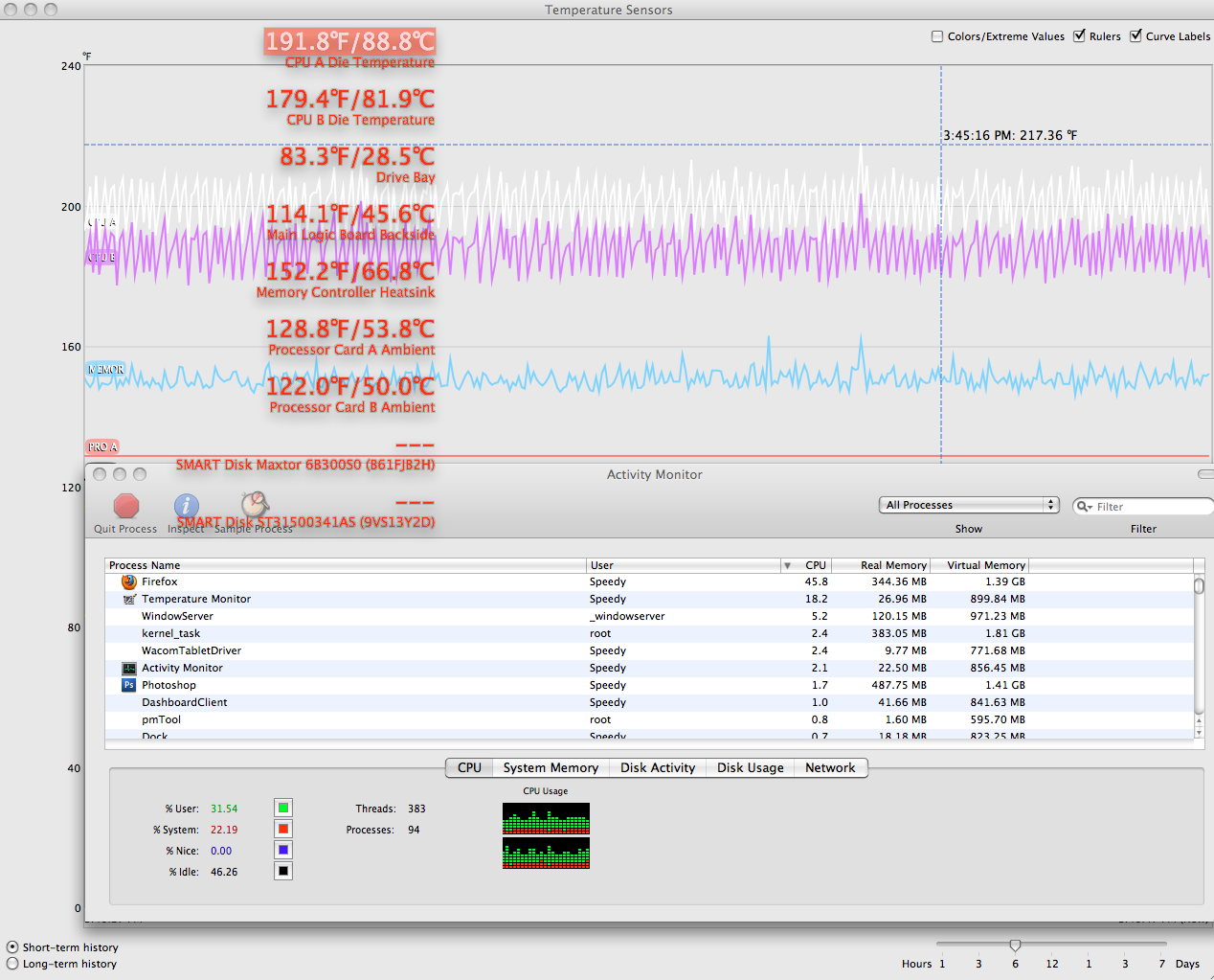

I was re-reading this thread and noticed the posted images of the temps and see that my CPU B was the hotter of the two. Now it is CPU A.
The attached photo will show that the CPUs are running at approx 50% and the temps range for CPU A 190-205 and CPU B 180-192. The average difference between the 2 is usually around 10 degrees.
I have checked inside the machine, as I do periodically, and there are no signs of leaks and with the clear tubing installed I can see that there is coolant and it is flowing. I did notice a while ago that the color of the coolant when it was installed into the LCS was blue. Now it is a light brown but still clear. I suspect that any corrosion that was inside the radiator was dissolved and that is what changed the color. Unless the coolant is suppose to change color. Eitherway, there is an obvious change in the color.

I am going to swop the location of the processor cards on the LCS and see what happens.
