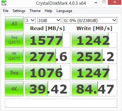

Windows 7 or Windows 8? AFAIK Windows 7 with IDE drivers works only on internal SATA 2 ports of the cMac Pro. Mine is running on port 1. If you have AHCI you can use SATA 3 PCI-E cards for the Windows SSD drive.
Windows 8.1, tested with CrystalDiskMark.
I haven't tested if I can boot Windows from my Sonnet Tempo Pro yet. I am waiting for Windows 10.
@Synchro3

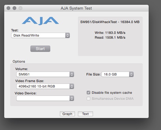

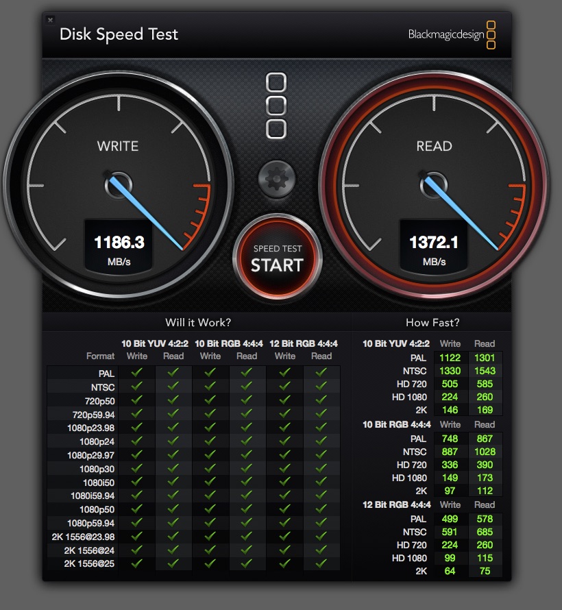

SM951 256GB benched in Bootcamp AND OS X. Windows in the lead on read and write speed.
