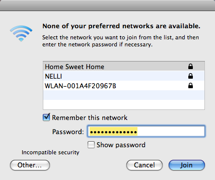

Did the update - but problems remain: the password ist not being accepted when logging onto the the Airport Network.
In the attachment you'll find the dialog bbox stating: "incompatible security" after entering the password and clicking on join...
The Update *did* help find more networks, but did not solve the l/p issue.

upps, forgot the attachment.
here it comes....
http://att.macrumors.com/attachment.php?attachmentid=89102&stc=1&d=1193564202
However if i go through the "Assist me -> Diagnostics" procedure the password will be taken in the dialog box below..
Then everthing works fine... until I have to log onto the network the next time. 🙁
http://att.macrumors.com/attachment.php?attachmentid=89104&stc=1&d=1193565254
