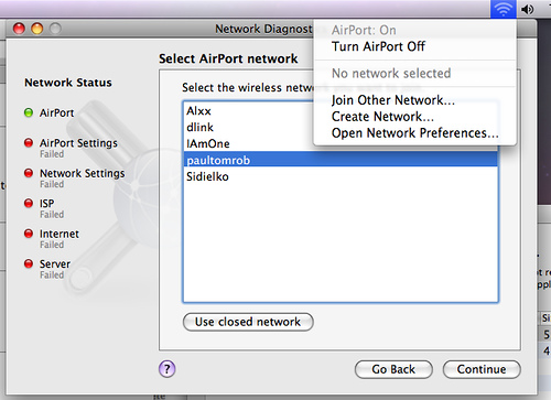

Update: Having browsed Apple Discussions I looked at Safari's "Network Diagnostics" weird thing is that ALL the networks show in that list:

annoyingly, the networks flicker up if I randomly decide to surprise my airport by clicking on it, but then disappear again, and I can't find them.
I can get to them through network diagnostics, and the "assist me" thing, or by manually typing the name of the network ++ it's pwd.
