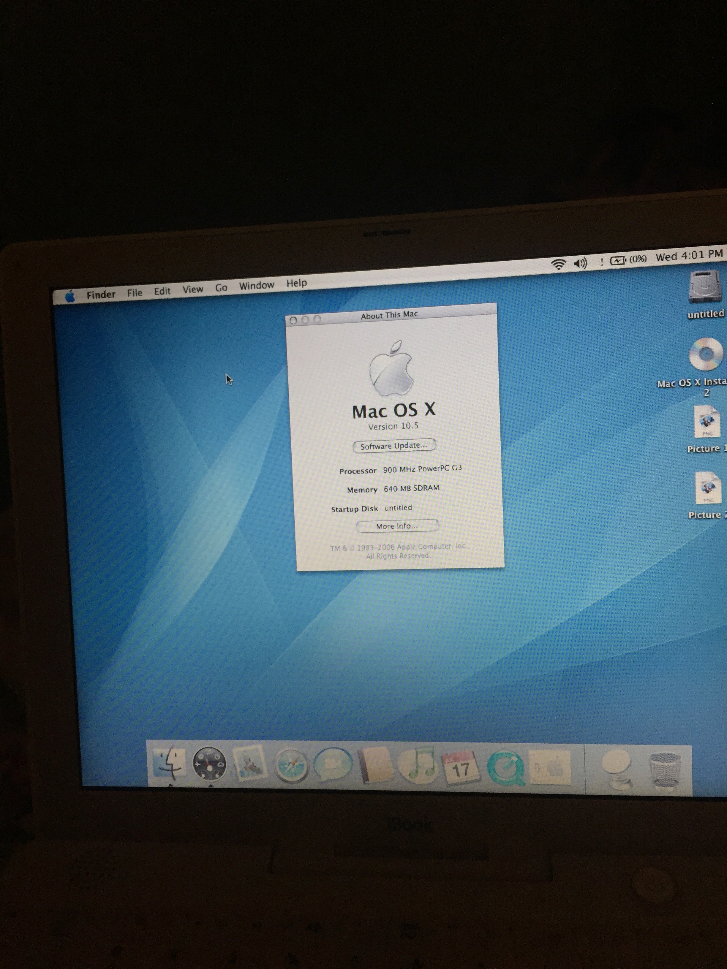

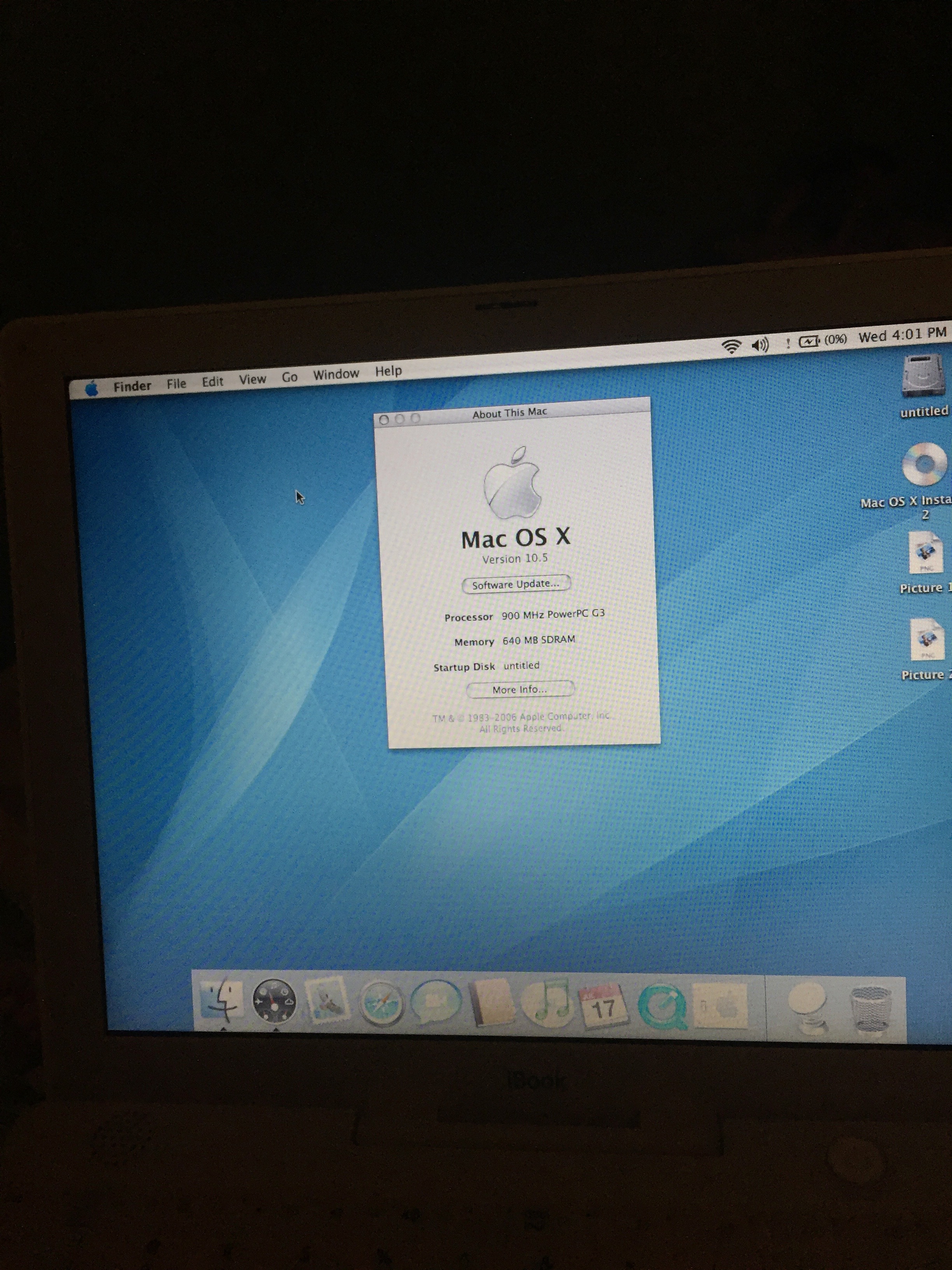

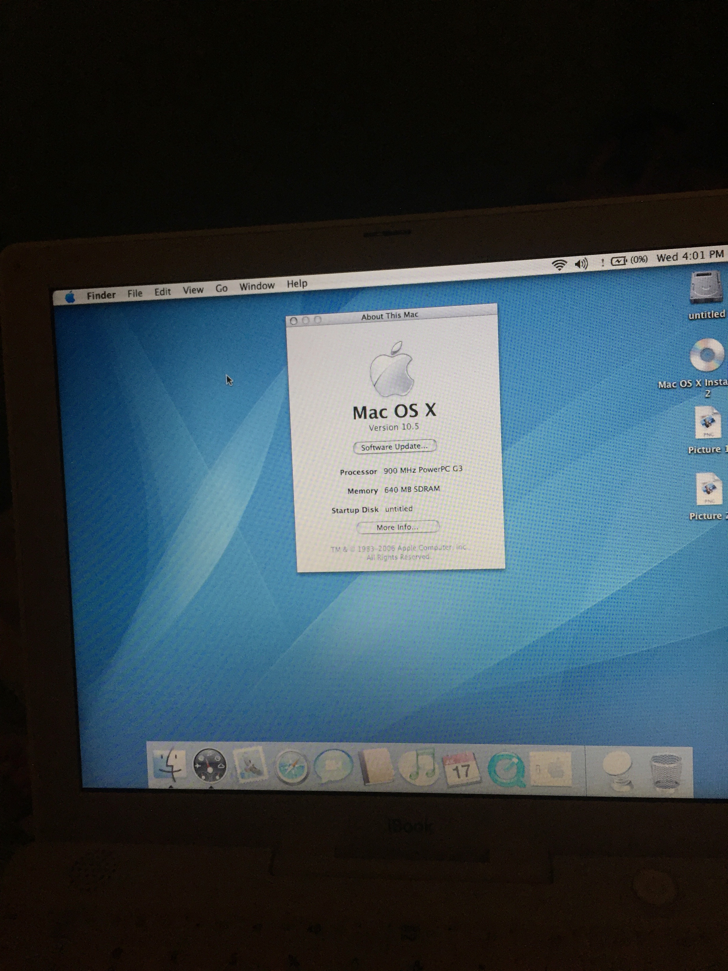

A 700mhz eMac was actually my first PPC Mac, and I ran Leopard on it for a while. As far as I know, these are effectively the same machines-if nothing else they at least have the same GPU. At the time, I didn't even know about optimizing, but I did not find it to be particularly cumbersome to use. That was also before I knew about Leopard Webkit, so used TFF as my primary browser on it.
Tone down the eye candy for faster UI response, but otherwise I think you'll be pleased with how it runs.
