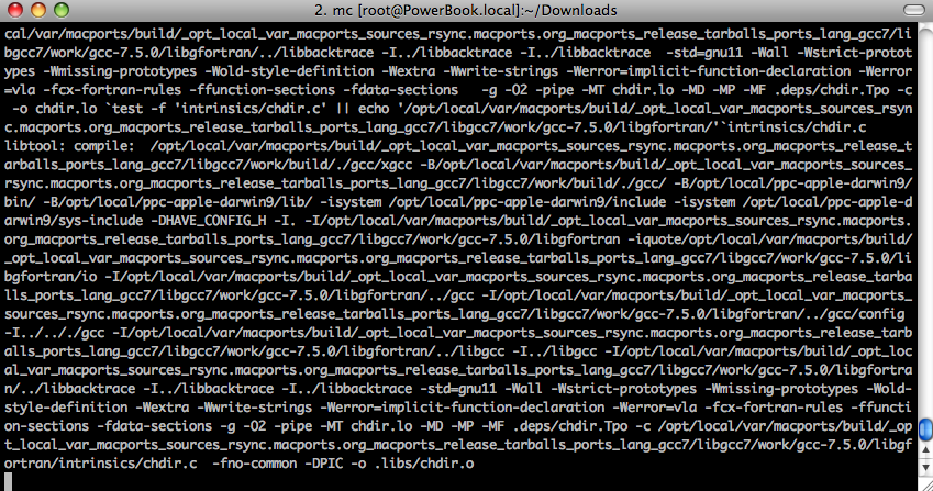

That's odd, because for the last 25 hours my powerbook has been building gcc 7.5 because apparently libgcc7 is needed to build gcc4.9 (i need 4.9 for a different project), and i'm using straight stock macports.
Yeah, I built gcc7.5 on Tiger a couple weeks ago, from the official MacPorts tree. (I was admittedly on Intel.)
Ok. However on my powermac i just ran:
port search gcc7 and 7.5.0_2 is available along with libgcc7 7.5.0
Currently stuck on building a dependency for gcc48 'ccloog'. I've attached the build log. The steps I've taken so far are above in the first post.
