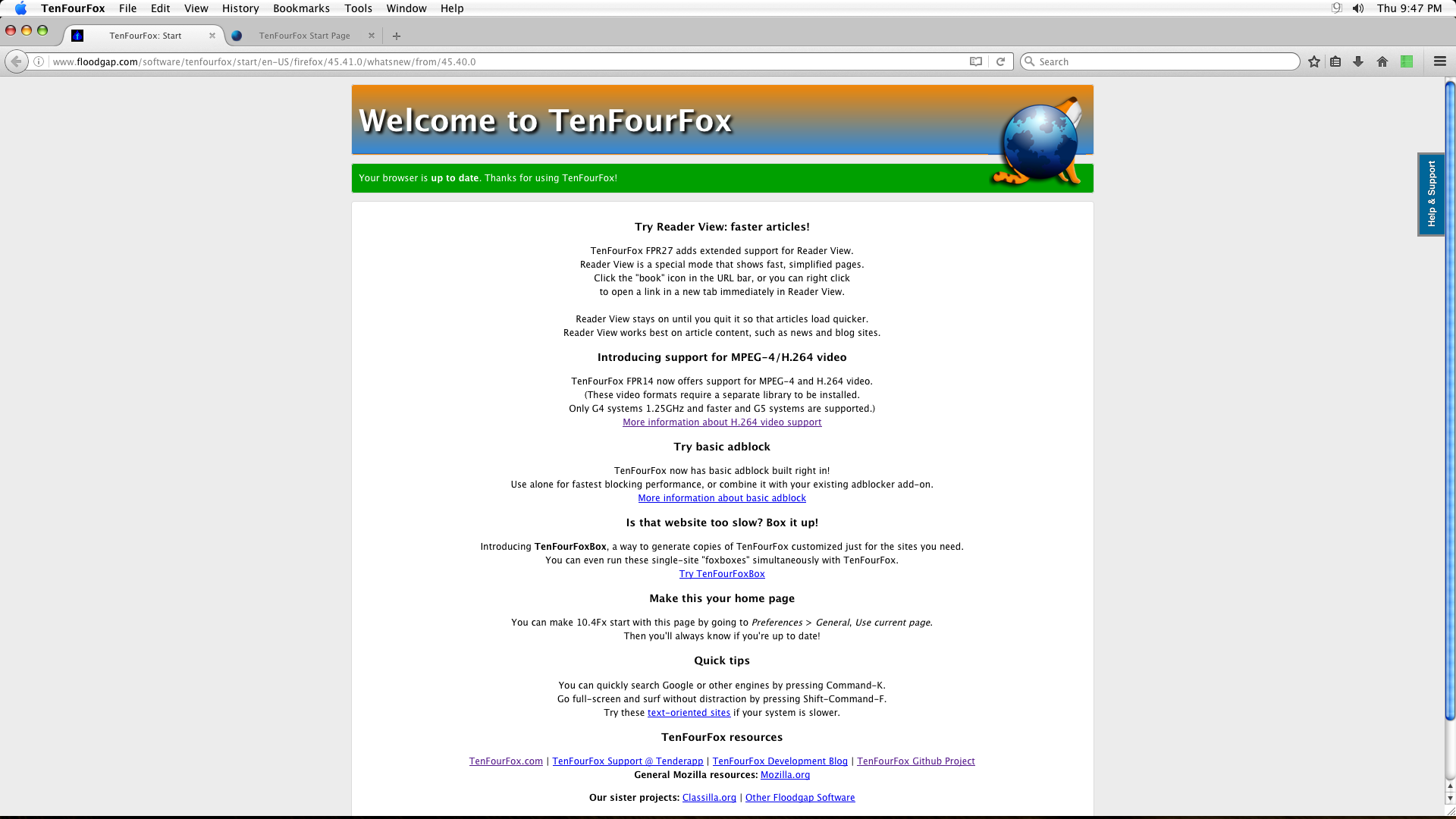

First TenFourFox build attempt. Trying to make sense of these errors:

Success! I’m not sure what the build errors were about but I rerunning it a couple of times got it through. Now I’m scripting up the Macports environment I used for distribution.
Nice. You may have just run out of free memory during some linking stages. Rerunning probably freed up enough to get it to finish. 4gb ram is the recommended minimum to build (and more is obviously even better).
