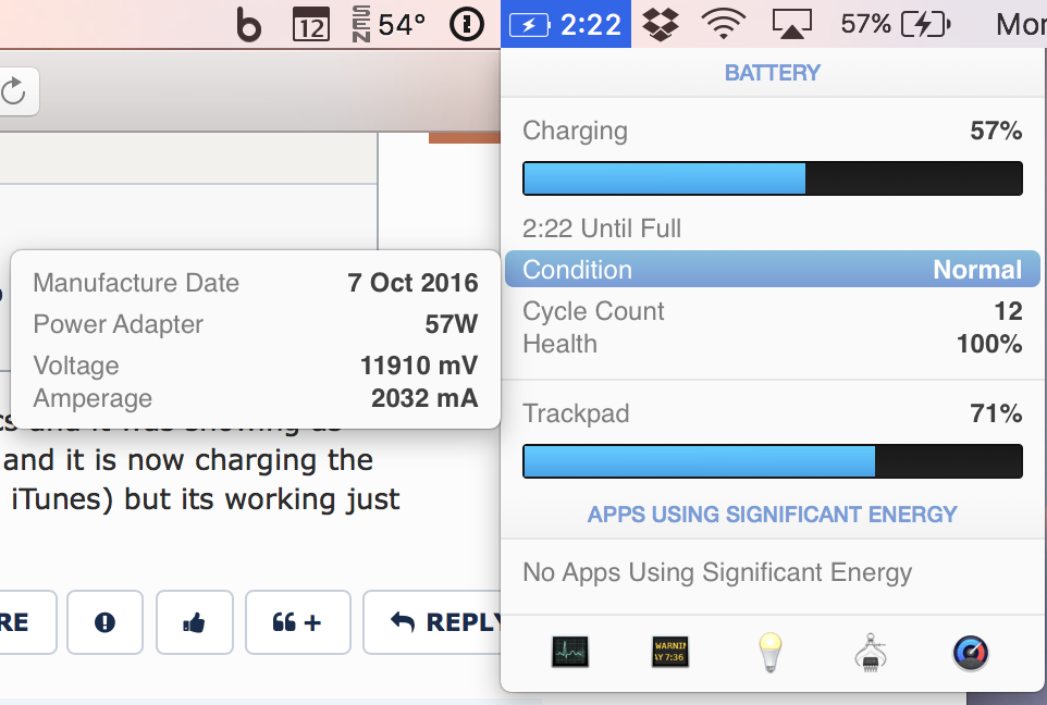

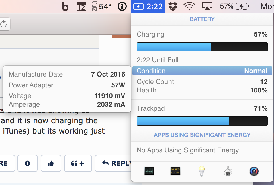

This actually worked! I had the same issue. 15" MacBook Pro 2016 with the AMD graphics and it was showing as been connected to power but not charging. I reversed the Usb-C cable that came with it and it is now charging the MacBook Pro. I am doing nothing that is very processor heavy (email, web browsing and iTunes) but its working just fine.
I haven't tried the cable reversing trick.. (though I will, the next time I get 'not charging'). My trick usually involves simply, unplugging and plugging the USB-C cable a few times until the charging starts. I know that you need to wait what seems like 30 seconds for the cable negotiation to start. Another note to point out, when I use the apple supplied USB-C cable in the monitor, it powers every time, but a video feed doesn't register.
That being said, 57W seems to be enough to keep the battery charging even with all the apps that I have open (Xcode, Sketch, Safari, Slack, Spotify, iTunes, source tree).
