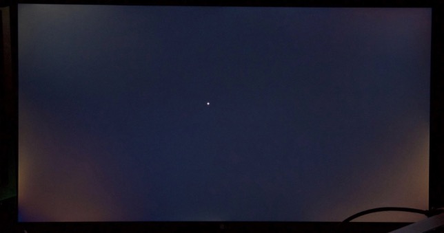

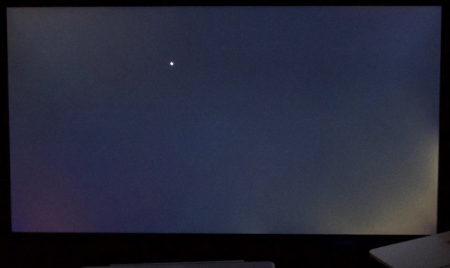

I've bought an LG 31MU97 too. After I've got the first model, I noticed overheating issues and very impressive backlight bleeding. So, I decided to ask a replacement, but also the new one was a bad unit. Both were, sometimes, flickering when connected to my MacBook Pro 2015 and they were produced during August 2016.
Here is the images of both LG 31MU97 during black screen test. Have you tried to do a similar test to yours?

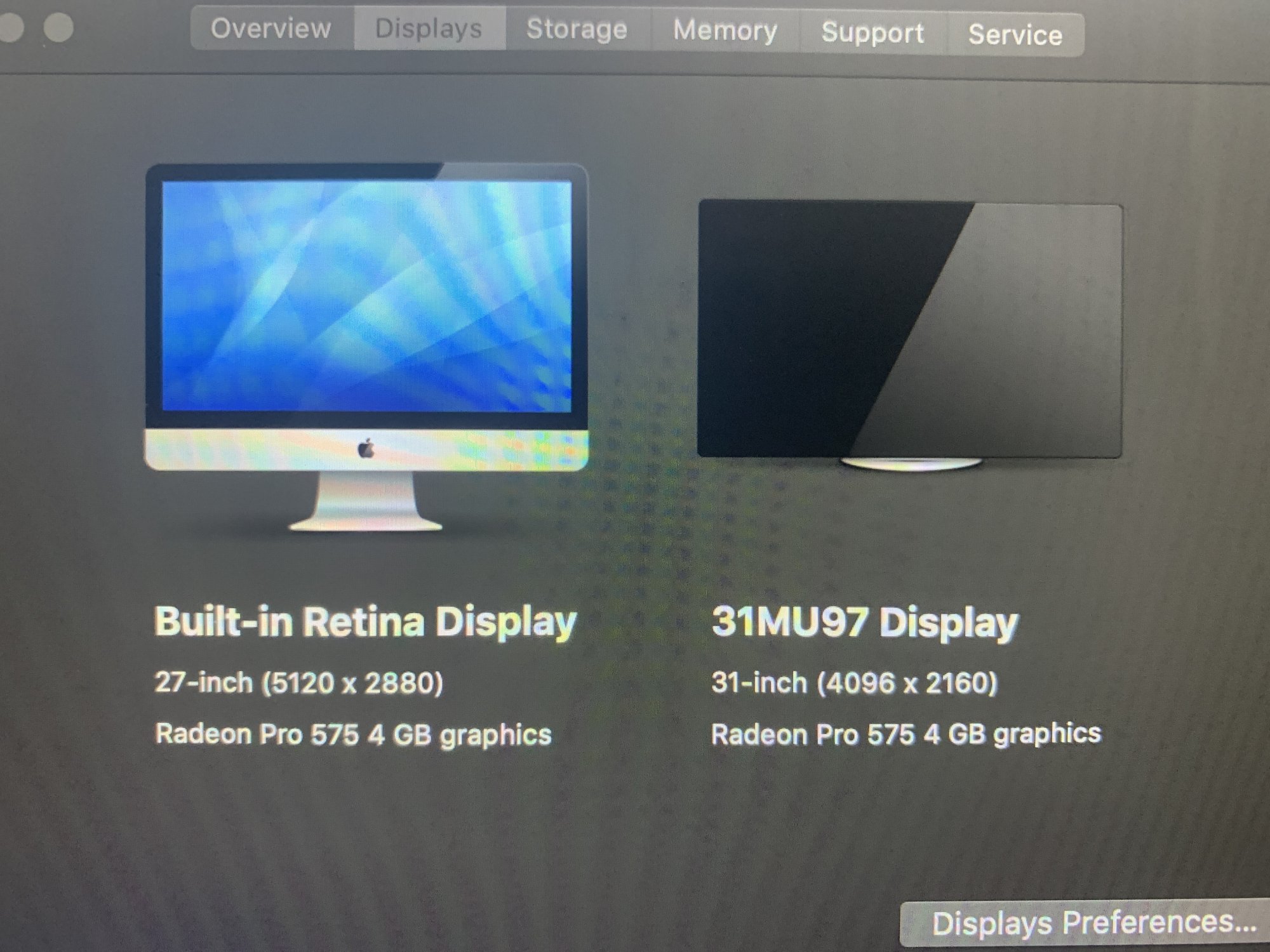

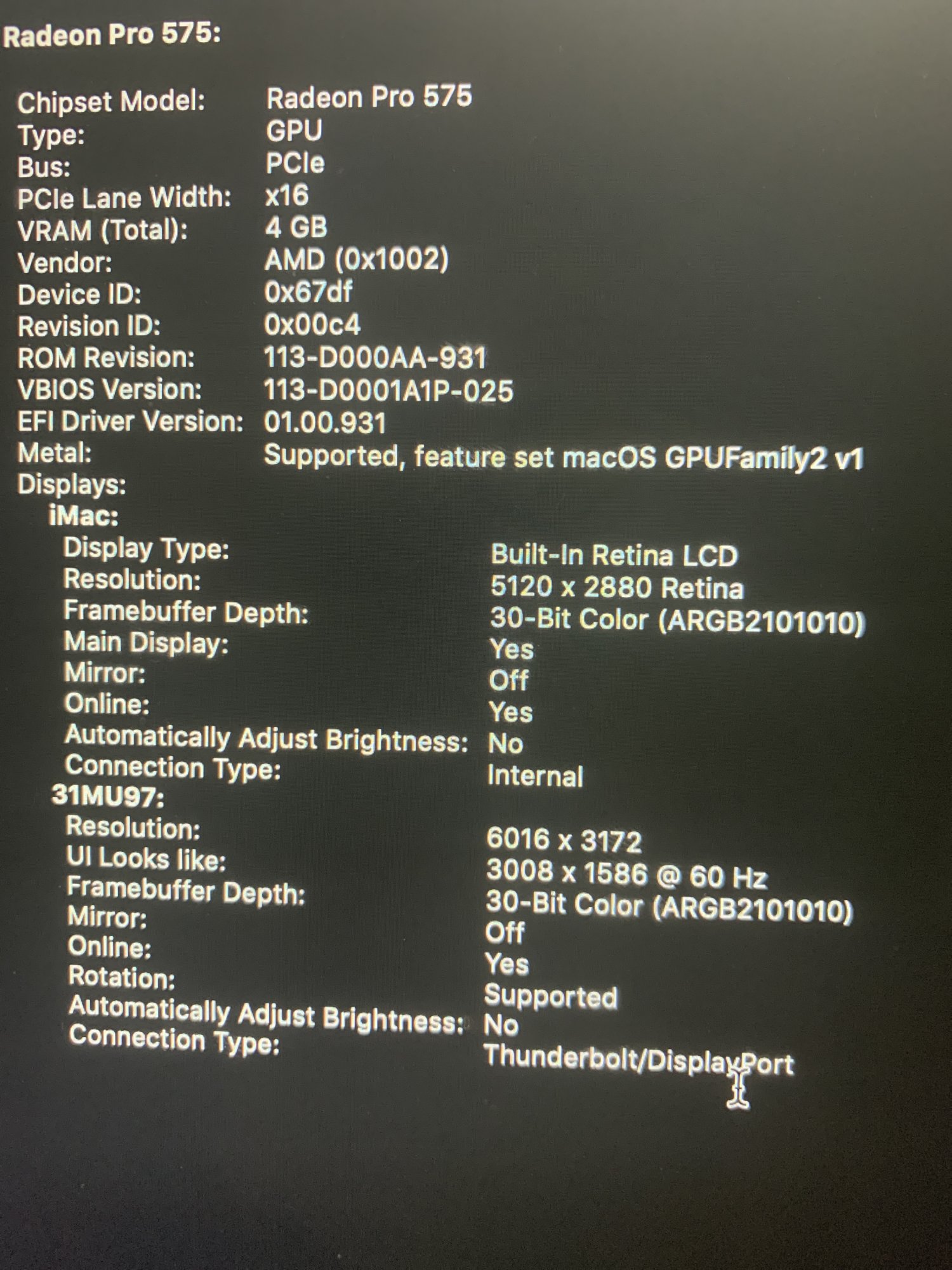

Got the 31MU97 4K display to run at 60hz at full res from my 2017 iMac (4GB VRAM)! I got the Moshi USB-C to displayPort cord (5k one at 1.5m or 5ft)
