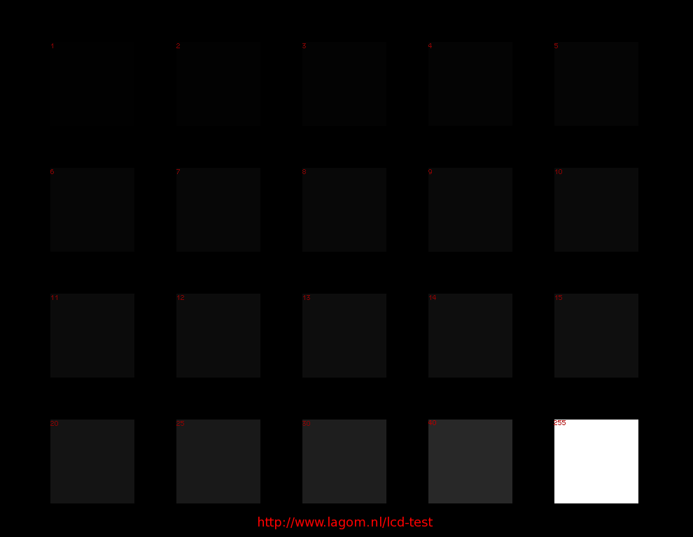

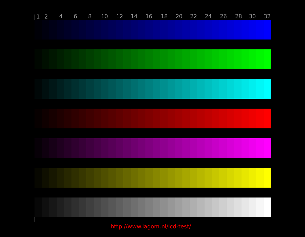

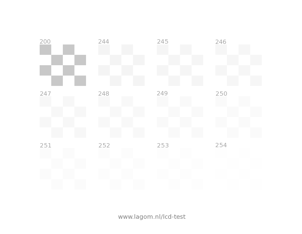

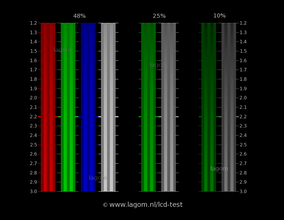

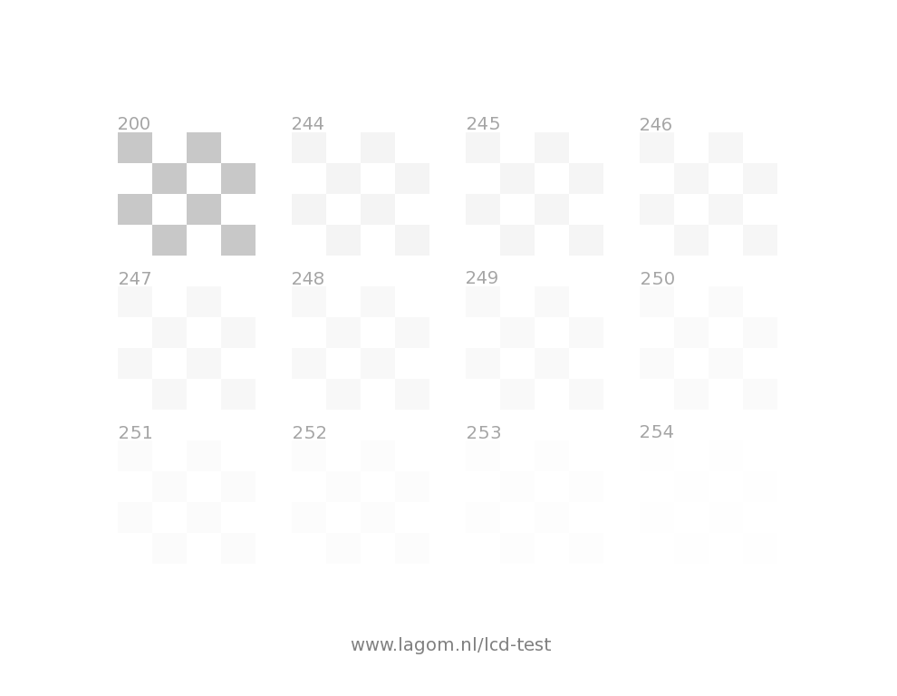

So far I have tried all the profile on this thread and the best is still my original factory icc file. I use the images from http://www.lagom.nl/lcd-test/ and download to the Air to avoid Safari`s color processing. I have attached the file for those that want to have a look, and some of the Lagom test pages. When you see the test images displayed on a single page the viewing angle is very apparent, with significant changes of Black levels & White saturation when the angle is altered.
My 13 inch display is an 9CDF LG, I may have just got lucky and the calibration was done reasonalby well at the factory. The Air`s display does not offer the same color depth as my 4.1 MacBook Pro, all the same the display is reasonable for such a portable machine...
My 13 inch display is an 9CDF LG, I may have just got lucky and the calibration was done well, what I do see is that the viewing angle of the new Air is somewhat critical to getting a good around balance...

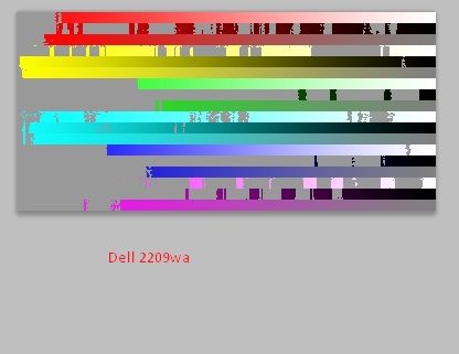

I made that with my Dell monitor and it looks like that.
I will redo it, as soon my MBA arrives.
