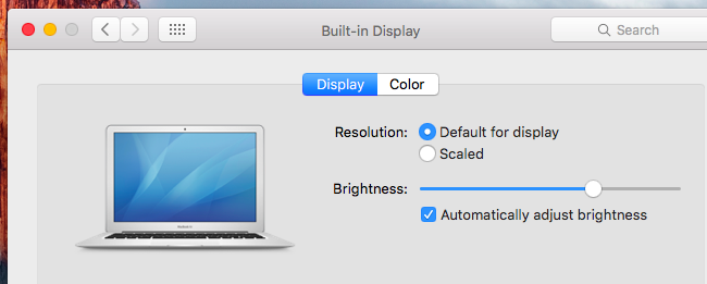

How to Automatically Adjust Brightness Based on Ambient Light
Macs with built-in ambient light sensors can monitor the light level nearby and automatically adjust the display’s brightness level to be suitable. This means making the display brighter when it’s bright near you, and making the screen dimmer when you’re in the dark.
To find this option, open the System Preferences window from the Apple menu and select “Displays.” Enable “Automatically adjust brightness” and your Mac will use the ambient light sensor to automatically adjust the brightness. Disable this option and your Mac won’t do this.
If you don’t see this option here at all, your Mac doesn’t have an ambient light sensor.
Despite the name, this option only applies to the ambient light sensor. Even if you disable the “Automatically adjust brightness” option, your Mac will still dim the display when you’re on battery power if you have the “Slightly dim the display while on battery power” option enabled.
Using the automatic brightness features won’t stop you from being able to adjust the brightness manually. If you ever don’t like the current brightness level, you can change it with a few keypresses. However, your Mac may automatically increase or decrease the brightness level if the lightning near you changes, and you may have to tweak it again.

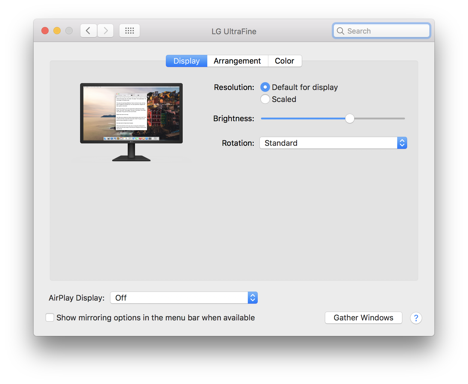

This option doesn't show for the LG UltraFine:
The brightness is adjustable using an external keyboard however.
It just doesn't seem to be adjusting automatically.

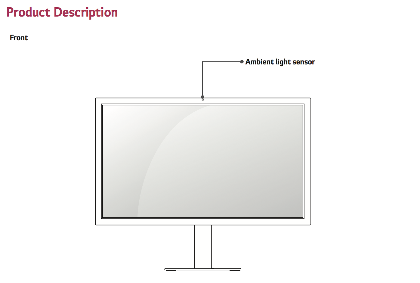

I've found the full manual online (it only comes with a quick start guide in the box), and it confirms the dot on the top is an ambient light sensor.

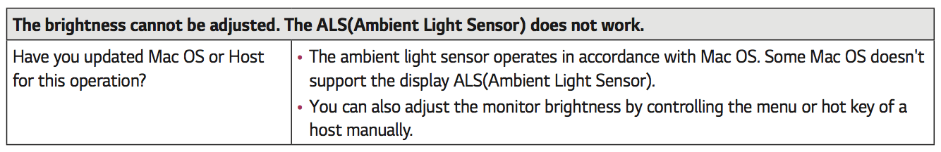

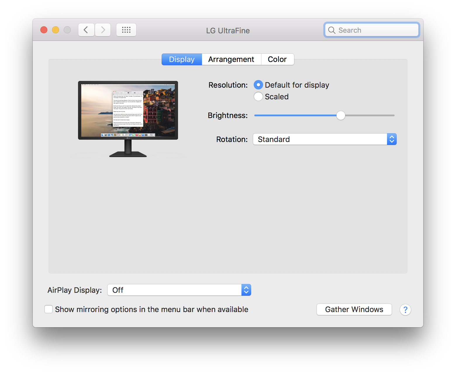

It also says:
Which implies the ALS is driven by macOS somehow. Perhaps the functionality will be added in the next point release?
