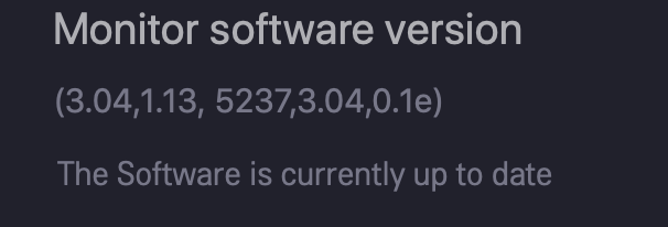

I Have not looked at this thread for a long time and my firmware says 3.04 firmware is that the up to date one.

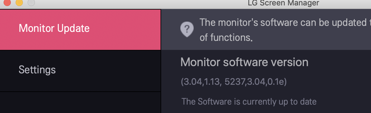

Maybe I'm misinterpreting the following:
3.06,1.13, 5237,3.04,0.1e
Is the first three digits not the firmware version?
now how to get the 3.06

Yes... that would appear to be the case.

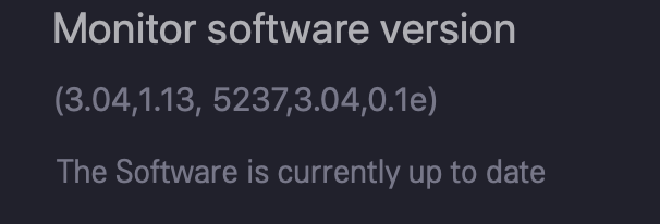

Here is mine on 3.04.
Edit: Ninja'd by @scott_donald 🙂
