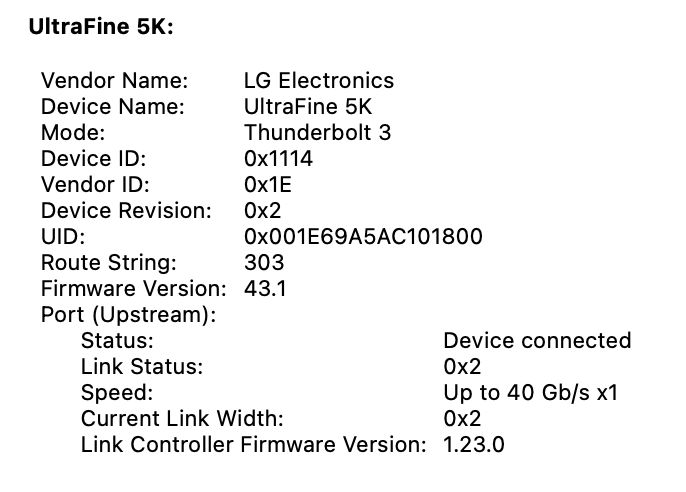

I've tried searching this thread to no avail. My 27MD5KLB-B Ultrafine 5K's speakers, camera and mic stopped working all of the sudden, after working fine yesterday and for years (monitor purchased in May 2020). In the past this occasionally happened but it would be fixed after a reboot or (at worst) an SMC reset, but neither has worked after several tries. None of the devices (camers, speakers, mic) show up in System Preferences, FaceTime, or other apps, but the display itself is working well. I've tried resetting the monitor via the LG screen manager but that does not seem to do anything. The LG screen manager does not tell me what firmware I have but the System Report shows the following:

I am using the TB 3 cable that came with the monitor but will try a new TB 4 cable at the suggestion of another forum member.
Any thoughts? I'm running a 2019 15" MBP with Big Sur 11.7.4

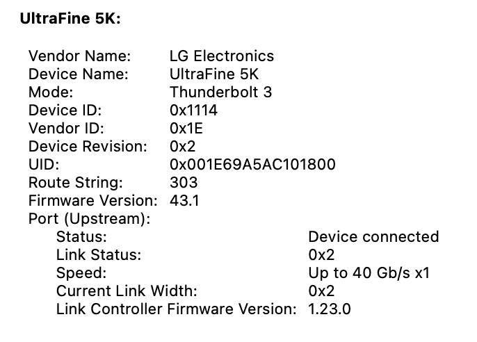

(there is a hard drive connected to one of the USB-C ports in back)
Do you have any other Thunderbolt or USB C devices you can plug the monitor into. Even if they cannot push the 5k it will display something at a lower res. Furthermore the version you have supports USB and Thunderbolt display which means it may be a device that may not have Thunderbolt. This may at least help you narrow things down.
Update - I plugged the Ultrafine 5K into a 2021 M1 MBP and (while a lovely picture) the camera, speakers, and mic still do not work and do not show up in System Settings/preferences. I also tried using a TB 4 cable (instead of the TB 3 cable the monitor came with) to connect both my 2019 MBP and the 2021 MBP and still no camera/mic/speaker. So, I'm suspecting there is a hardware problem with the monitor. Any thoughts appreciated...
