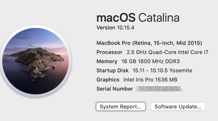

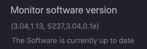

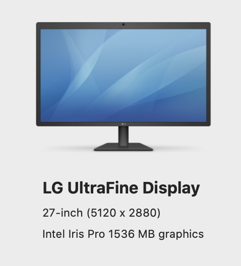

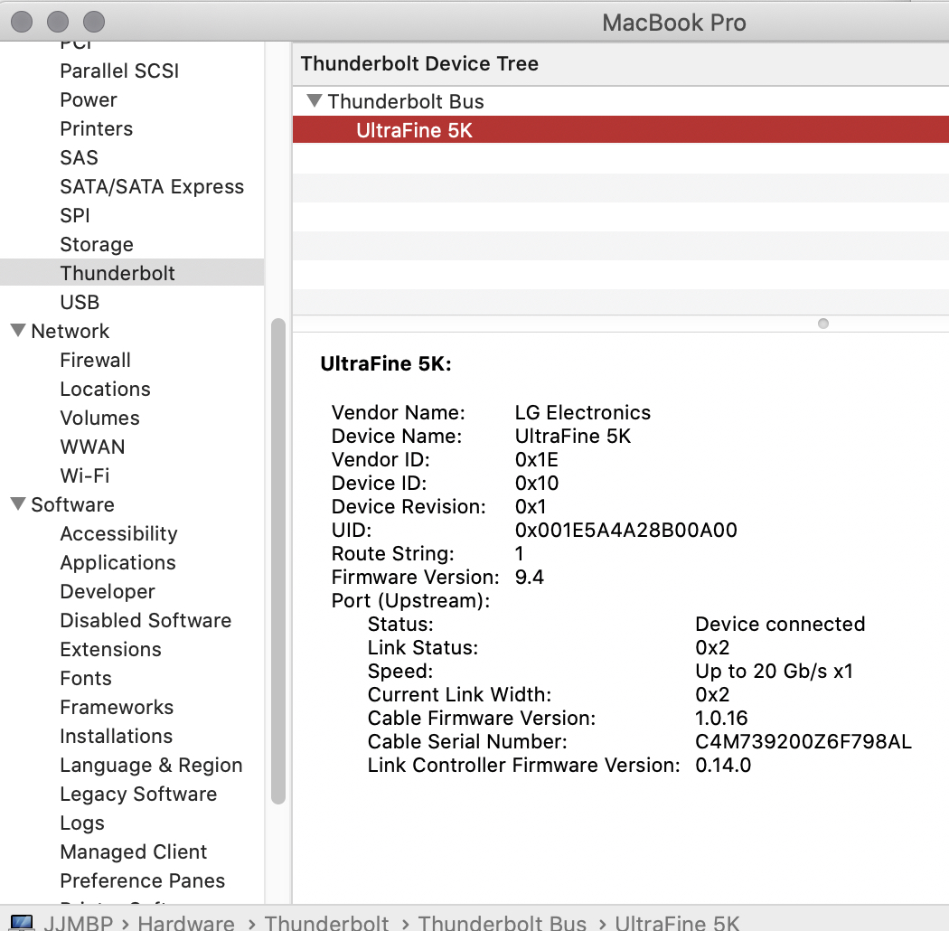

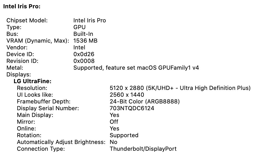

I am having the LG 5K Camera and LG 5K Speakers disconnect after about 30-45 mins of use, right in the middle of a zoom call. MacBook Pro 15, Late 2015, UltraFine 5k 1st Gen.
Routing/Cabling:
  • Apple ThunderBolt 2 Cable Male [into MacBook] to
  • Apple ThunderBolt 2 Cable Male into
  • Apple Adaptor - ThunderBolt 2 Female to
  • Apple ThunderBolt 3 Male into LG 5K.
Troubleshooting Thus Far
05/08/20 -- *** DELETING DUET DISPLAY *** - CURRENTLY TESTING A DELETION OF DUET DISPLAY
05/08/20 -- Update Firmware. Reset Monitor Settings.
Specs

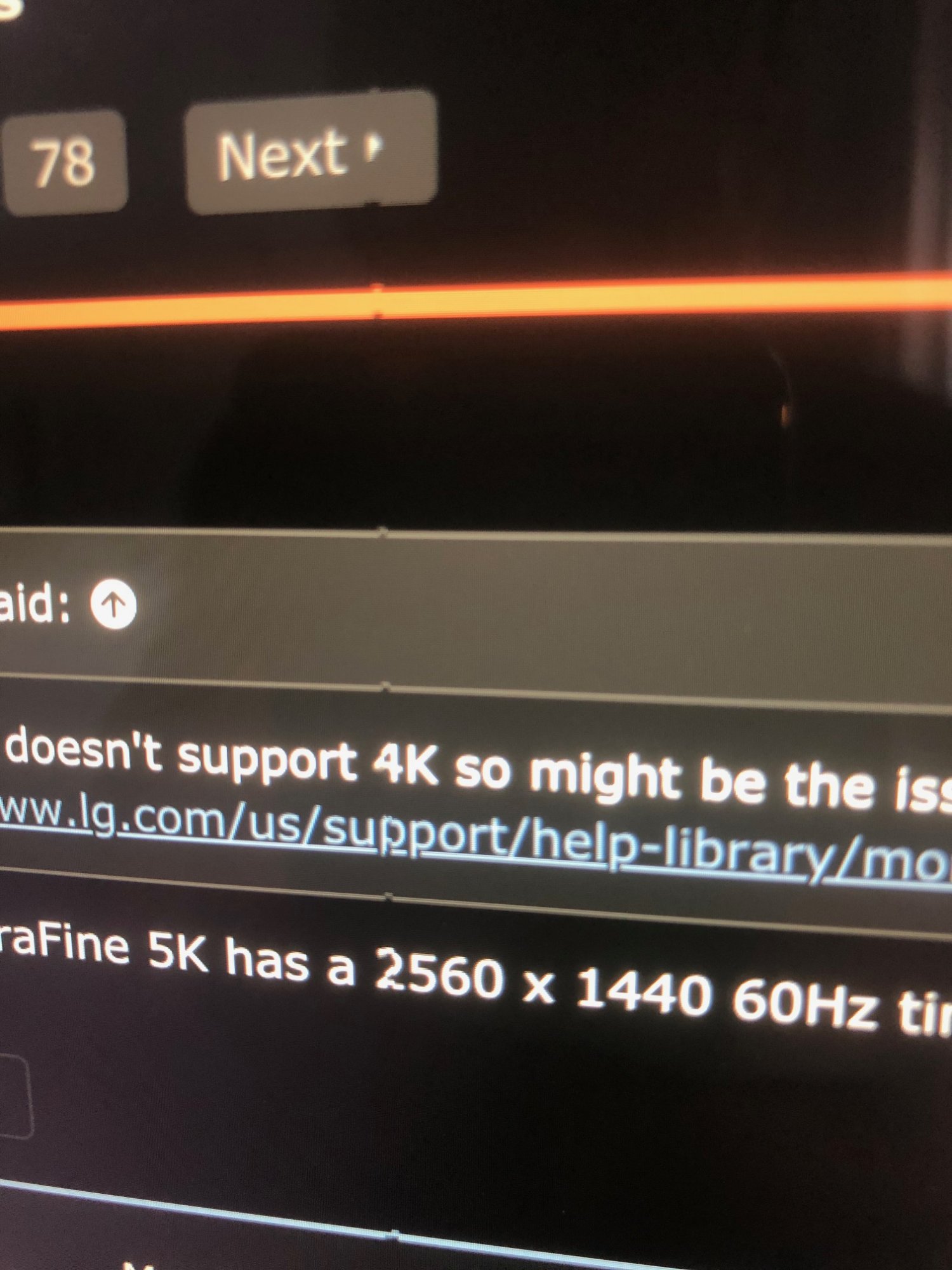

I just got the replacement unit and noticed a single line on the middle of the screen that's constantly flickering. The line is just below the webcam. It distorts any text that lands in the middle of the screen (see attached image where the '4' in '4K' is distorted).
Has anyone else experienced this issue? Is it an issue with the display itself or possible interference? I plugged out my Apple power adapter, Sonos and baby monitor that are all nearby, but didn't make any difference. I'm using the monitor with a new MacBook 16".

I don't really have anything of substance I can offer you except to say that I used to have odd issues all the time between my 2016 (and now 2018) MBP and my LG 5K. When I first got them, sometimes I would plug in, but get no video until I rebooted my machine. The laptop screen would be functioning fine, but the external display would not activate until after a reboot.
At other times, plugging into my external display caused my MBP to crash and it would become entirely unresponsive until I forced it to power down and restarted it.
These incidents would happen sporadically. It usually happened a few times a week and I'd plug/unplug a few times a day. I always figured it was a software but that would get worked out. It seems to have. This rarely happens anymore to me, but occasionally it will take several tries of unplugging and replugging before I get video on my LG 5K.
I have very similar issues with a MBP 16" and two of the monitors. I suspect one of the monitors is bad and when it shuts off and re-syncs it messes the other one, where they go on and off consistently. I suspect the monitors because I borrowed two identical ones, all purchased early in 2017), that my colleague has as he is temporarily not using his setup. Those two work perfectly (same cables). I am trying to send mine to LG for shielding, revision and repair, but it appears that LG will no longer repair these in the US directly and want to send me to a 3rd party repair outfit. I had not realized how horrendous LG's customer service is. Not sure if worth repairing them or just take the plunge and replace the pair with the Apple XDR. I wonder how the real estate of the Apple as a single monitor will compare to 2 of the 27" LGs. Any one has a recent (After May 2020) repair experience with LG?

I recently bought the second version and I sometimes get that, but the width of the column isn't always the same. It happens once a week or so. Disconnecting and reconnecting my MBP 16" fixes it, but it is kind of annoying, and a little troublesome.
Interesting. Is it near the midpoint of the screen? I have had the 2019 version for about 10 days now and haven’t noticed it. I wonder if it has something to do with the fact that it is taking two DisplayPort signals (one for each half of the screen). That may explain why disconnecting and reconnecting works.
