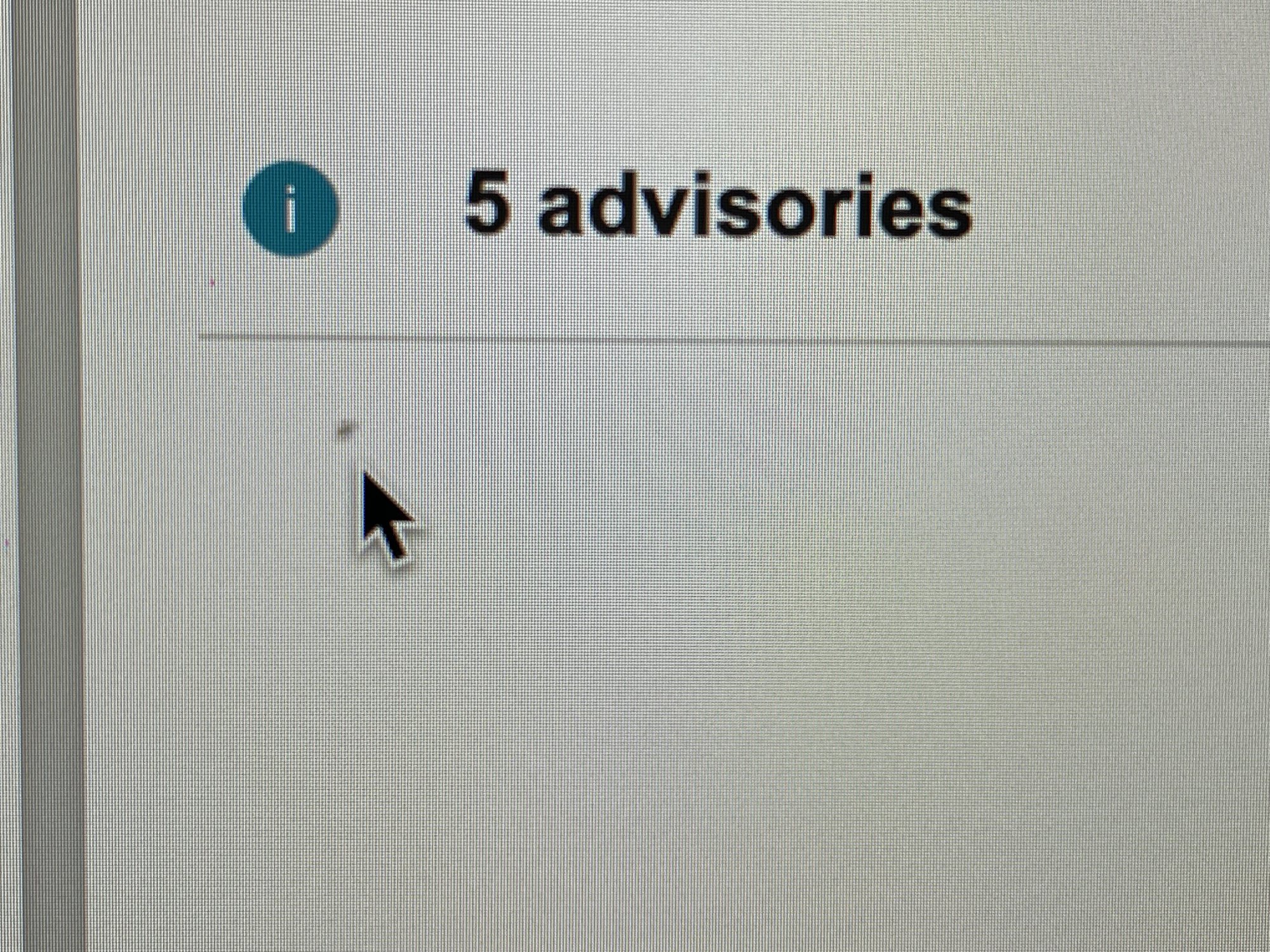

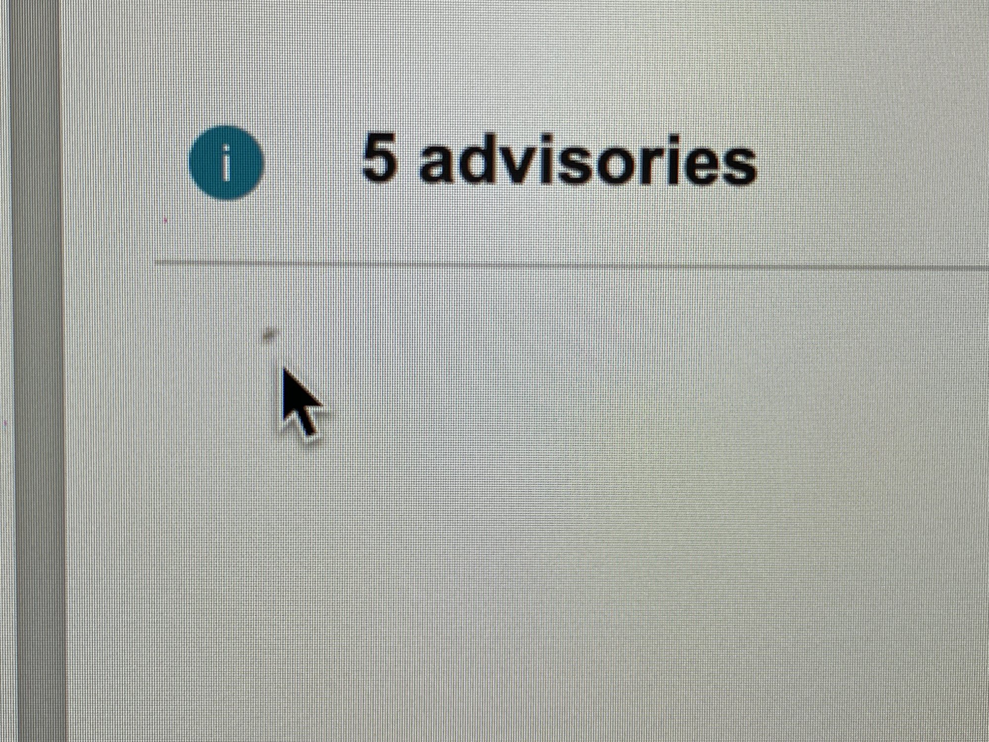

just discovered what appears to be a clump of dead pixels at about centerish height on the right side of the screen. Have already tried cleaning the surface to see if it was particles/stain but it appears to not be that. Some have suggested its possible dust but even if that were true how to do that at home

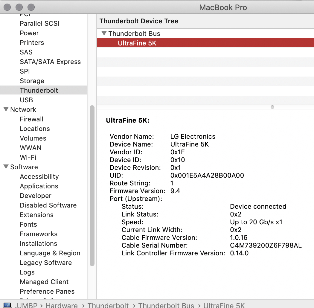

I have a 16" M1 MacBook Pro and an LG 5K Ultrafine monitor. Once in a while I notice that the LG is noticeably dimmer than I had set it to previously.
In this example I had the LG set to full brightness but it seemed more dim than expected. Going to the brightness slider and interacting with it causes the screen to actually go back to full brightness.
Has anyone else experienced this? Is there a way to check the firmware on an M1 Mac? LG Screen Manager doesn't work.
FWIW I get it quite often with a 2020 Intel MacMini, nearly every time the screen goes to sleep. But I've been assuming it's part of the MacMini external display infrastructure.
I have two external monitors - a HDMI connected LG Ultrawide and a TB3 connected LG 5k. I always figured this problem had something to do with the MacMini situation where only the HDMI display is the 'primary' display and the TB3 connected display doesn't register until you log in (only allowed via the HDMI display). I've been assuming that that disconnect is causing the TB3 display brightness settings to reset, but maybe it's something different.

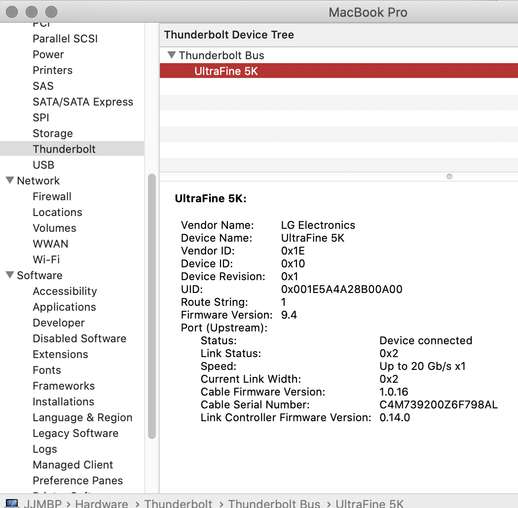

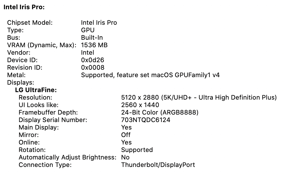

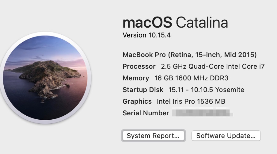

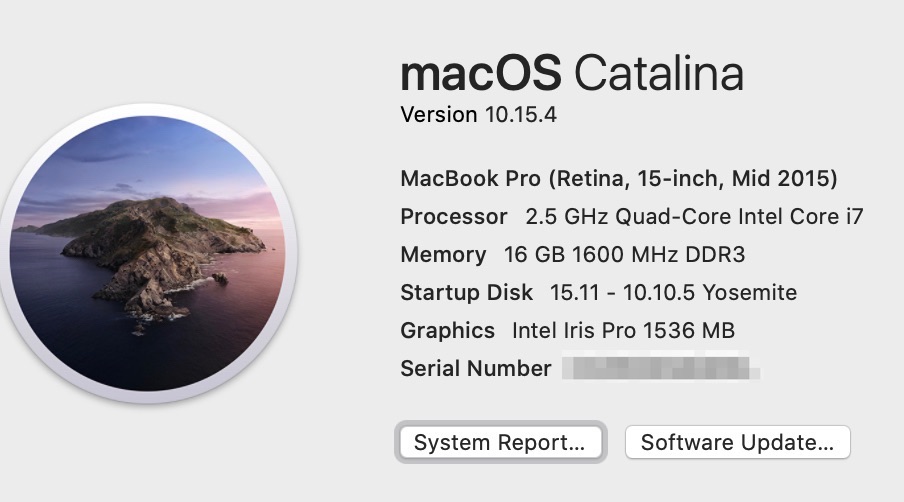

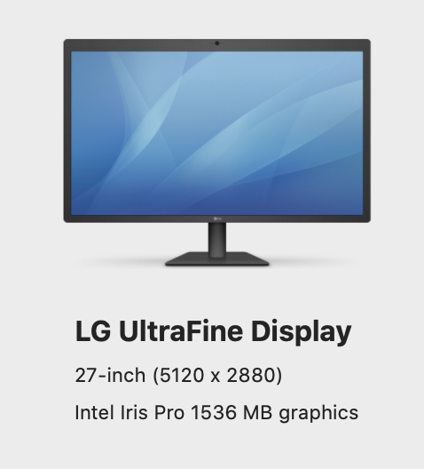

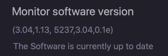

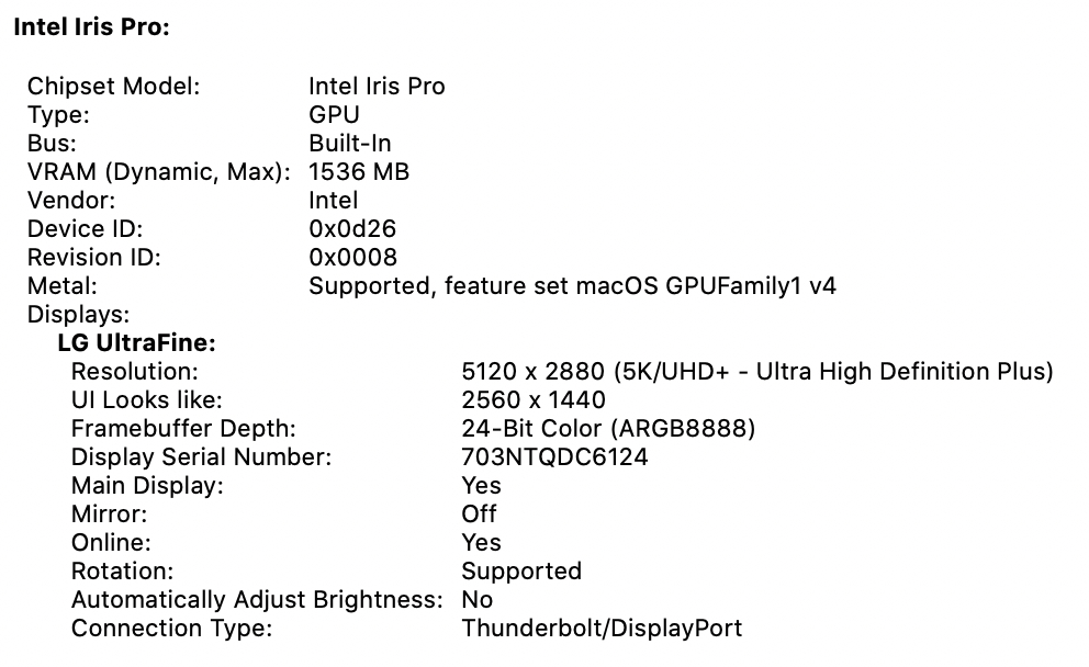

I am having the LG 5K Camera and LG 5K Speakers disconnect after about 30-45 mins of use, right in the middle of a zoom call. MacBook Pro 15, Late 2015, UltraFine 5k 1st Gen.
Routing/Cabling:
  • Apple ThunderBolt 2 Cable Male [into MacBook] to
  • Apple ThunderBolt 2 Cable Male into
  • Apple Adaptor - ThunderBolt 2 Female to
  • Apple ThunderBolt 3 Male into LG 5K.
Troubleshooting Thus Far
05/08/20 -- *** DELETING DUET DISPLAY *** - CURRENTLY TESTING A DELETION OF DUET DISPLAY
05/08/20 -- Update Firmware. Reset Monitor Settings.
Specs
View attachment 913282View attachment 913281
View attachment 913284View attachment 913283
@jarrodjob @smario31 Any luck I'm having the same issue connected to my iMac 27, tried all the various resets, etc. Tried switching ports. Will try swapping the TB3 cable next. Video is fine, just the USB devices - Integrated camera, speakers, anything plugged into the USB ports.
Update 11/2/21
USB devices have been stable for almost 24 hours now, I powered everything down and did a NVRAM Reset.

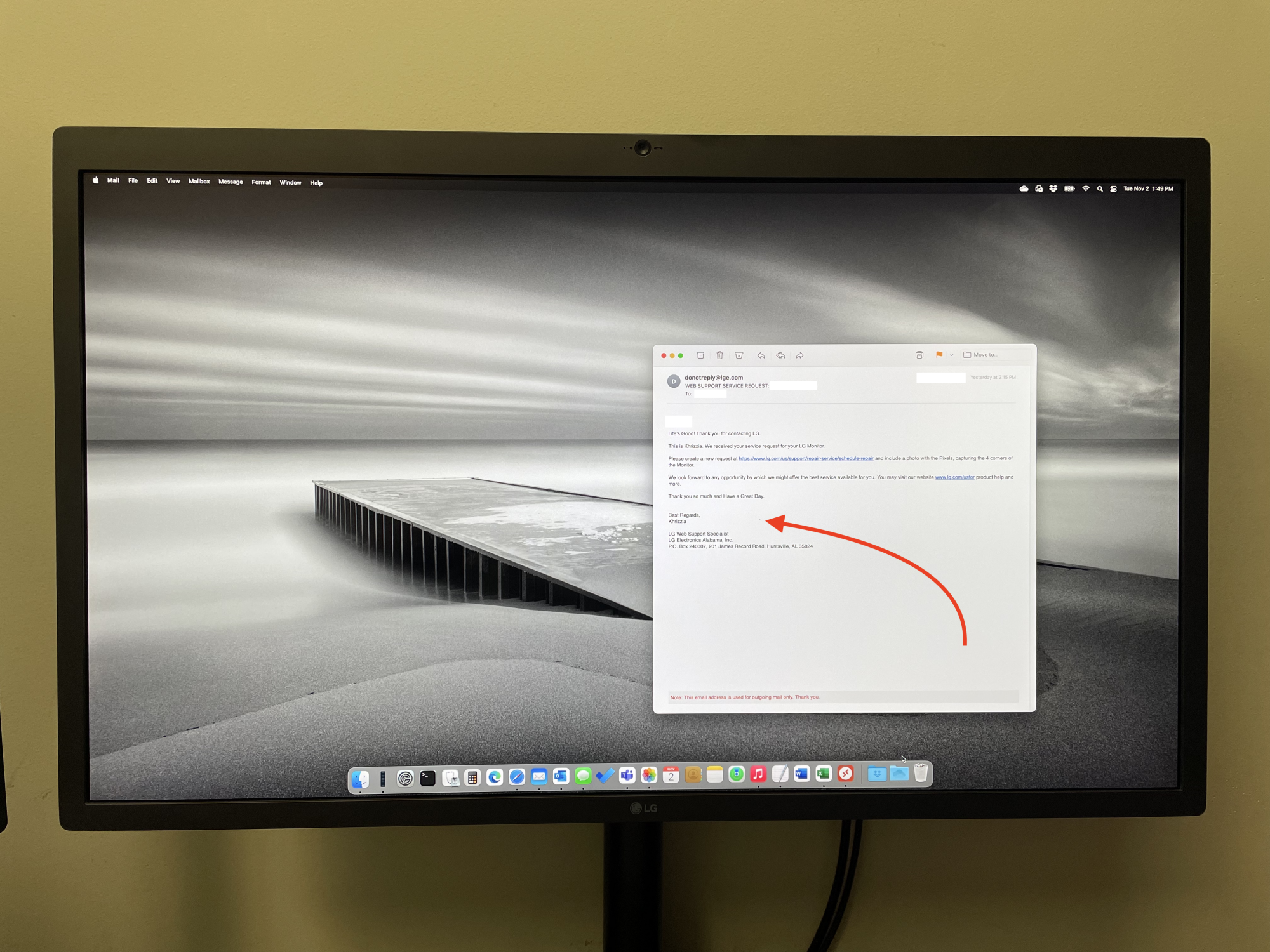

I discovered the same thing with my 5k Ultrafine. I have opened tickets with LG but I have no way to contact them again after they contact me. I get an email from a donotreply address but there is no way to log in to my ticket to reply or make edits or submit more info. It is so frustrating. To add insult to injury, they suggested that this is physical damage and not covered by the warranty despite the fact that it just came out of the box and had this smudge under the screen.
Yes - exactly same behaviour with a MBP 16" M1 MAX. I have an Apple XDR (no dimming issue) and a LG 5K UltraFine (dims every time it goes to sleep). The LG 5 is connected via a CalDigit TS3 dock.
Where is yours located. Thats like practically the same size and shape that mine is
