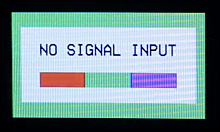

To be honest, a good display like this shouldn't have an off switch. While most displays go into some awful 'no signal' mode when the host machine powers off...
[I mean, what engineer ever thought that was useful to anyone?!]
...these LG screens are intelligent enough to just turn off.
Similarly, when an input signal returns, they turn on.
(The UltraFines also have other features that would be somewhat incompatible with a 'proper' off button: the USB-C ports on the rear are constantly powered at 7.5W per port whether or not a host is connected, making it very useful for recharging devices.)
