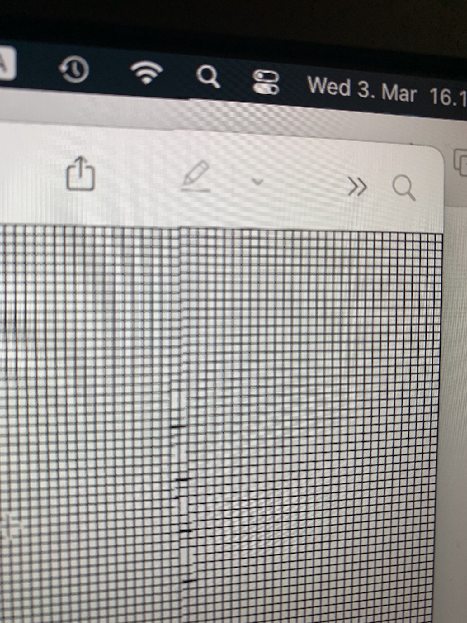

Has anyone purchased an LG 5K recently (from the 12/2020 manufacturing batch) and experienced a weird vertical banding / "tiger stripes" issue? It's hard to notice if directly looking at the screen, but the moment you shift your head around, you'll notice these wavy bands/stripes.
It's hard to capture, but it's pretty much the issue raised by @ralphthemagi in 2019. I've gone through two units already and they both exhibit this issue. If you use dead-pixel-check, it's most pronounced in the red and green colors. Any feedback would be appreciated!

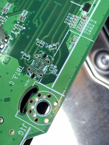

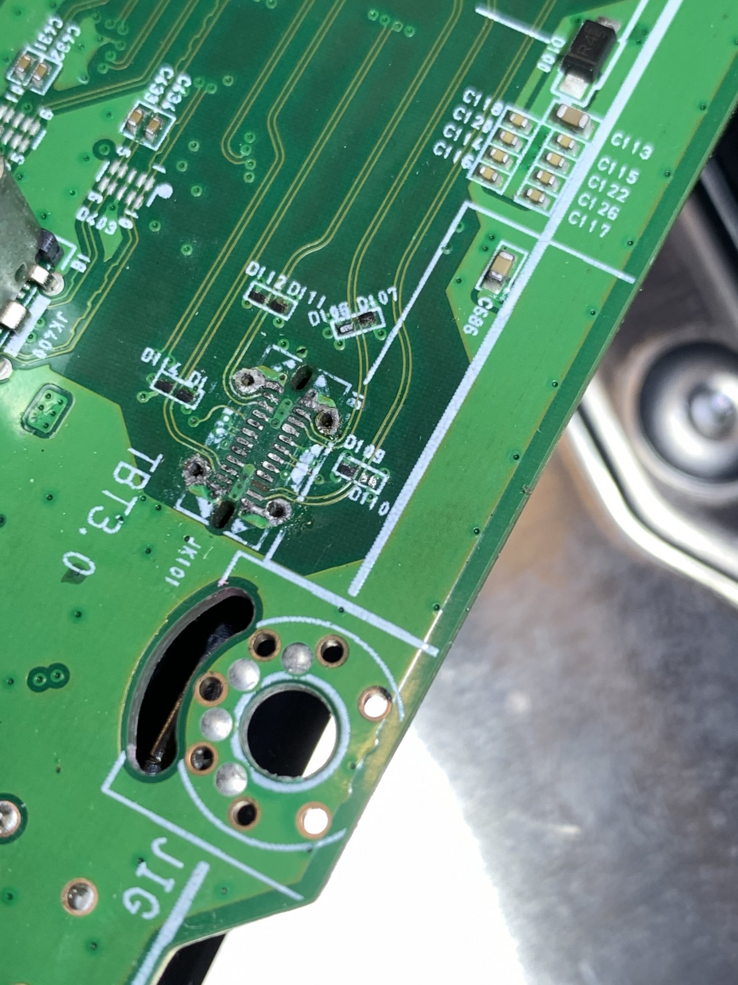

Trying to repair a 27MD5KA (broken thunderbolt connector), and I’ve noticed a couple diodes missing or damaged (D109 and D110 around the thunderbolt connector.
Does anyone know what parts I should replace them with? I’m guessing they are for ESD protection.
I don’t have schematics so any help would be much appreciated.
Thanks!
I have an LG 5K from the 12/2020 batch. I don't notice this issue with the dead-pixel-check, but maybe it is subjective and my eyes are too dumb to notice this effect. 🙈 I do notice some backlight bleeding, but still in the adequate range for an LCD as far as I can tell.
Still very satisfied with this display after two weeks coming from a 1440p Dell monitor.
Thank you for chiming in @chrizel! Glad that you got a solid display. I've seen a number of these LG 5Ks and they do have backlight bleeding as you say, but I agree that it's within an acceptable range. I'm not picky about those things, but if there's something truly defective, I'm going to call it out, especially for a $1,300 monitor!
I love the LG 5K truth be told -- there's just no monitor like it if you're a Mac user. I just wish LG's quality control was better. Clearly the panels getting sent to Apple for iMacs have more stringent QC standards.

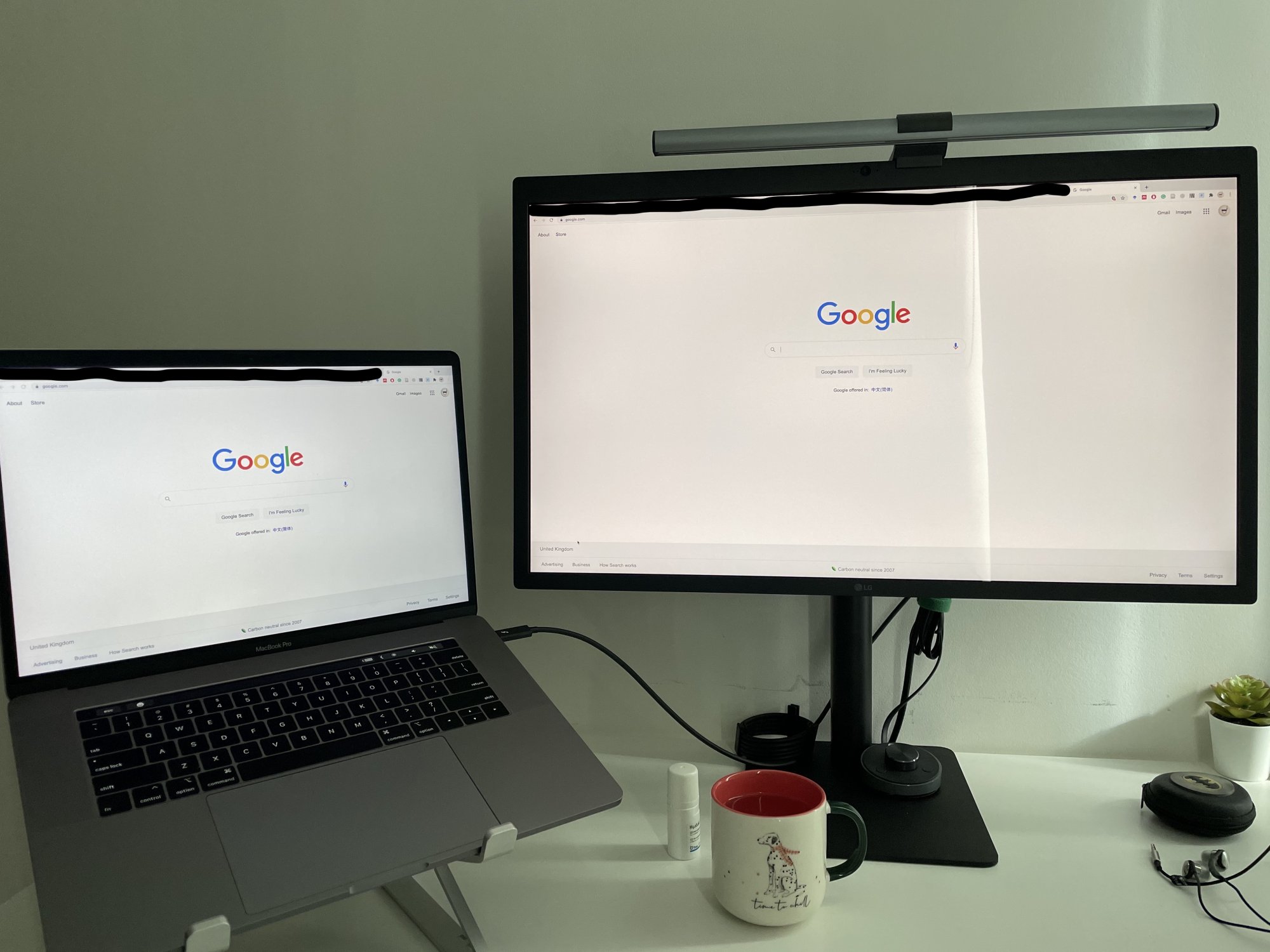

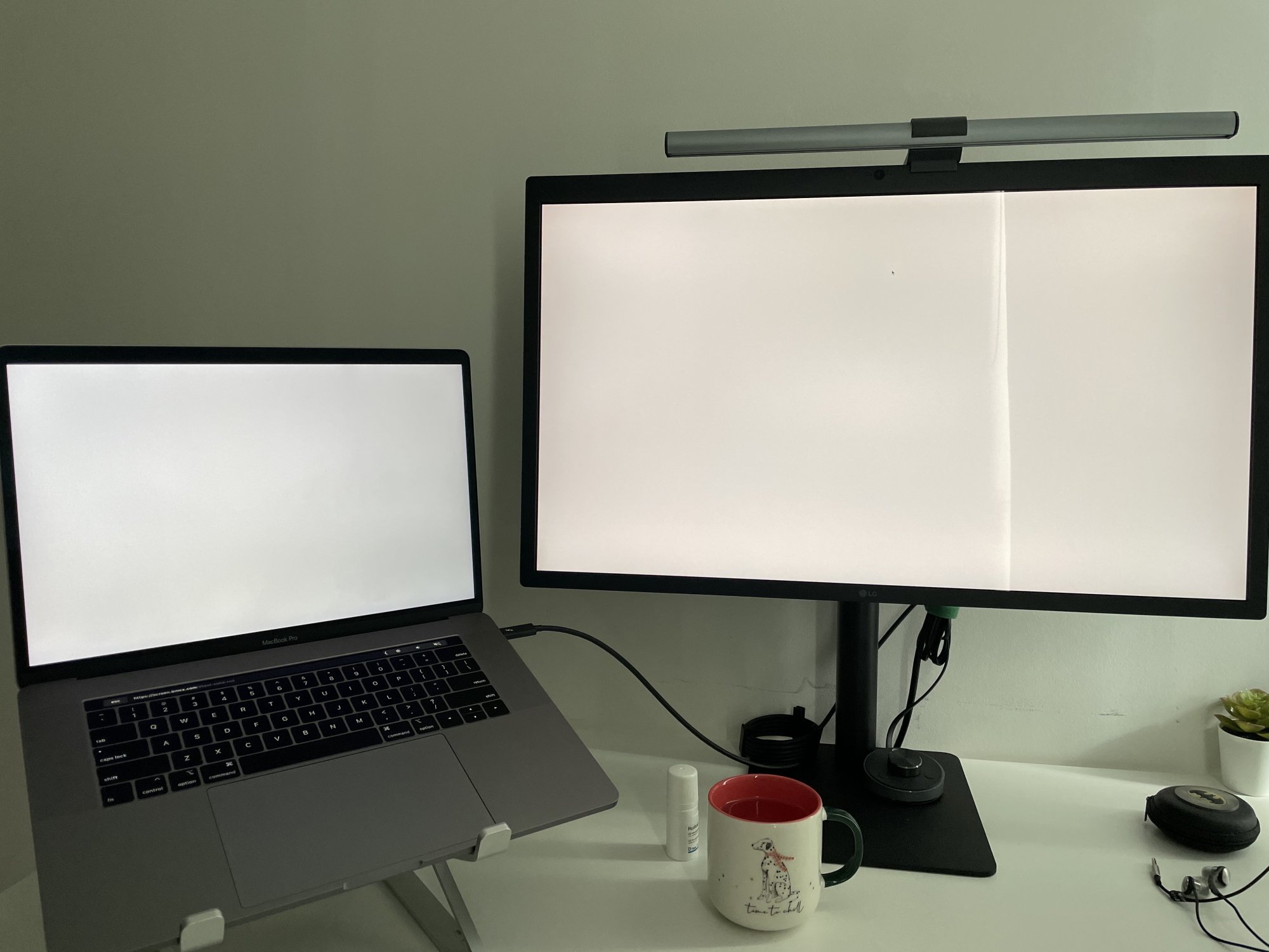

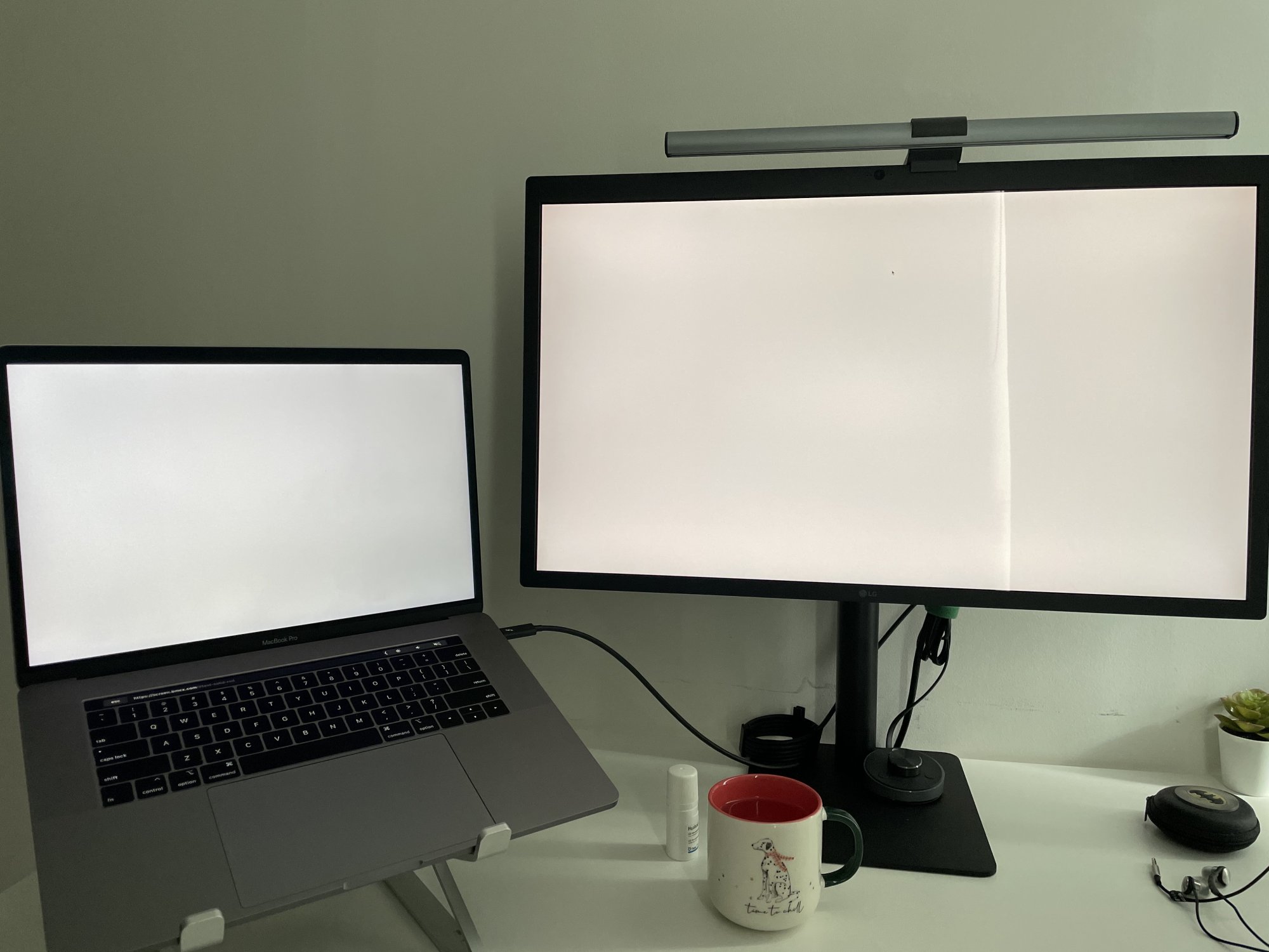

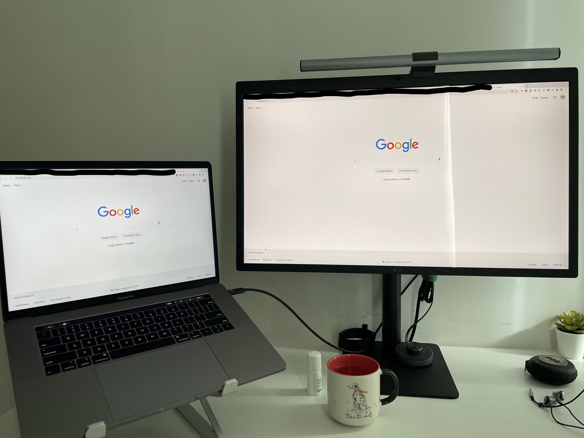

Hi All,
I purchased a refurbished LG ultrafine 5k (27MD5KL) recently manufactured in Nov 2020. As normally observed in other posts, it has uniformity issues, which I can accept to some extent since no better choice in the market meeting the same standard HiDPI as MBP. The thing that I can't stand is it shows a warmer or pink tone, which is rather obvious when viewing sites with a white background. Does anyone know if it is possible to resolve the colour hue issues with colour calibration (recommended tools?), or it is actually a defective unit that I have to request for a swap?
Thanks!

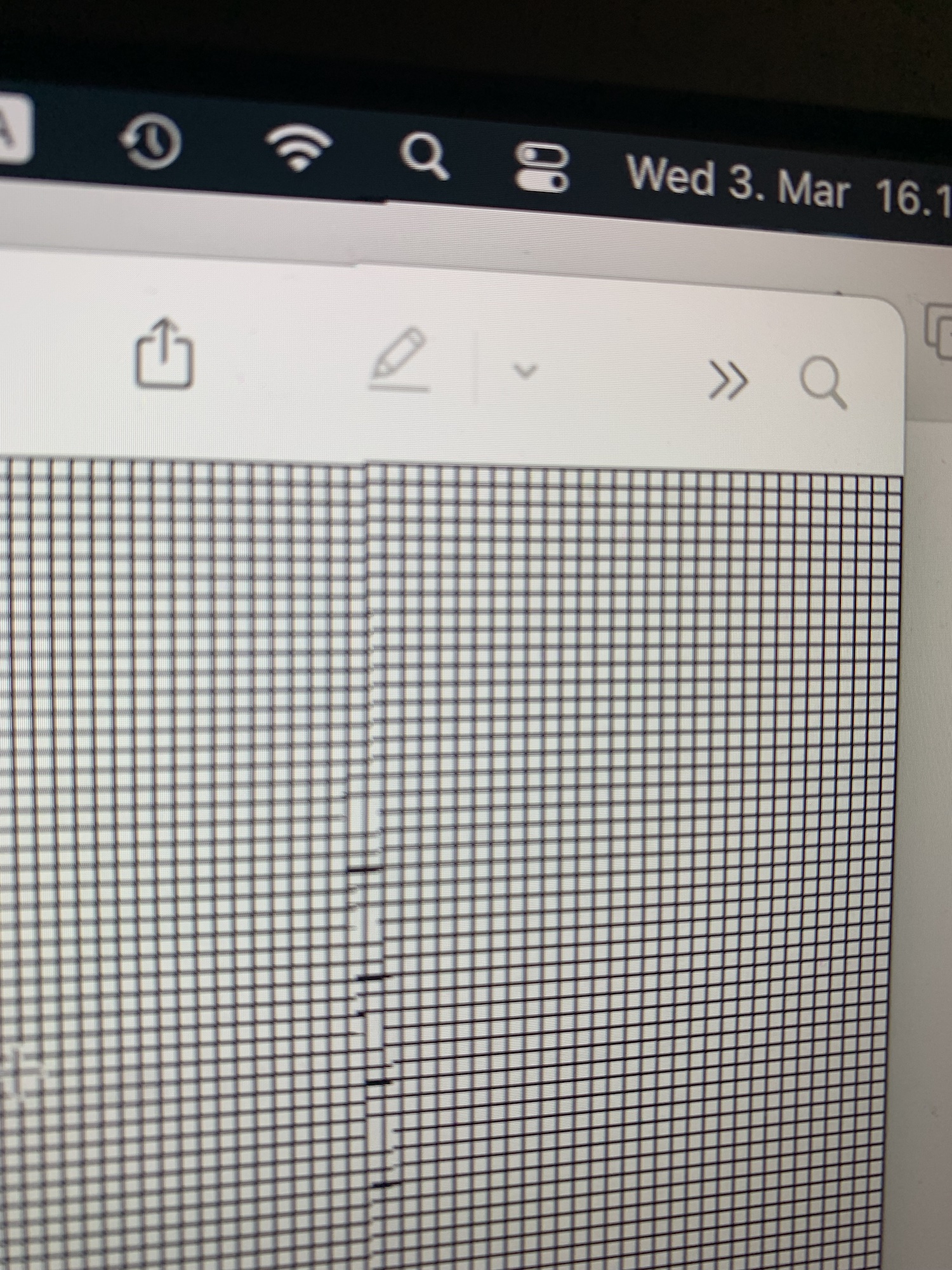

A bit of a warning:
After updating my M1 Mac mini to the developer beta of macOS 11.3 Beta (20E5196f), my UltraFine 5k developed a strange issue (pic related).
Some of the pixels near the right edge of the display are going in and out of alignment in a vertical band, maybe 50 pixels wide. I doubt this is the same pixel alignment issue that has been discussed here, as that was about static alignment issue and on my display the misalignment is constantly moving like this.
It's definitely a software issue though — the same display with the same cable works just fine on another Mac with a stable version of macOS 11.2.

Hi All,
Thanks!

I use the X-Rite i1Display Studio. I like their software too.
Are you observing the difference or improvements after calibration? I'm currently planning to give the X-rite i1 display studio a try.
It made a noticeable difference for me. I calibrate all of my computer monitors, including laptop screen. There is a before/after in the software.
Choose the D65 option, 2.2 gamma, and your brightness should be about 120 cd/m2.

Did you follow the same steps to calibrate the laptop and your monitors or merely get the statics of the mac's built-in display and calibrate other monitors based on that? I'm asking cause I want to know how to enable consistent visual quality across different screens.
I def have the same issue, always assumed it was just a color calibration/screen difference that I would have to live with. I've tried to make a LG5k and LG 34" Ultrawide the same color for a couple years and never found an easy way to do it. Am interested in any advice anyone can provide. Will look at X-Rite i1Display Studio. Thx!

Same settings for any computer display.
6500K color temperature, 2.2 gamma, 120 cd/m2 is the most common standard.

Which correction file (suppose you use displayCAL for calibration) do you select? Thankfully, I got my x-rite i1display pro plus today and have calibrated both of my MacBook pro 15 as well as ultrafine 5k. The overall colour tone of the two panels looks somewhat close but the colour is a bit washed out or the colour being less saturated.

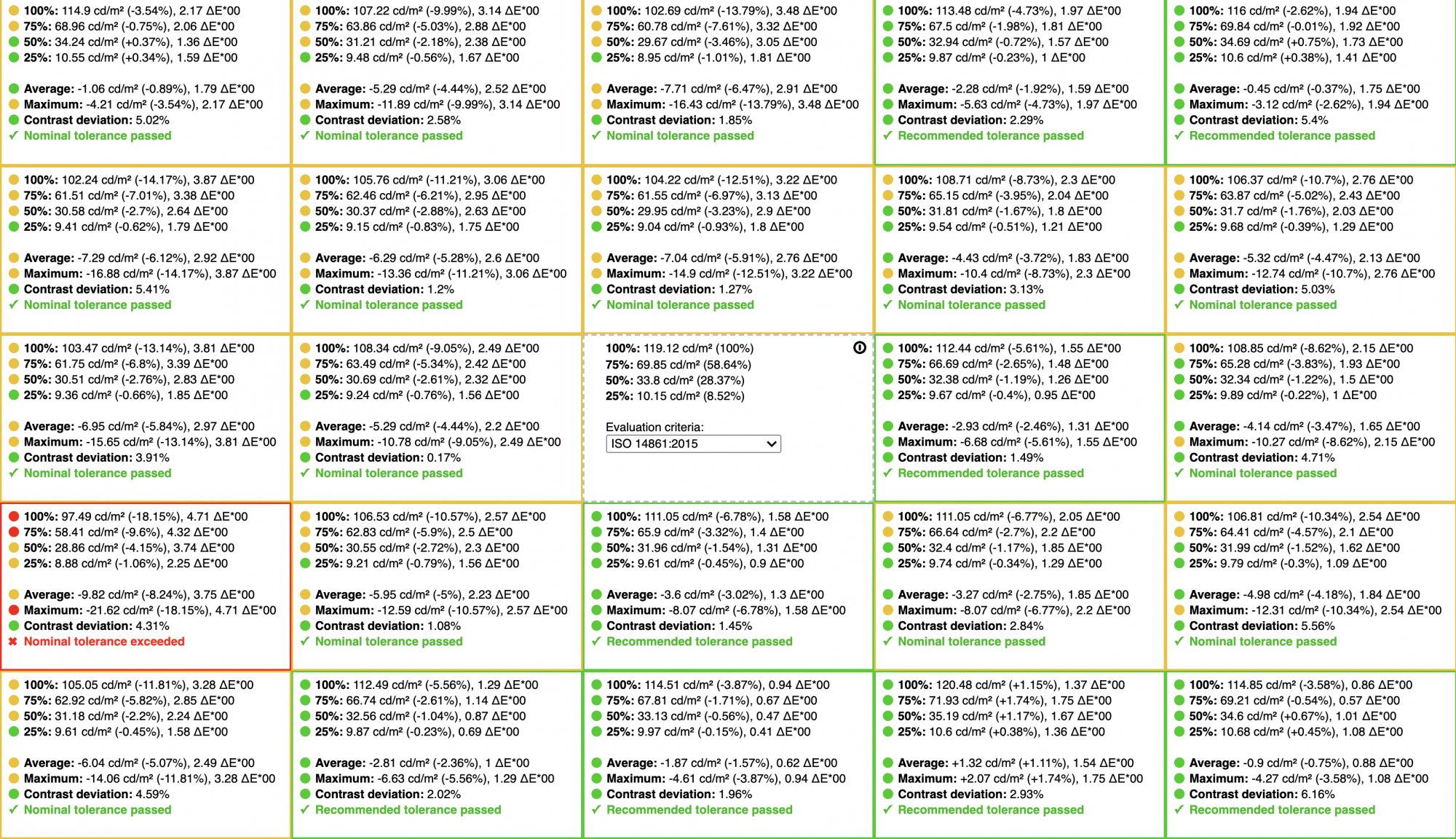

Here is the uniformity test of my ultrafine 5k. Could you please let me know about yours?
Appreciate anyone's advice: is this monitor acceptable or a defective unit (one area of the panel does not meet nominal tolerance) that I have to return/swap.
Thanks!
Following up here: I exchanged my LG 5K for a unit from the February 2021 manufacturing batch and it does not exhibit this issue. If you bring home one of these and it has the problem I originally described, do not accept that "it's just the way it is". It is absolutely a QC issue from the factory with certain batches. All this said, love this monitor. Nothing as sharp as this monitor on the market right now.
