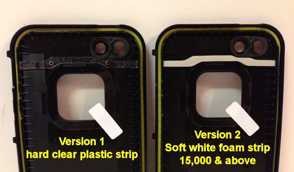

I got both the 1st and 2nd generation frè cases.
The 2nd generation has foam on the back which creates proximity issues which creates buzzing while on calls.
The 1st generation gets clacking when on speaker caused from the clear part from the back panel (which I suspect they tried to fix on the 2nd gen by putting foam, but I think the foam pushes the front panel too close to the proximity sensor). This can be solved by putting a small piece of paper on lower portion of the back panel.
I do like this case, just thought people should know what to do if they wanted to fix this problem on the 1st gens.
How do you know if it's 1st. or 2nd. gen?
The first gen has plastic strip on the top of the back case. The 2nd gen has foam on the back case.
I think the first gen can be fixed with a small paper on the back to fix the clacking during speaker.
2nd gen has the proximity buzzing during a call which I have no idea how to fix.
Buzzing on both revisions is from the back case. The proximity sensor's problem is a problem with spacing or clarity of the lens used.
I didn't get any proximity buzzing on the first gen. I think it's because the foam pushes the sensor too close to the front case on the 2nd gen.

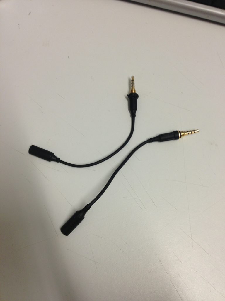

My headphone adapter was broken. It would not screw all the way in or unscrew. The threaded part was loose inside the outer plastic casing.

So here's my issue... My music will only play in speakerphone with this headset adapter. So I must've had the version one before and I did the water test, and got condensation. So I took it back to best buy and got a version 2. I noticed differences like the earpiece portion east padded grey like my first one.
But back to my issue, I kept the version one edition of the headphone adapter and the adapter from my 4s version an NEITHER play music. What do I do?
When they are plugged in does the iPhone detect its plugged in (as in sound is not played back through the internal speakers by default)? If the iphone does not detect the plugged in jacks, it's probably the same issue I had where the adapter does not allow it to be screwed in all the way. If it does detect the jack is plugged in then the adapters are bad.
Mine is a similar issue, but I don't think it has to do with the adapter just the iOS. Everytime I unplug it, I think the iPhone thinks there's still something plugged in so there's no music or anything coming out of the speakerphone (yes, I checked the silent switch is off).
My suggestion is to call lifeproof or e-mail them if you can get in touch with them and tell them what your issue is.

OK, got the 3rd generation of the Lifeproof case today and I'll post a picture showing the 3rd generation later tonight.
Here is the picture I did of version 1 & 2 a while ago and I'll get the 3rd version up here later.
