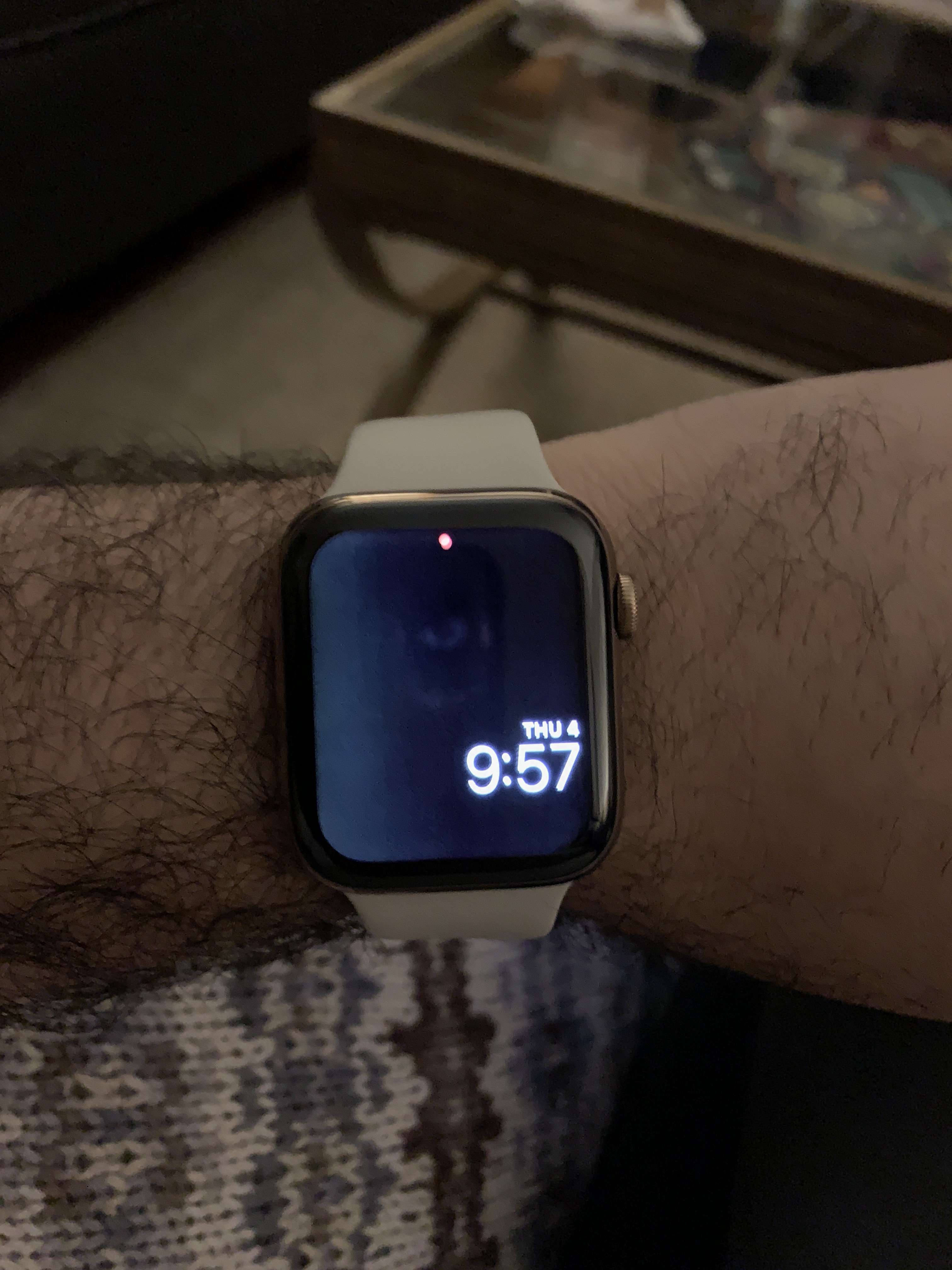

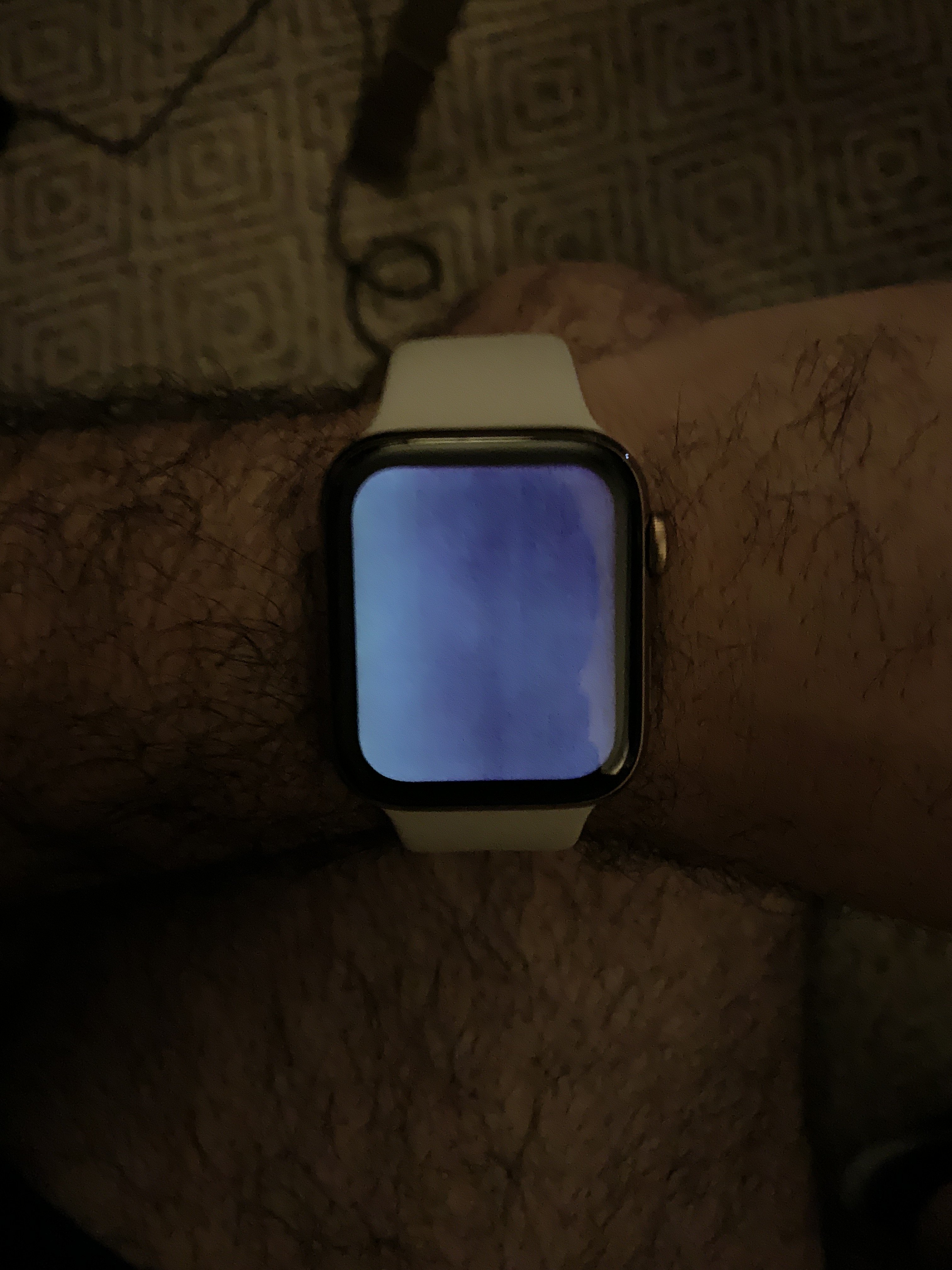

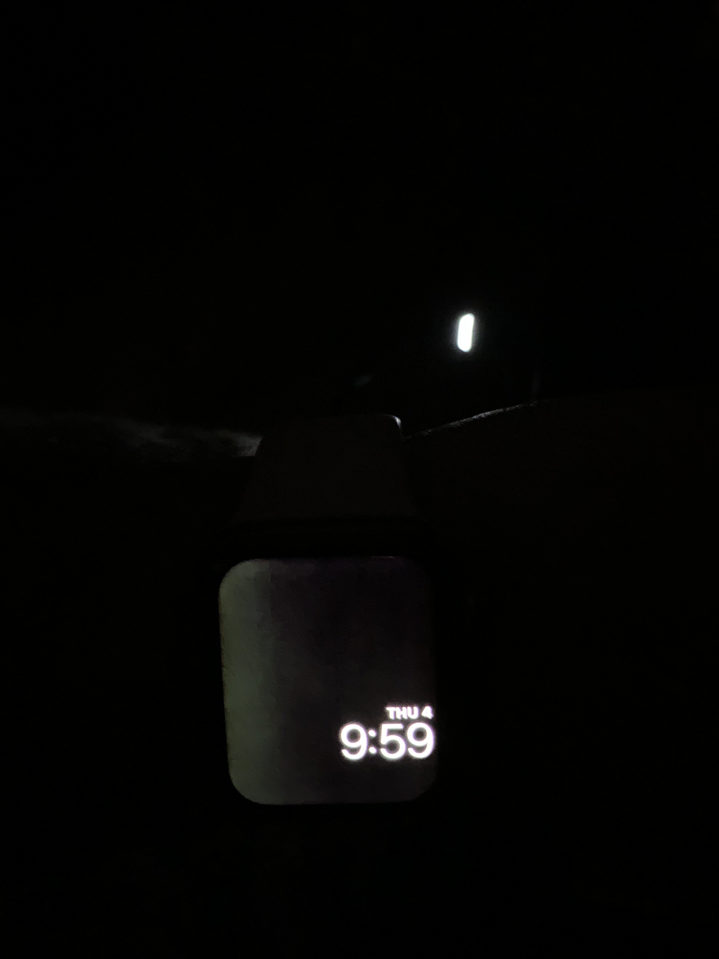

Just got my SS 44mm Gold watch. Pretty miffed I’m going to have to send it in to get replaced or repaired. Am I losing my mind here? This seems pretty bad.
That seems amazingly unlikely. It's like the OLED pixels are not actually switched off (as they should be on a black background).

Looks like the glue didn't adhere, or something of that effect to me. The look is eerily similar to backlight bleed, but of course isn't.

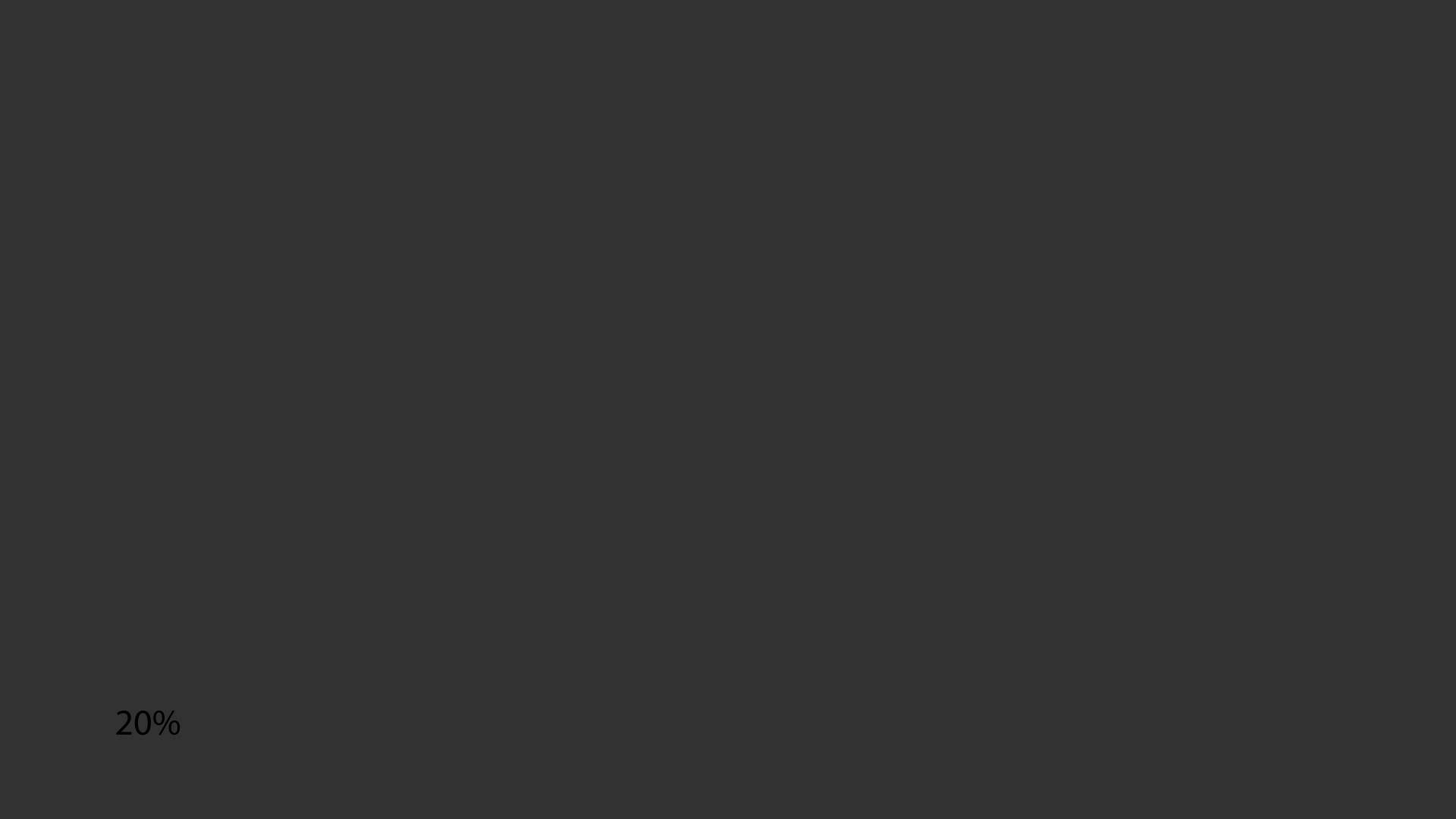

This was posted on reddit. You have to use the all gray image as OLED shuts off if you use black. This is an issue for some people. Check your watches and send them back. It should look uniform using the gray image sample.

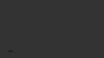

Try these steps to check for uniformity:
1 place the attached picture in your photos so you can view on your watch
2 Place the watch in theater mode
3 open photos app on the watch and make the grey pic full screen.
4 go into a completely or very dark room (this is a must) and turn the crown one notch until you can barely see the grey image
5 check for uniformity. Mine is a little brighter on the left side. I'm not going to worry about it as I don't use the watch in this way but it is there.

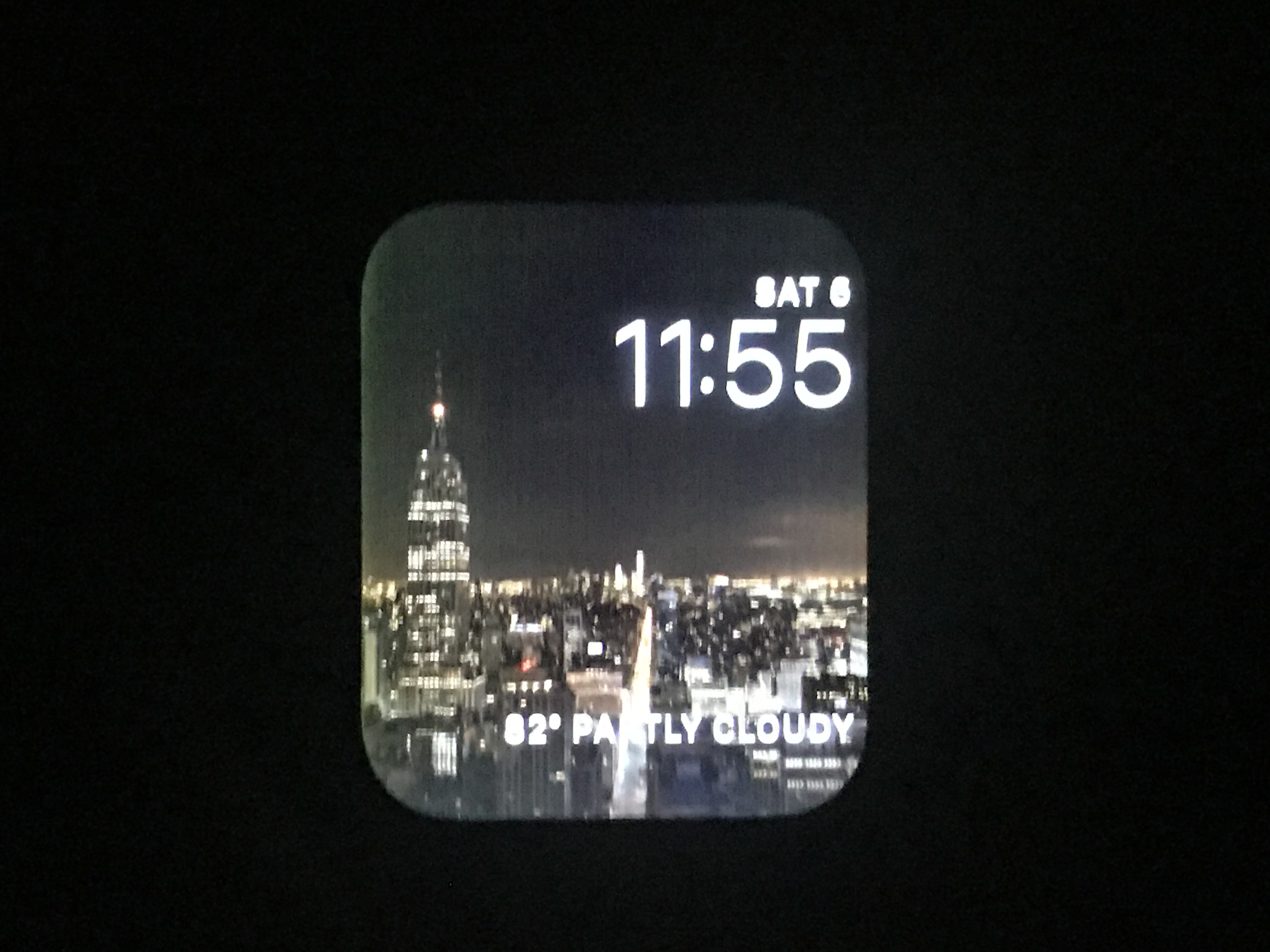

Here’s a pic showing some “bleeding” from the left edge. I know with oled there shouldn’t be any of that but there is definitely some kind of screen distortion. The night view from the Paris and New York timelapse watch face show it more. I opened up a case with Apple and they’re sending me a replacement unit
