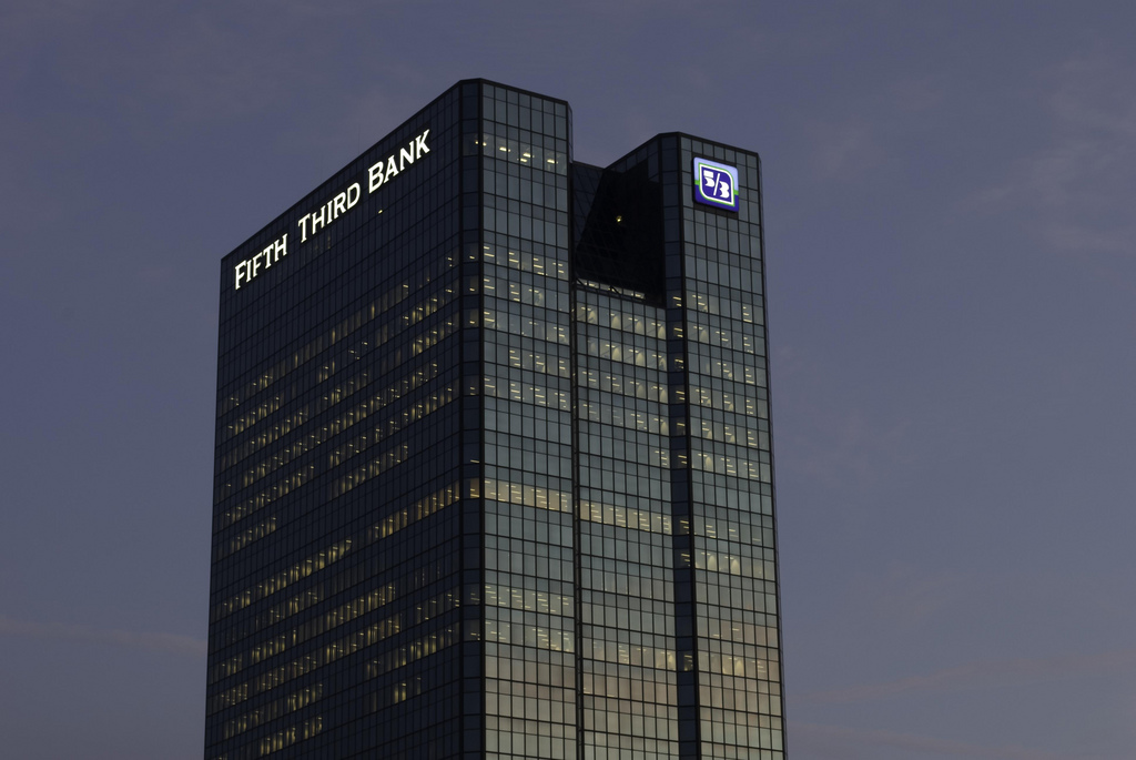

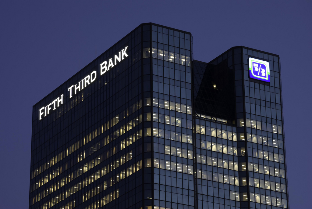

Here are a couple sample pictures guys. I think the problem is just simply over exposure. Notice the light blue on the 5/3rd sign. That goes away in the over exposed pic. The exposure is about 1 sec. vs. 4 seconds - both at f/11. And yes - I've been using a tripod and a remote shutter. All good advice I've been hearing - keep it coming.
