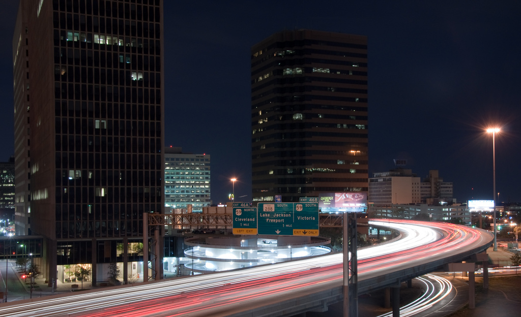

Isn't the issue the longer exposure time at night though? I didn't think anything you metered off would make a difference? Like in this shot:
The color in the freeway signs is washed out due to the long exposure, could that be improved simply by metering off the signs themselves?
No. Not unless you want a much shorter exposure with very dark buildings and much shorter car streaks.
Probably the best way to do this is expose it like you just did and then either select the signs in PS (with largish feather) and lower the exposure for only them or do essentially the same thing with a tool like Viveza - or even the exposure painting in the new version of ACR.
